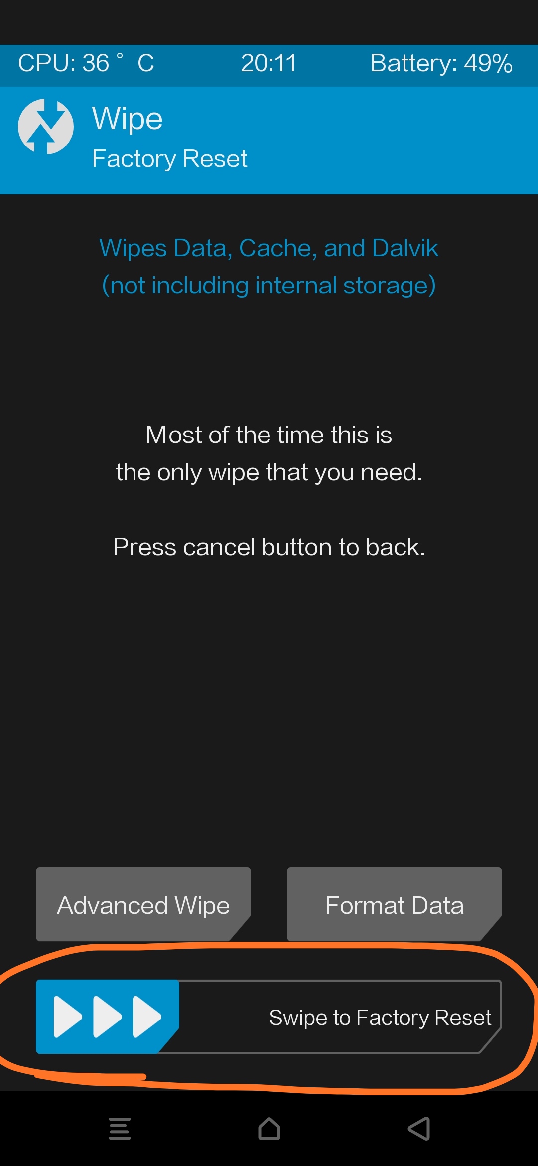

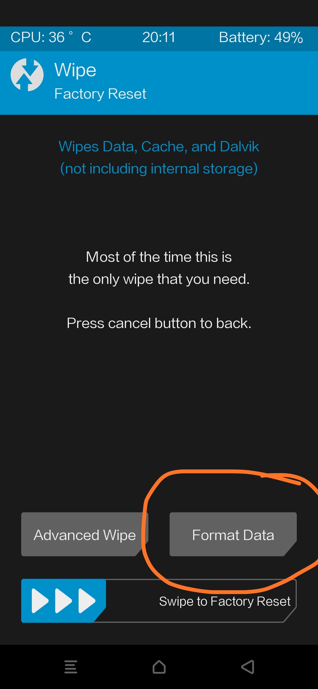

lthe only solution that I have found is to have a pendrive install the ROM. have an OTG / usb type c adapter. then perform, Format data
28109
And after that install the ROM through the OTG. When finished installing, I perform a Swipe to factory reset.
28110
That was my solution. This deletes everything from the phone. Be cautious with this. If you have not done it never, look for information, I am not responsible for what happens. I hope it helps you.If so, let me know. regards
