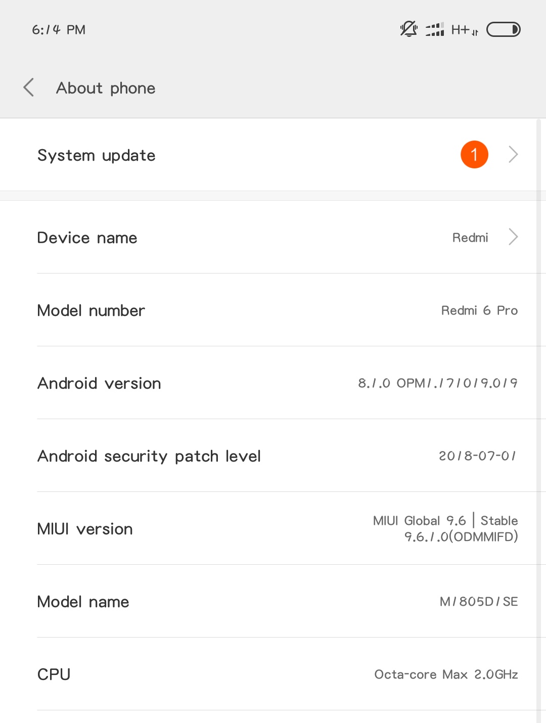

I also have the redmine 6 pro I helped me with the hard brick I wanted to load the rum on it
yo tengo version distinta mira imagen.
rom utilizada globeROM_v10_sakura_8.8.23_cfg-fsnrksudmclegw . zip
poner con twpr.
tarda mas de 10 minutos en colocarse PACIENCIA.
poner con twpr.
Con tu versión no hay problema de brick, el problema es desde la 9.6.16.0 en adelante . Y yo tengo la 9.6.17.0.

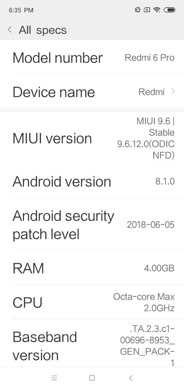

Dear all,
I recently bought a Xiaomi Redmi 6 Pro in China. As a matter of fact I bought two, the basic version (32 GB + 3GB RAM) and the upgraded version (64 GB + 4GB RAM). It comes with the default chinese ROM and with MIUI V.9.6.12. I'm interested in upgrading to the Global ROM or the XIAOMI.EU rom. I need to have also spanish as a language and be able to install Google PlayStore.
Is there any ROM available for this purpose? What are the steps I should follow to install?
Most probably someone already asked this question before but I did not manage to find it.
Looking forward to all friendly replies. Appreciate your help. Regards!
