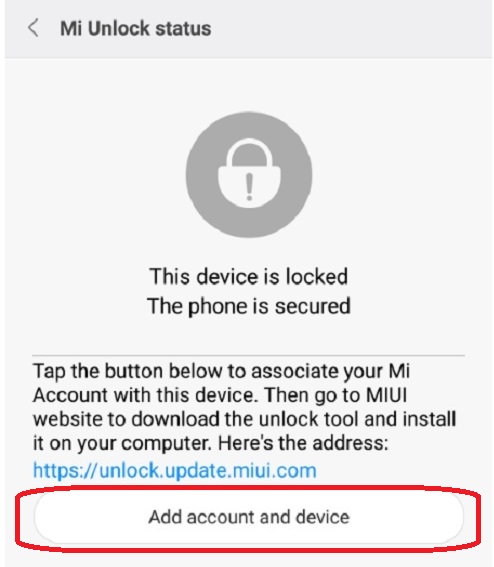

4. Go to Settings - Advanced settings - Developer Options - MiUnlock Status.
5. Tap to button to associate Your Mi account with smartphone.

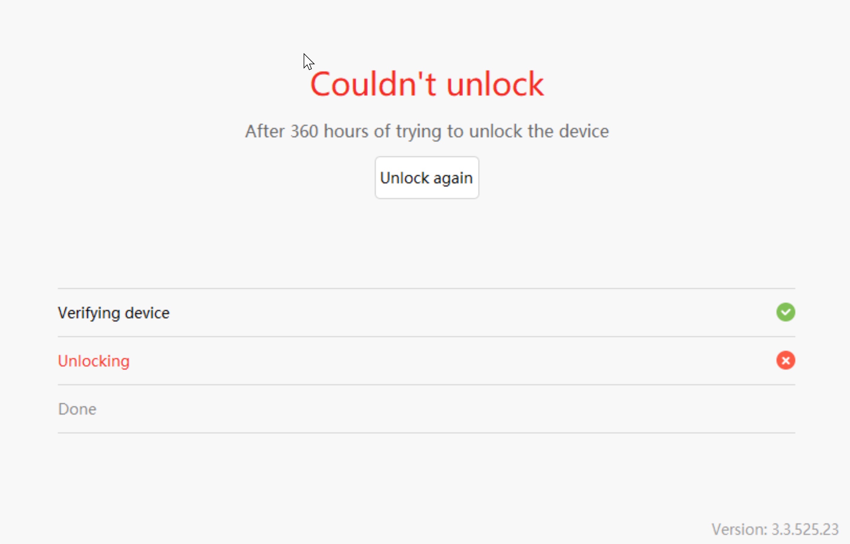

Most likely you will have to wait 360 hours before You allowing the bootloader to unlock.
Just wait...
After that again try to unlock the bootloader in utility.

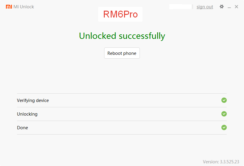

If You see this - bootloader Unlocked!
Just wait...

I ve tried and it said to me that i have to wait 360 hours . I ll wait .
Indeed, we are not trying to unlock the phone. We have a 360 hours waiting time. Is that possible? That's nuts.

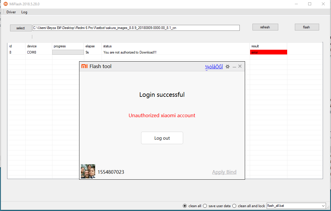

Unauthorized xiaomi account
Hello.
After my unlocking the bootloader of REDMİ 6 PRO, I flash a firmware with MiFlash. But it issue some errors and closed.
Fastboot does not enter anymore.
I tried to enter EDL mode, but it does not authorize my linked mi account somehow.
Can you help me solve the issue?
