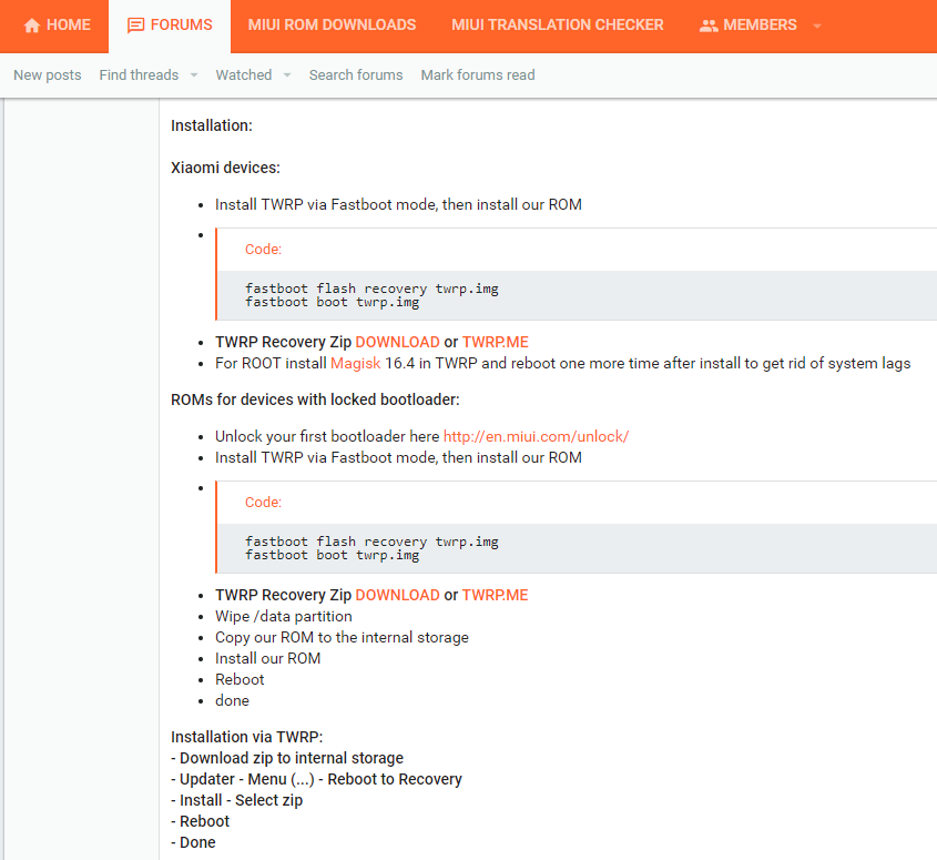

2. https://www.xda-developers.com/what-is-adb/
3. Twrp.bat must be started from PC
4. You can not flash ROM from internal storage, because section DATA will be encrypted and don't available in TWRP. Put ROM to SD Card.
5. After you start the TWRP.bat, the recovery will start in the smartphone.
6. In TWRP click button Install ZIP. Select the SD and select the firmware file. Confirm with swipe to the right. After the installation is complete, you will see an offer to reboot into the system.

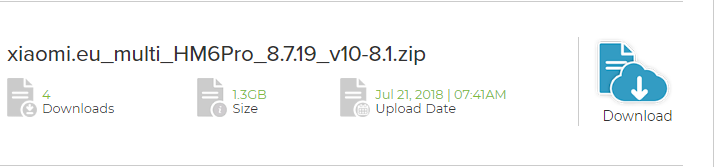

You must to unlock bootloader first. Xiaomi.eu ROM's are installed only on unlocked bootloader.

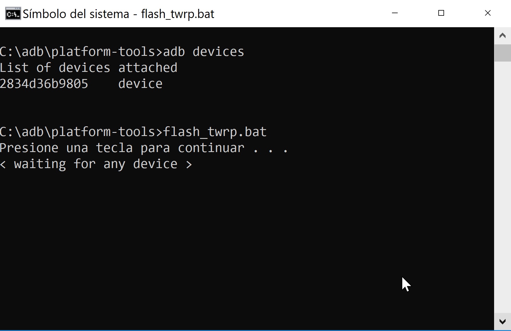

Dear @ovpshka
I followed all the steps but stuck in the 3rd.
  1. Download the RAR File i´ve attched.
    • OK
  2. Copy the 2 Files into your ADB Folder on your Computer.
    • OK
  3. Open flash_twrp.bat (Fastboot Mode)
    • I'm stuck here. Please check the screenshot.
      • As I can see in the flash_twrp.bat file the script does the following:
        • @echo off
          fastboot devices
          pause
          fastboot erase recovery
          fastboot boot twrp.img
          pause
        • Everything is in the same folder (twrp.img and flash_twrp.bat). What's the problem? It's just stuck here. "Waiting for any device" but the device is detected. What's wrong?

moon.moneky
Jul 17, 2018
12
5
Problem solved. Now we are downloading the unlock app from Xiaomi site.
Should we upload the rom as a ZIP file or unzipped? Thanks!

Do You have UNLOCKED bootloader?
If NO, then nothing will turn out.
