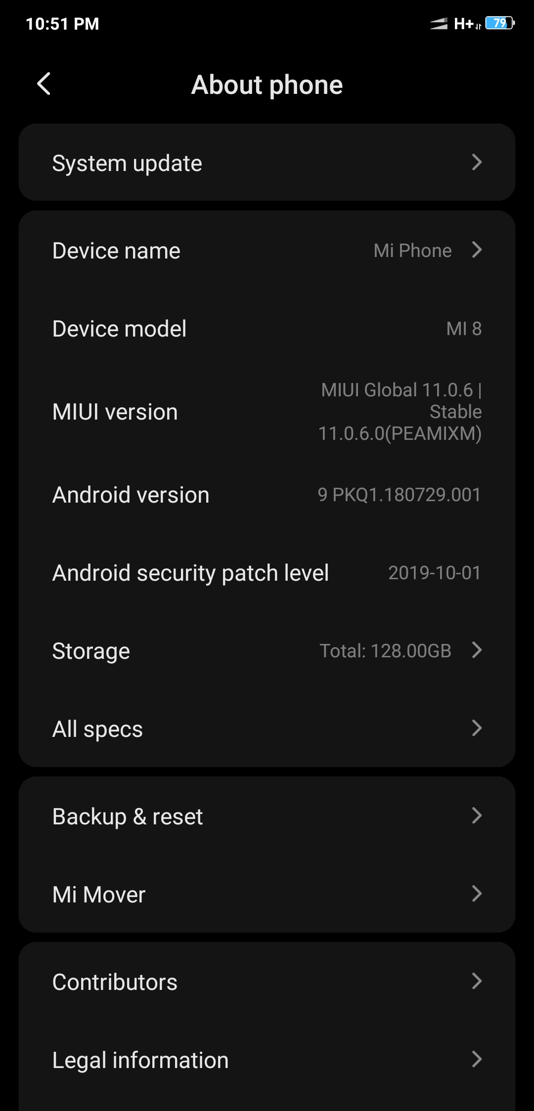

iam using xiaomi mi 8 china rom, and recently i switched it to global romHard to help without knowing your device model and what ROM you use... lol

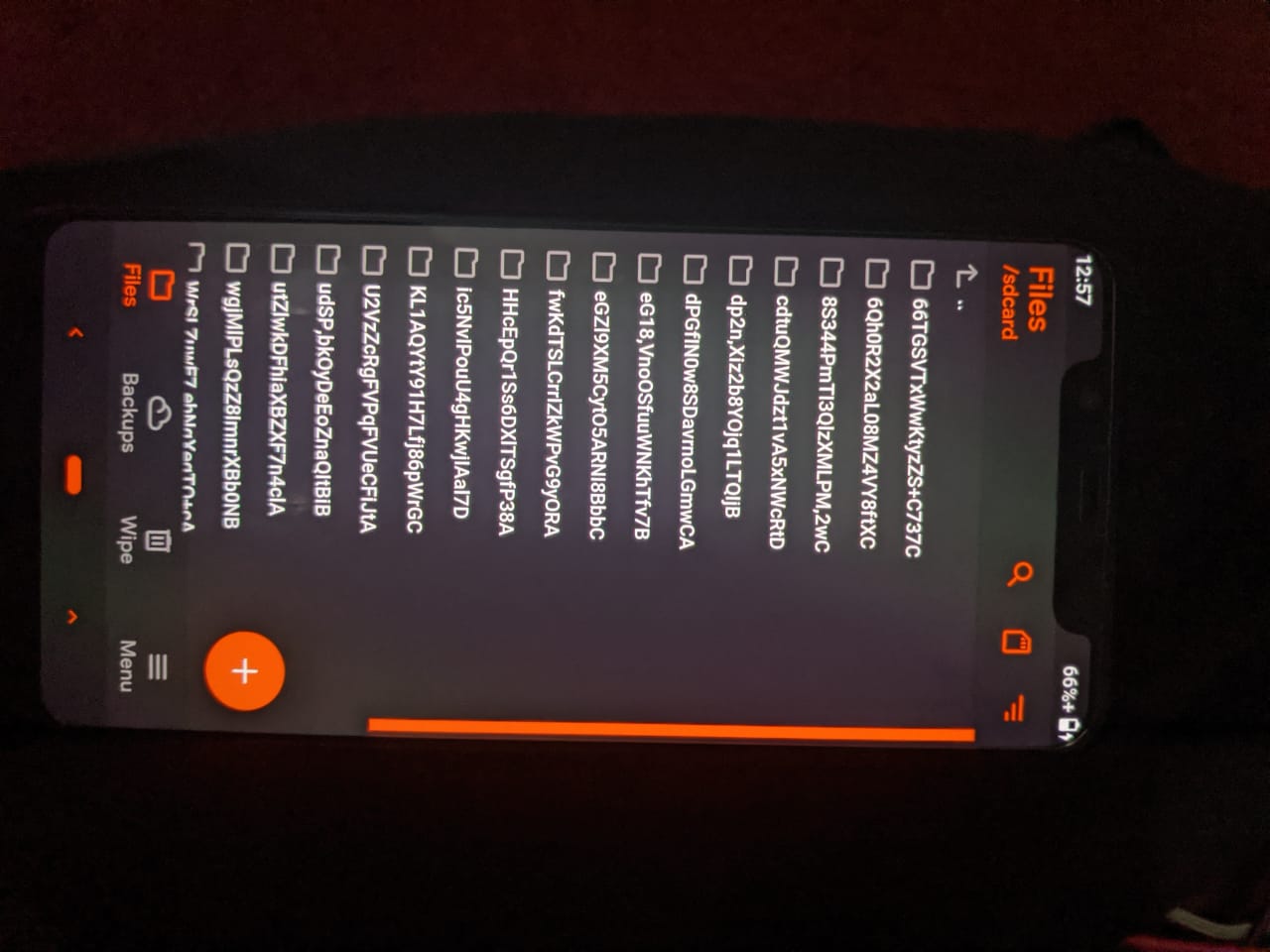

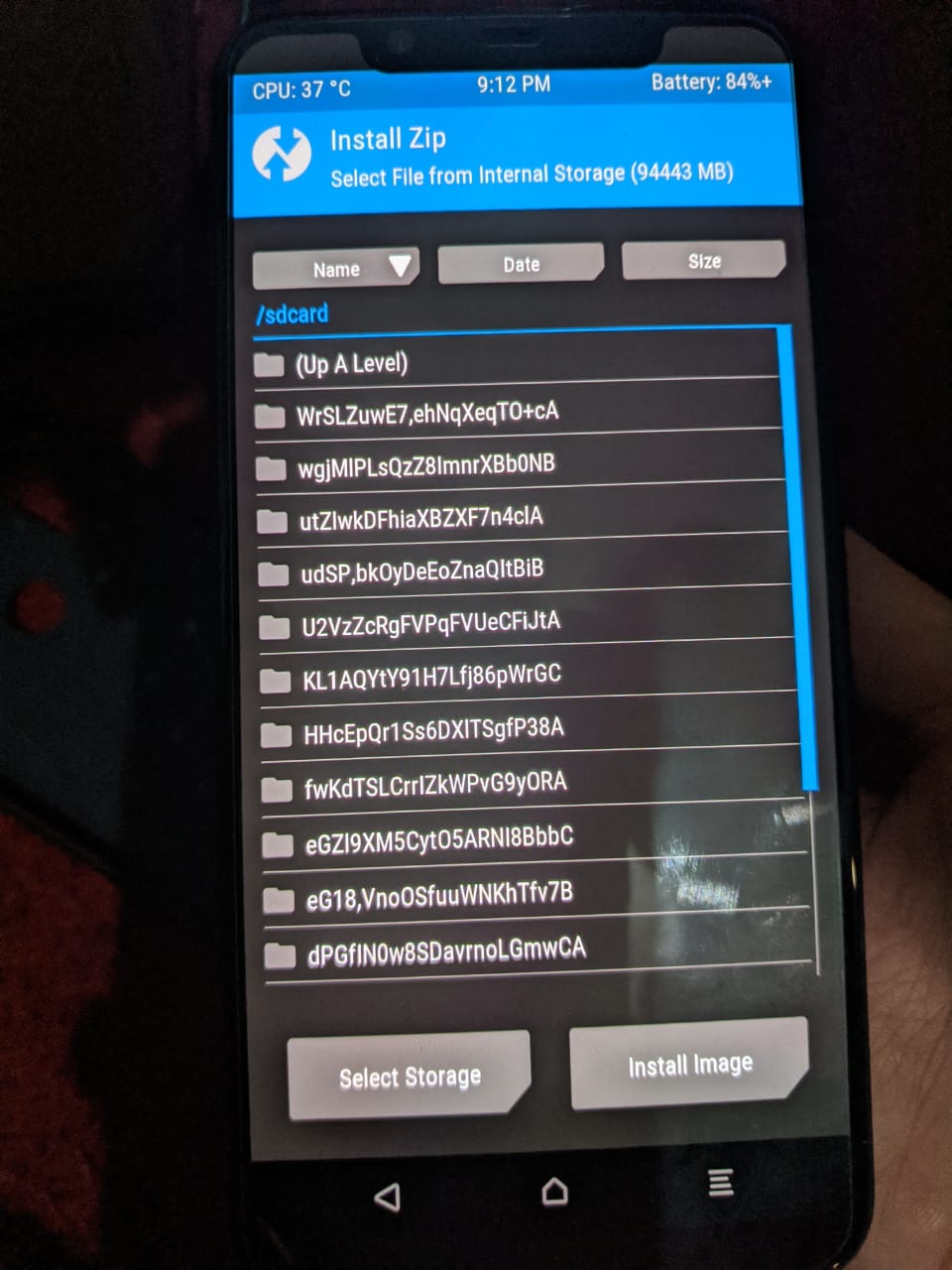

but still, if want to install orangefox need to install using recovery mode right? i cant find any files in my install section in recovery mode thoUse OrangeFox recovery for your phone. OrangeFox decrypt your partition

So do you downloaded this version => https://files.orangefox.download/OrangeFox-Stable/dipper/OrangeFox-R10.1-Stable-dipper.zipbut still, if want to install orangefox need to install using recovery mode right? i cant find any files in my install section in recovery mode tho
fastboot flash recovery recovery.img
still the same lmaoSo do you downloaded this version => https://files.orangefox.download/OrangeFox-Stable/dipper/OrangeFox-R10.1-Stable-dipper.zip
Two ways:
1) Put zip file in a SD card or use USB OTG to be able to flash it in TWRP.
-OR-
2) Extract zip file and flash "recovery.img" file via fastboot command (using a computer):Then, hold "Vol+" and "Power" buttons to boot to OrangeFox ; Now you can flash OrangeFox zip file in OrangeFox for a complete install. ^^Code:fastboot flash recovery recovery.img
Which Global ROM version you installed?still the same lmao
You can't tell me the version number?All official MIUI 10 ROM for MI 8 / Mi 8 Lite/Pro ! Last Global Developer v9.6.27! - Mi 8/SE/EE/Lite/Pro - Mi Community - Xiaomi
All official MIUI 10 ROM for MI 8 / Mi 8 Lite/Pro ! Last Global Developer v9.6.27! - Mi 8/SE/EE/Lite/Pro - Mi Community - Xiaomic.mi.com
i use V10.0.2.0, but now i already update to miui11You can't tell me the version number?
Unclear... But try the previous OrangeFox version => https://files.orangefox.download/OrangeFox-Stable/dipper/OrangeFox-R10.0_4-Stable-dipper.zipi use V10.0.2.0, but now i already update to miui11
EDIT: Here are all version number, what's yours? => https://mirom.ezbox.idv.tw/en/phone/dipper/roms-global-stable/
