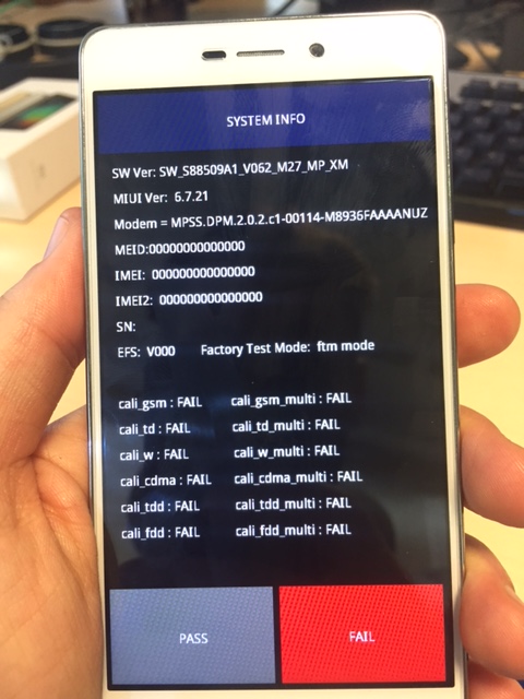

    Hi to all,
    I have a really urgent problem.
    I erased modemst partitions and I couldn't restore my IMEI and Baseband in any ways . The only way to restore them is a .qcn file backupped from a working REDMI 3, but on the net I couldn't find it. So, if someone of you do have 15 free minutes, would you backup your efs partitions with Qualcomm QPST tools and send to me the qcn file? Of course I'm asking for a null IMEI, I don't want yours, I'll overwrite mine that I have printed on the phone's box. Please help me, it's really important!

    An user from an Italian forum sent me his qcn backup and I just changed the IMEI using efs tools (taken from XDA) and QPST. Then I restored the qcn with QPST .
    I had to use both efs tools and QPST because using only efs tools I wasn't able to change the IMEI of both sims and so I had one sim with my IMEI and one with his IMEI .

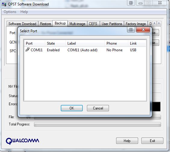

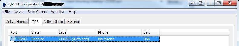

    so, I have this in QPST with the phone connected. any ideas how to solve this puzzle?
