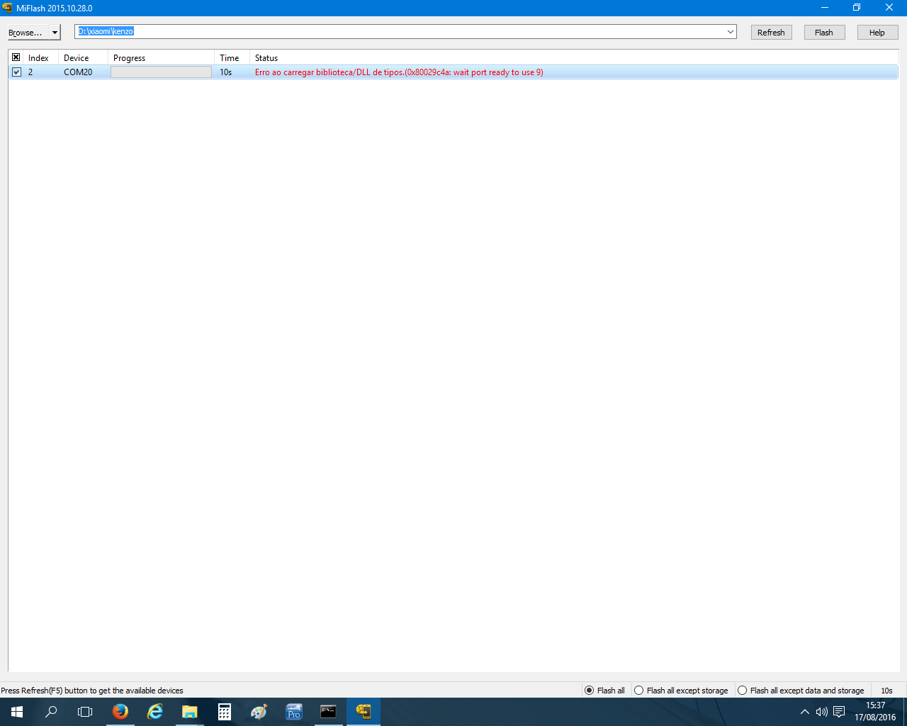

The phone is detected as qualcomm 9008, like in procedure. As in fact, i have done all as is in the procedure, but Mi Flash keeps saying after clicking in Flash all: wait port - busy".
Will post a screenshot as soon as possible.
So here is the screenshot of the erro on Mi Flash tool.
Any help?

Ok, i solve it!
I searched for a more recent Mi Flash version.
And one that is as an installation and not only in zip mode.
So the version that worked for me was MiFlash 2016.04.01.0 (64-bit).
Got from here: androidmtk*com/download-xiaomi-mi-flash-tool.
Thanks to everyone!
