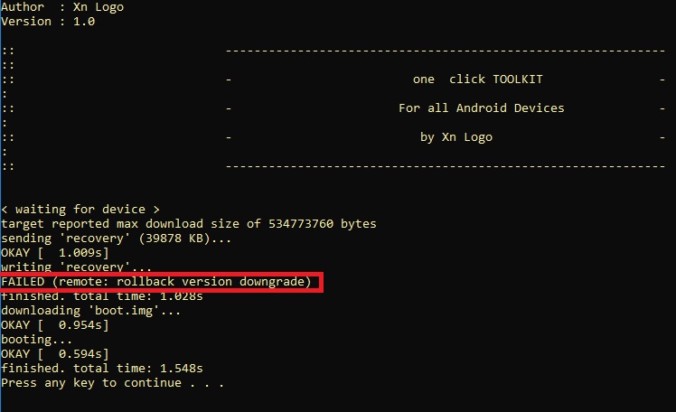

I got FAILED (remote: rollback version downgrade)
My phone is Redmi 6 Pro (unlocked)
After twrp started it asks for passwored
Any hint
Any hint
Finally, I got it work and installed MIUI 10 STABLE RELEASE
1 - I run commands:
fastboot boot twrp.img
- but it asks for password
- I cancel and wipe data
- I install ROM (installation ends with errors)
- I restart
- phone boots in fastboot screen
2- I run commands again:
-now twrp dose not asks for password
-I install twrp.img
-I install ROM
- Restart
Every thing works ok :)

1 - I run commands in ADB fastboot tool:
- (it asks for password) , cancel and wipe data
- install ROM (installation ends with errors)
- restart
2- run commands again in ADB fastboot tool:
3- now twrp dose not asks for password
- install twrp.img
- install ROM
- restart
