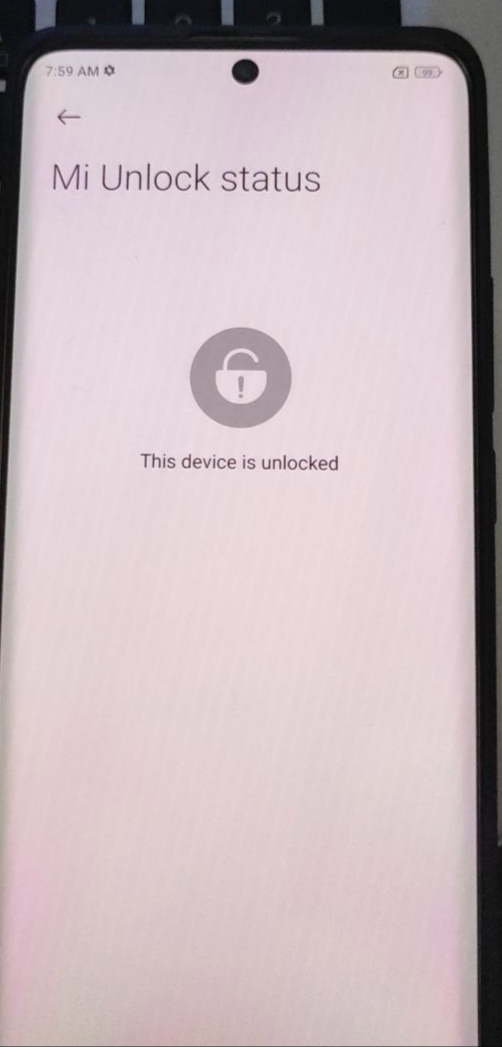

who says note 13 pro+ cn version canot unlock???

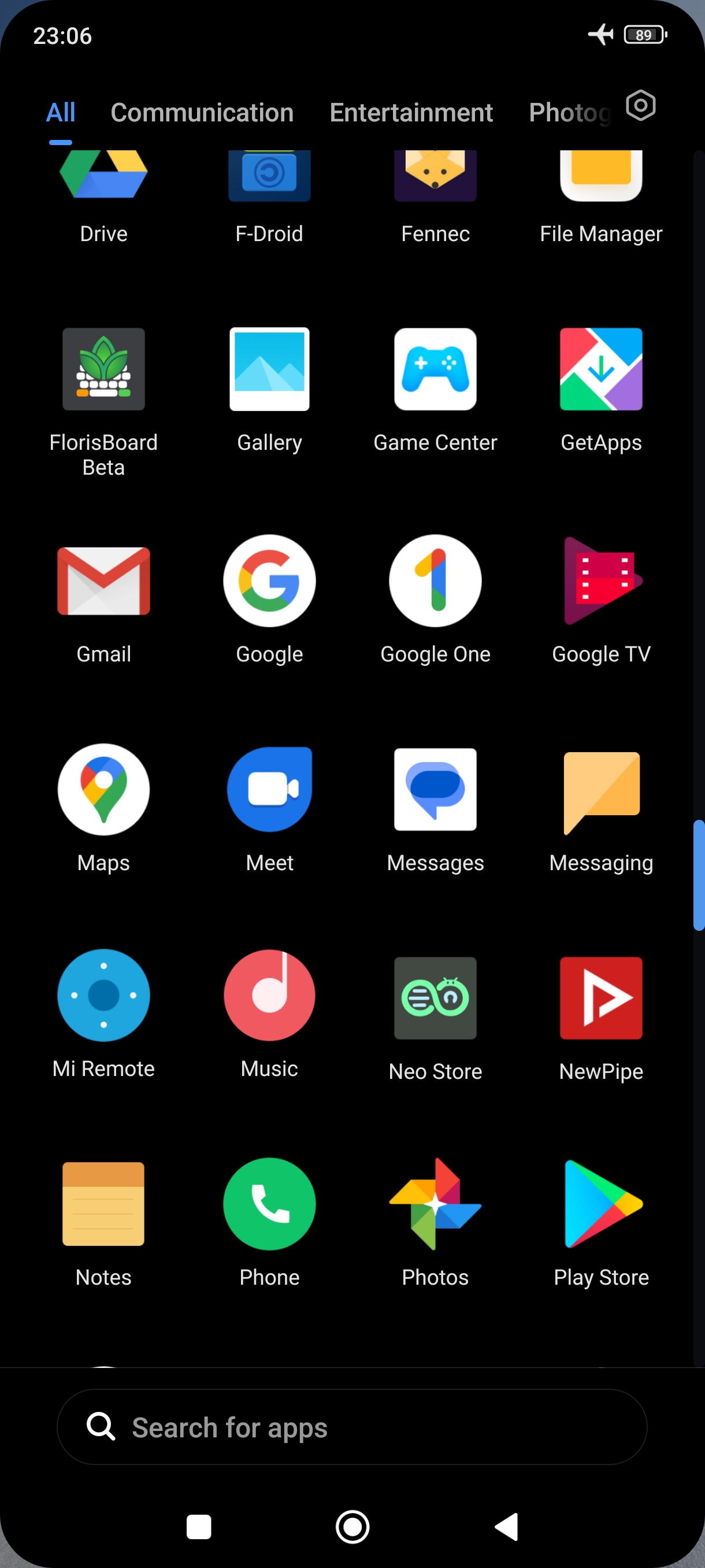

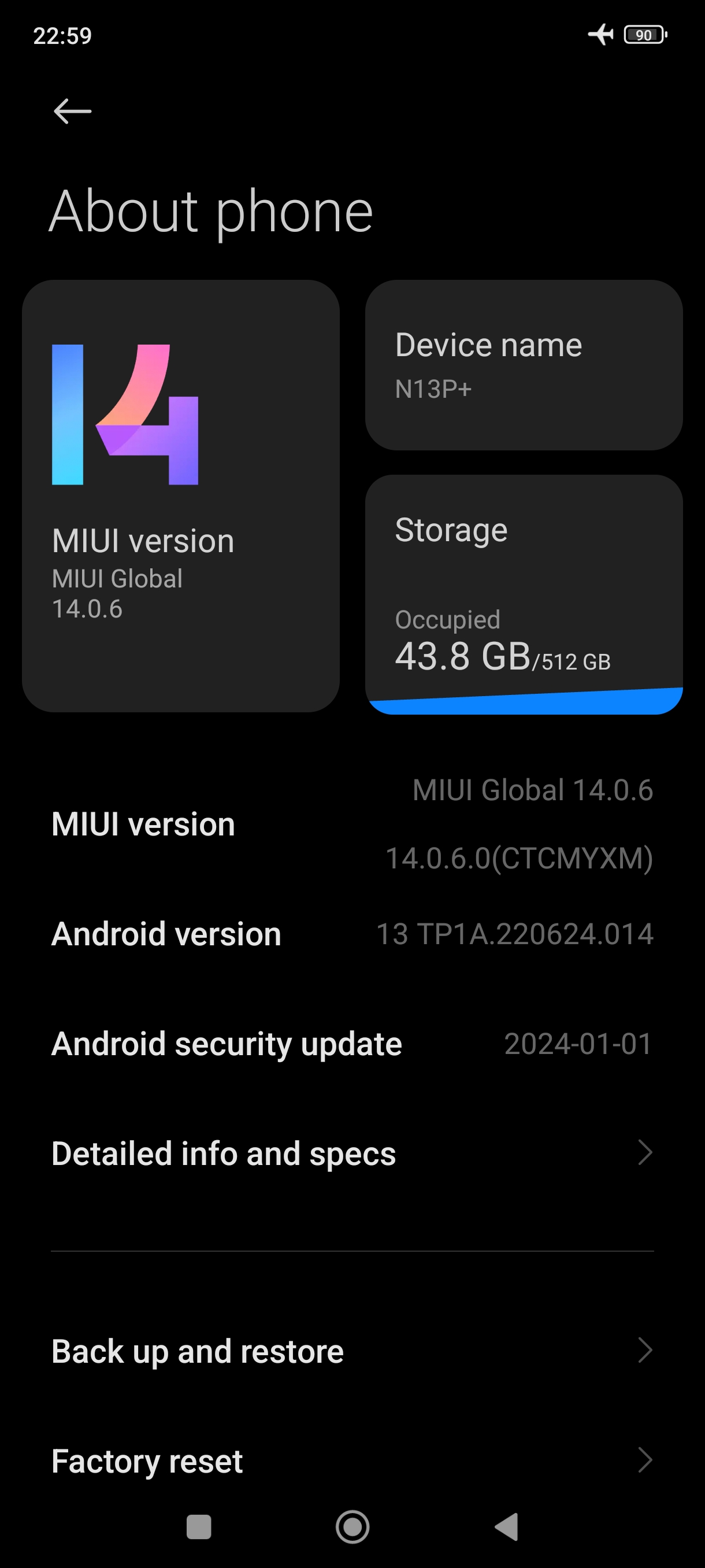

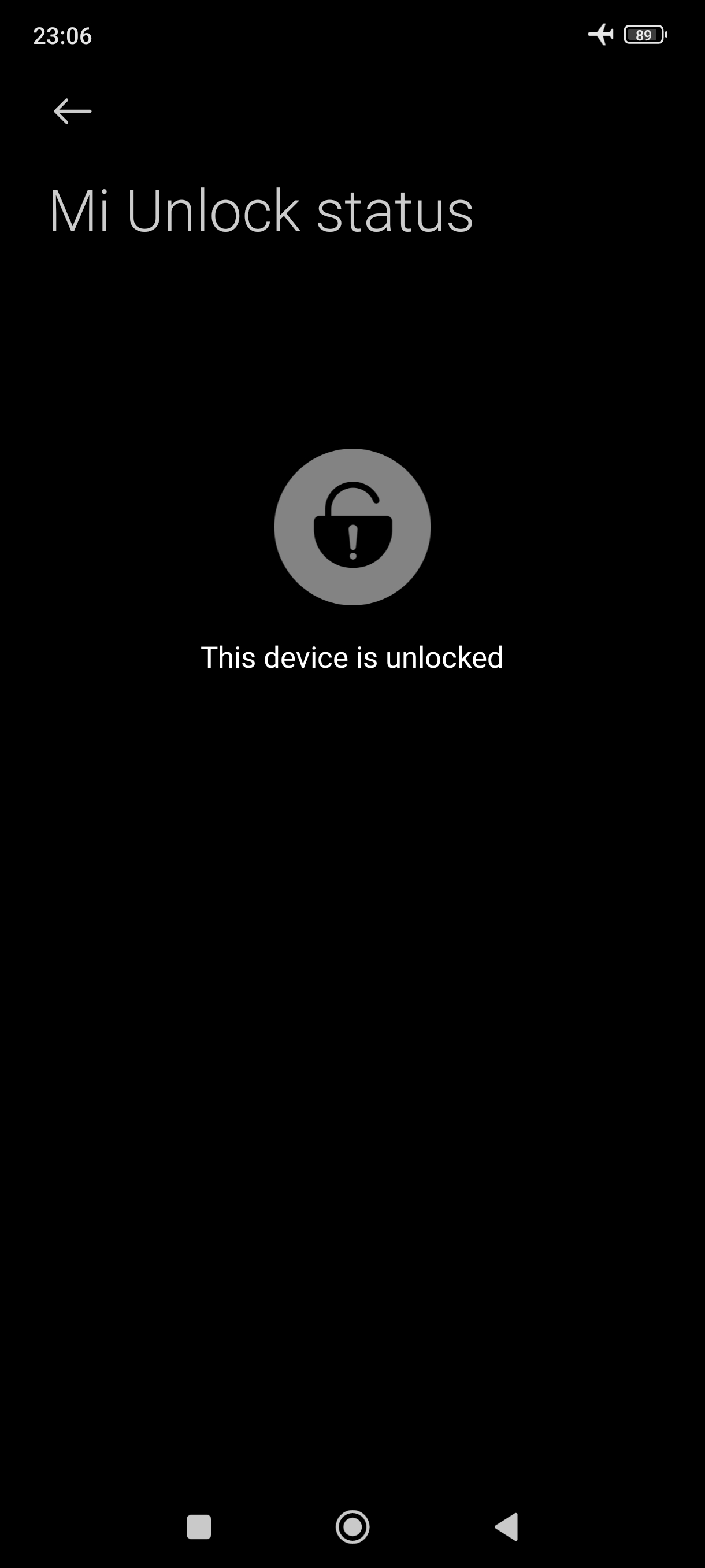

This is fake rom! I have the same. In this rom, Google apps are installed but mi unlock section is disabed and shows " This device is unlocked".
But not!
If you connect the device in fastboot mode,
on the widows or linux command line just type
fastboot device getvar all
you can see device: Locked
The only way to unlock chinese phones is "paid service" for now.
And here comes the special information!
I paid 48$ to "UnbrickedMe" to unlock bootloader on telegram. He is Indian rookie guy and did just converted the device to global rom! And didnt unlocked it. He said this is temprory unlock, permanent unlock is 80$ extra! He tricked me and always increasing price for service. 40 » 48 » 60 » 80...
He is unexperienced and not trustable! (I have screenshots)
Anyway, I recommend you to unlock bootloader with xiaomikey service! If you dont have any experience about fastboot mode, bootloader. adb, drivers etc., dont try to resolve by yourself. Just pay the price, buy the service. Probably NCunlock is a good one.
