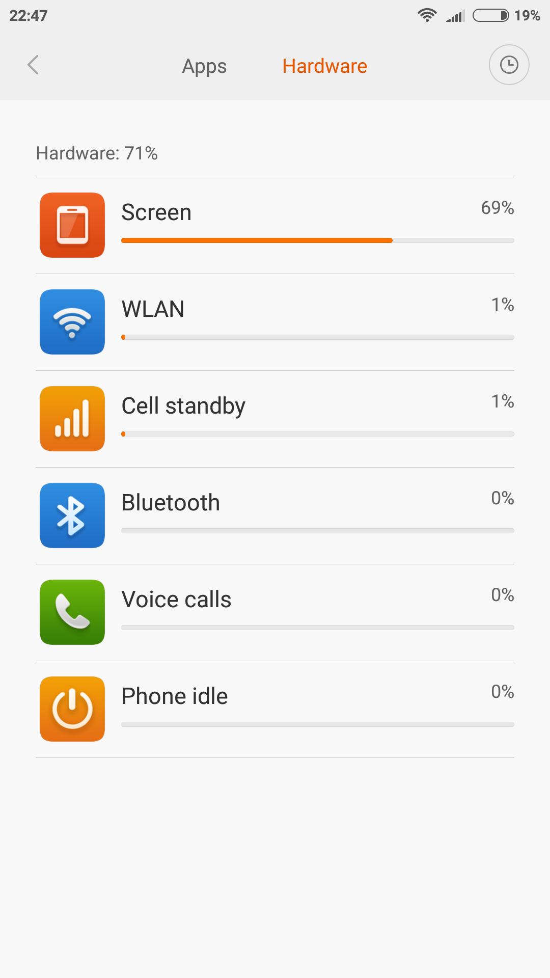

Hello everyone, i would like to express a problem that i've been facing after unboxing this phone 1 day ago. So as soon as i turn on the phone the phone heats up to 60 degrees Celsius, like WHAT, when i go to the battery info it says that about 71% is being consumed by the hardware and 69% is being consumed by the display on MINIMUM brightness... It heats up as soon as it boots, i tried factory reset, cooling APP, killing background apps, balance mode enabled, i dont even have to open any APP and the phone is hot as hell! Is this an hardware issue? Thanks for stopping by and reading all this! Help?!

I cant change the rom, ill lose my warranty due to gearbest policy, the phone right now is at 70° Celsius... Like what
That's sad to hear, I'm glad I got Snapdragon variant. Have you tried turning off the phone and opening the back of the phone with your nails to remove the battery for a good 30seconds to 1minute, afterwards place it back on. Tell me results, good luck.

Unfornately the battery is not removable and if i try to remove something it voids my warranty, ridicolous gearbest marketing policies, and its actually not the battery, the cpu is the the one heating up when the battery stays around 30 degrees and the cpu from 55-70... I wanted to return it get my money back and order the sd variant but i might get taxed when shipping the phone back to China :(

Agradeço a tua resposta, felizmente consegui atualizar para o miui 8 6.9.1 Developer China rom sem problemas através de um guia aqui no site! Usei uma fastboot Rom sem desbloquear o bootloader, e tens razão, as garantias lá fora são duvidosas, pois para o enviar se houvesse algum problema teria que pagar 100€ de taxas alfandegárias e de qualquer maneira nunca poderia usufruir da garantia! O problema de aquecimento também desapareceu! Estou muito contente com esta ROM e obrigado pela a ajuda de todos!
