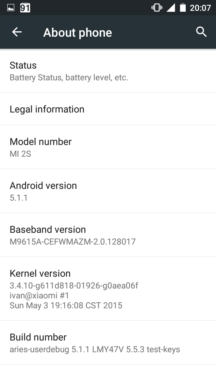

Everything is fine for me, excellent Ivan`s rom 5.5.3 and partitions are new and everything is good.
But you must finish the installation of miui rom and it is long waiting procedure, also after that you must flash Ivan`s cwm recovery (chinese language) via fastboot...

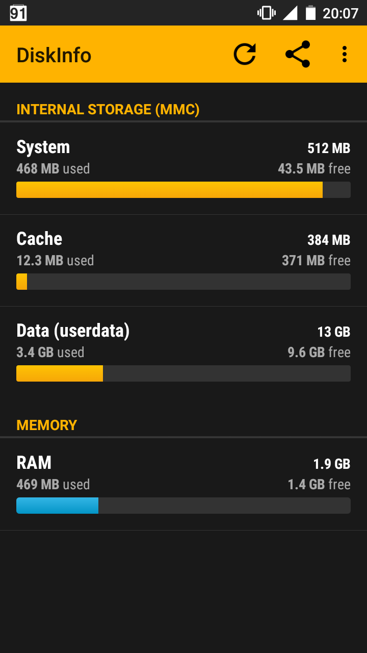

How to extend system partition to 1GB?
I dont like 512MB it is so small, last time I had from Micha`s script 1GB of system, because in the near future we will get CM12.1 (I hope so) :)

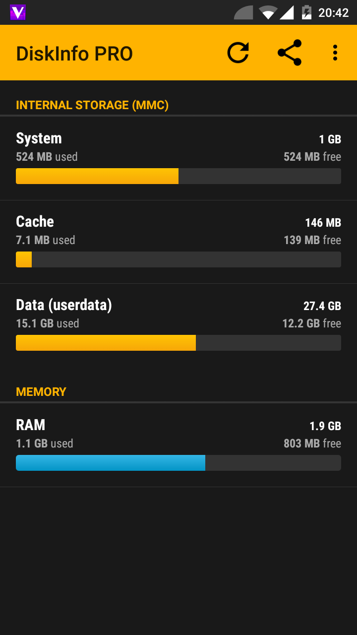

tmp_24305-Screenshot_2015-05-05-20-42-511660032709.png you also can use parted via adb or twrp and do-it manually , basically you delete userdata and sdcard , create a new data partition with the size of both , i've used twrp + parted , without rom , bootloader , adb .

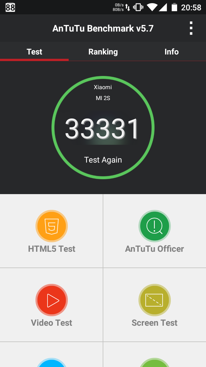

So far so good it is excellent ROM, the best I flashed on my mi2s! Follow the white rabbit!;-) In Developer options there is CPU Power Mode with performance mode, normal mode and power save mode. With Performance mode it scores pretty well in antutu benchmark...
