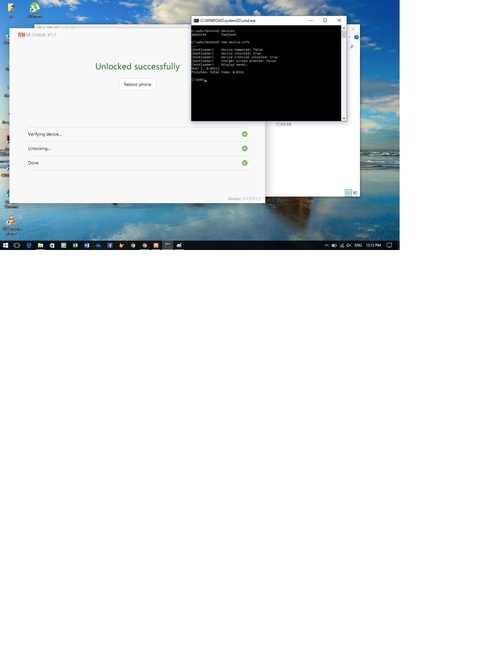

Friday I applied for unlock permission, currently I'm on Miui 8.3 7.2.16 Beta Xiaomi.eu and today (at 3 am) I received the SMS....actually received 3 SMS's from Xiaomi with unlock permission. So I just downloaded miflash and started to read the FAQ. Long story short.....I just unlocked my phone without the 50% error from the first try.
Downloaded also from the FAQ section miflash_unlock-1.1.1111.11231., uninstalled old driver and reinstalled the driver (Win10 - 1607 gives error regarding the driver). Connected the phone to the pc, it showed unknown device, so went to C:\windows\inf folder and there found the wpdmtp.inf file and right clicked and installed. Then the phone was detected as mi4c. Enabled from developer options OEM Unlocking and USB debugging. Shotdown the phone and disconnected from pc. Started MiFlash and logged in, started the phone in fastboot mode (volume down+power), the phone was detected by Mi flash and unlocked it, without any problem.
Hope this helps.
I applied for unlock and got my unlock approval sms 1 week later during CNY (Chinese New Year) period. I was on china stable rom so i updated my phone to latest china dev rom. I tried to unlock but it wouldn't get past 50%. Some forums said i have a wait a week for the Xiaomi servers to update my version details. I waited 2 weeks and tried to unlock again last week, but now i got an error saying i don't have unlock approval. So I applied for unlock approval again and got my approval sms within a few days. I managed to unlock successfully today. After some nerve wrecking moments (phone stuck at Mi logo after installing TWRP), i finally managed to flash to xiaomi.eu stable rom an hour ago. :)
......uninstalled old driver and reinstalled the driver (Win10 - 1607 gives error regarding the driver). Connected the phone to the pc, it showed unknown device, so went to C:\windows\inf folder and there found the wpdmtp.inf file and right clicked and installed. View attachment 15378
