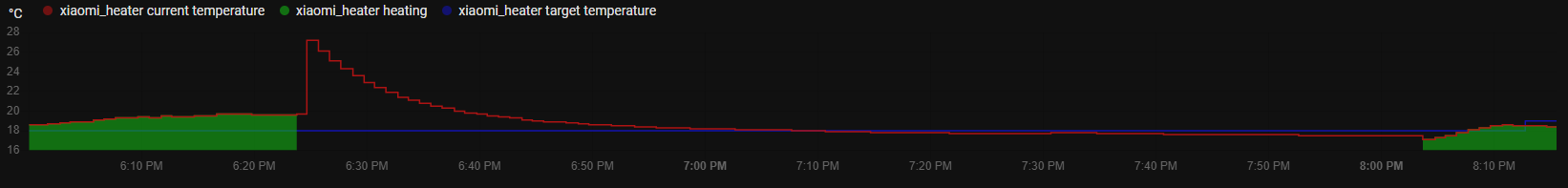

I've installed the Home Assistance on a Raspberry Pi to monitor the performance over time.
33584
The blue line is the Target temperature, Red Line is the Heater temperature and the green area is when the heater is turned on. You can see the jump at the end once it's turned off. In this example, Target was 20º, Heater temperature was a little above the target, but the room, was constantly @18.7 (measured with a stand alone sensor). The Heater was consuming ~1300W so it was not working at full power.
This time around, it was pretty constant, although it didn't get to the target temperature. I am unable to monitor with HA the power consumption, but I will get there... eventually.

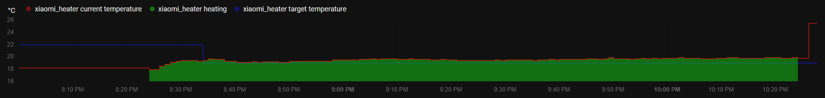

Feedback on Automation:
33615
After the temperature jump (to 28º) it takes a while to turn on again. Room temperature is always 2º lower then the heater sensor displays.
The automation is set to: (based on the Heater sensor)
- Turn On if the Temperature get's lower than 18º
- Turn off if the Temperature get's higher than 20º
Since there's a difference between the heater and the actual room temperature, in the mean time, I will get a Xiaomi Wifi Temperature/Hidrostate sensor, those are pretty cheap and I can integrate it with my Gateway and Manage the automation based on an external sensor.

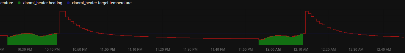

Me too. I've reported the situation both to the seller and Xiaomi. no answer until now. I've bought those little sensors to integrade with the automation. right now, it works fine if the automation is based on the external sensor. But this only starts and stops the heater. It cant manage temperature or power, so it works always at 2200W.
33757
As you see, target is 18º... he starts once the temperature is lower then 18. and it wont stop. until the automation set's it to off, once the temperature reach 20º.
