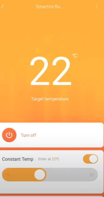

Is there a way to see the sensor/current temperature value in the app ? It shows only Cool, Comfort

Is it possible to see here the target temperature ? In my version shows cool/comfort instead of the actual value
Pay attention! It's not the heater screen, it's the devices screen.
Sent from my SM-G973F using Tapatalk
Yes, I can see there the heater temperature but the problem is I can choose only one device as temperature source in environment info settings
It's not the device temperature, it's the room temperature sensor. Which is what you initially asked.
I don't have multiple devices so I don't think I know what you mean or that I can help with that. But I imagine that that one sensor will regulate multiple heaters in the same room for the temperature you set.
