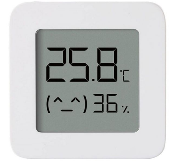

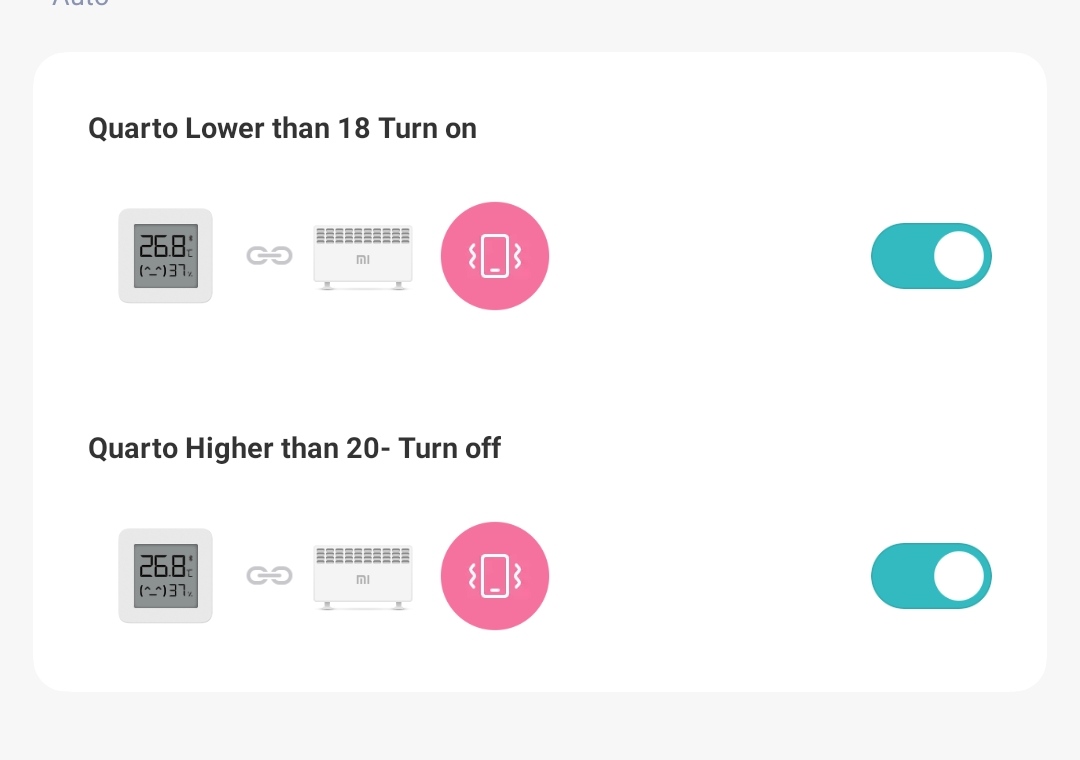

Me too. I've reported the situation both to the seller and Xiaomi. no answer until now. I've bought those little sensors to integrade with the automation. right now, it works fine if the automation is based on the external sensor. But this only starts and stops the heater. It cant manage temperature or power, so it works always at 2200W.
As you see, target is 18º... he starts once the temperature is lower then 18. and it wont stop. until the automation set's it to off, once the temperature reach 20º.
Can you post a link to those sensors?

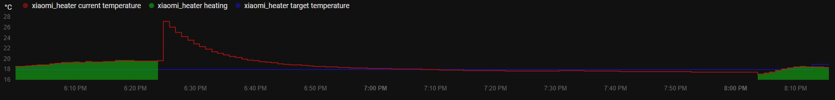

I made a simple test with a external thermometer to measure the room temperature and a wattmeter to measure power being consumed by the heater.
Had the room at 15ºC (Heater off), set the heater to 18ºC and turned on the heater. Heater started consuming around 1200W, and the temperatures climbed to around 22.5ºC after 1h30min. During this time the watt consumption was constant at around 1200W.
Then, using the app, I changed the temperature to 28ºC, the heater jumped to around 2200W, 5 seconds later I changed back the temperature to 18ºC and the heater went down to around 900W (the room temperature was still around 22.5ºC).
The heater seems to only adjust the power consumption when the temperature limit changes (similar to other posts in this topic), and never turns off completely even if the room temperature is above the limit.

Yes, seems like the internal sensor while working only serves to have info on the app. But only when you adjust the defined temp is when he adjusts the power consumption.. and not automatically as in the product description.
33920

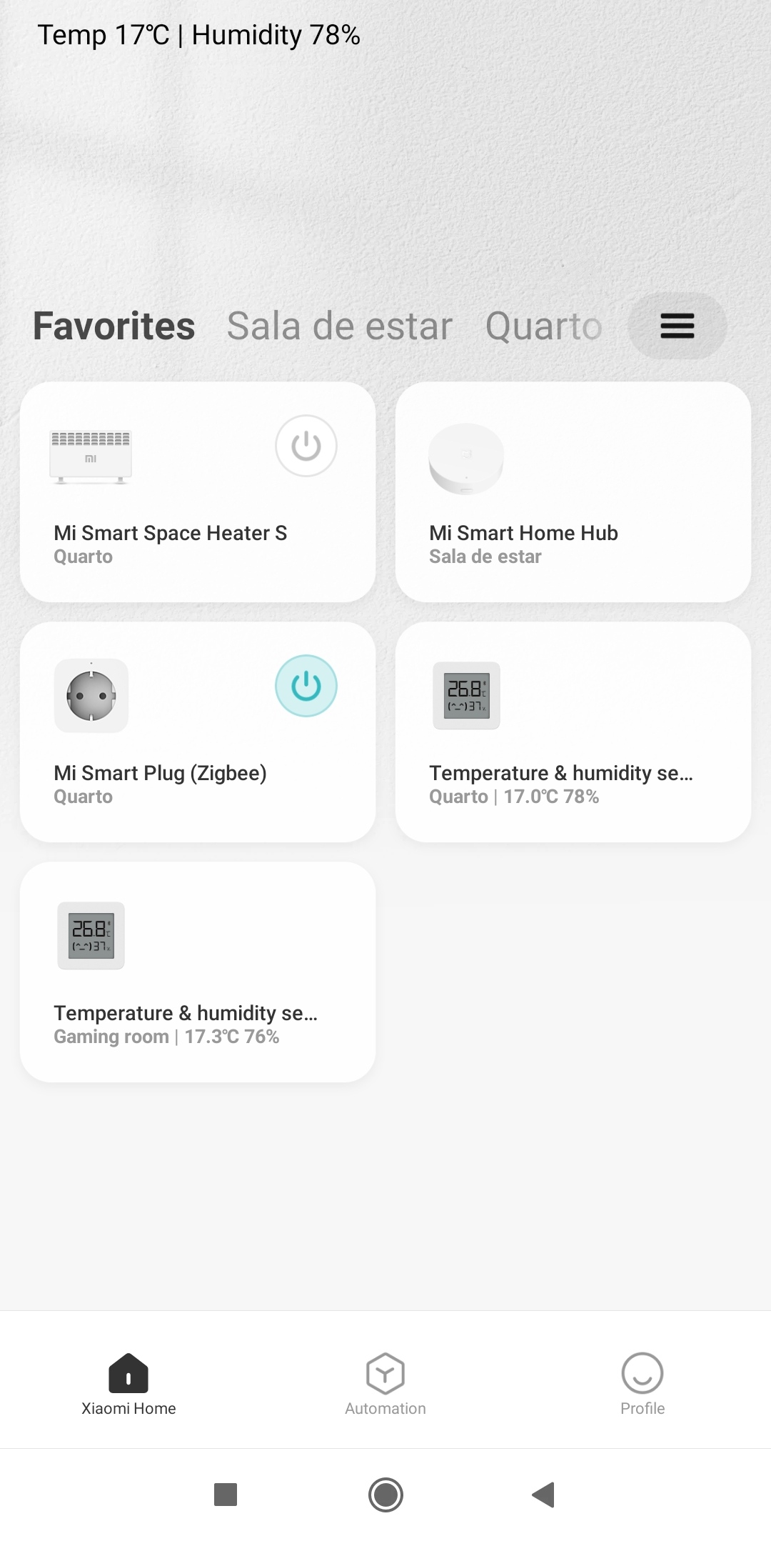

These are BLE sensor that can integrate with a hub/gateway. I'm using Mi Home for the automation. Home Assistance, as it has no support for now, it's only monitoring the heater.
I have one of those sensors, can you tell us what hub do you use to integrate it?
