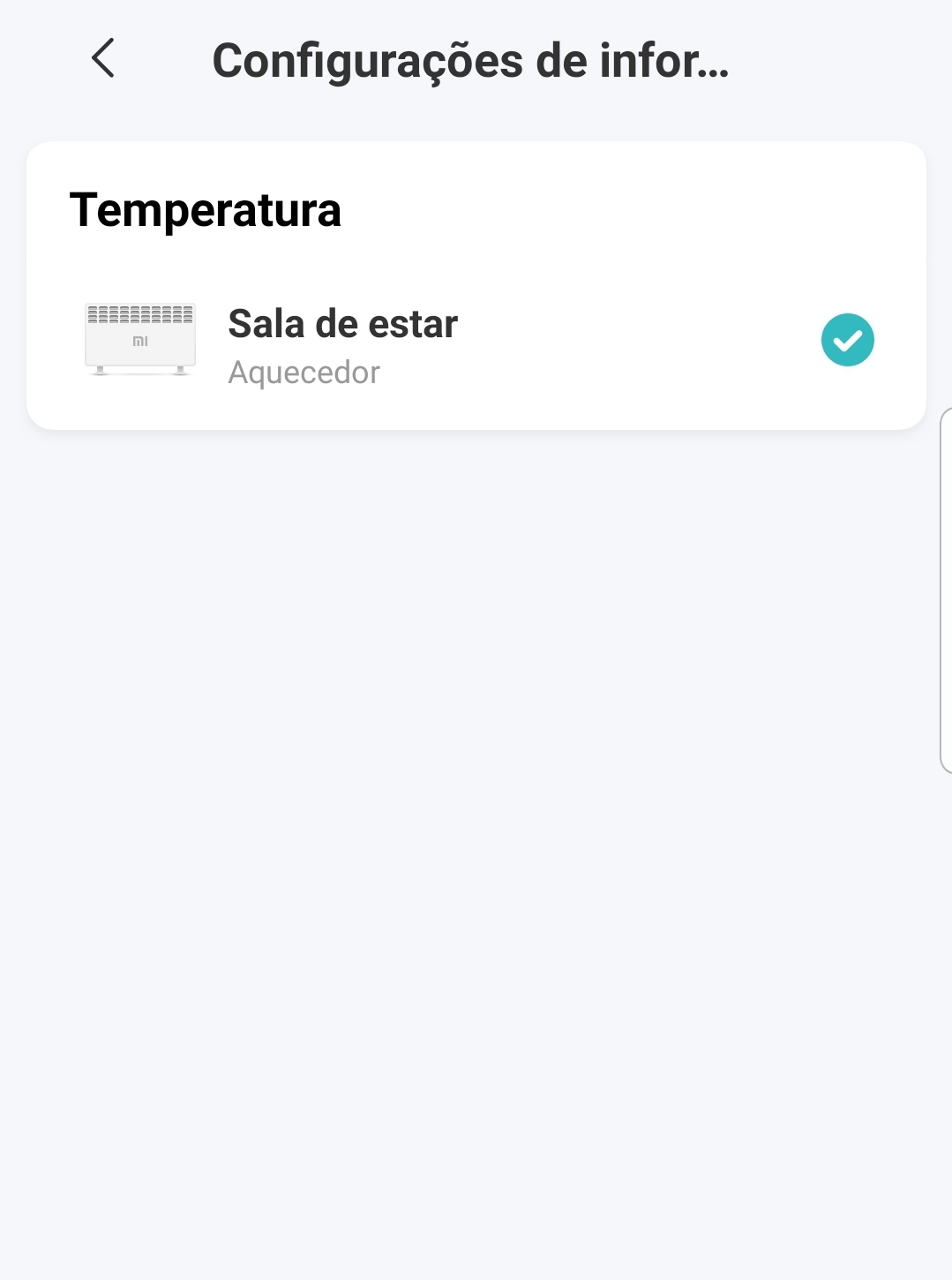

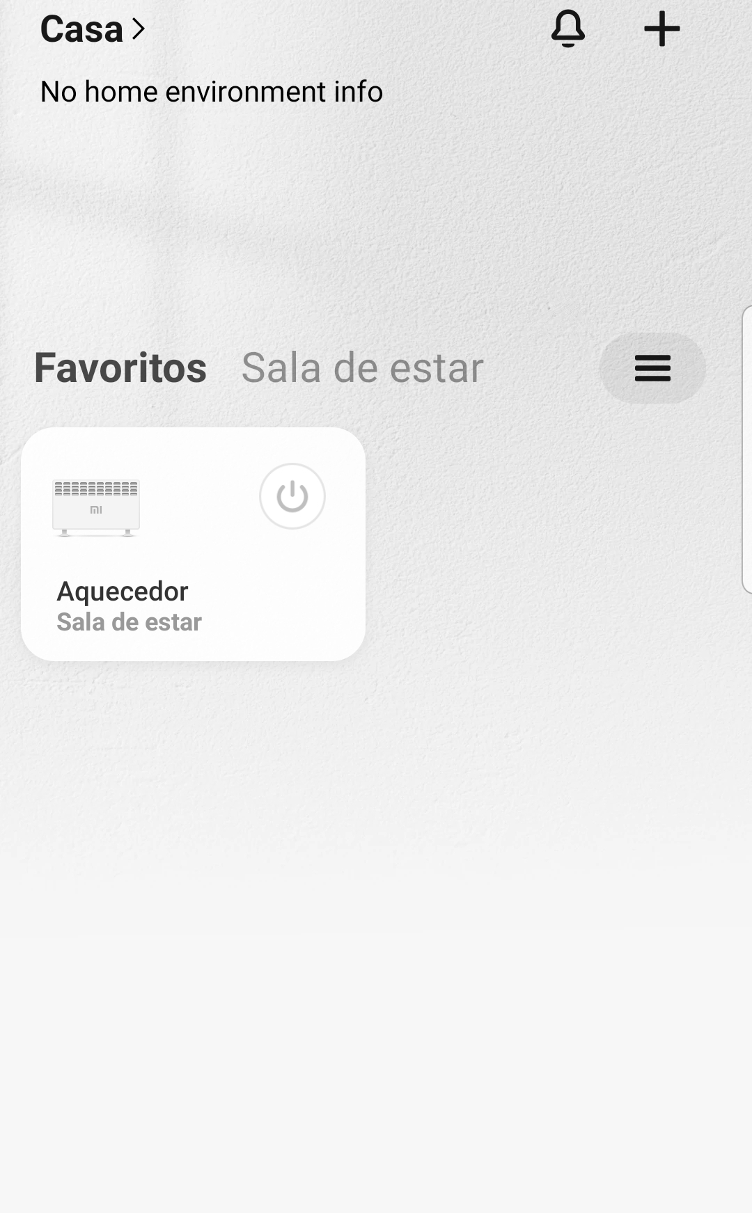

Anyone noticied the environment temperature is missing on the app?
33950
And I've selected the heater as a temperature source:

Thanks for your reply.
I reinstalled the device on the app and now shows the temperature.

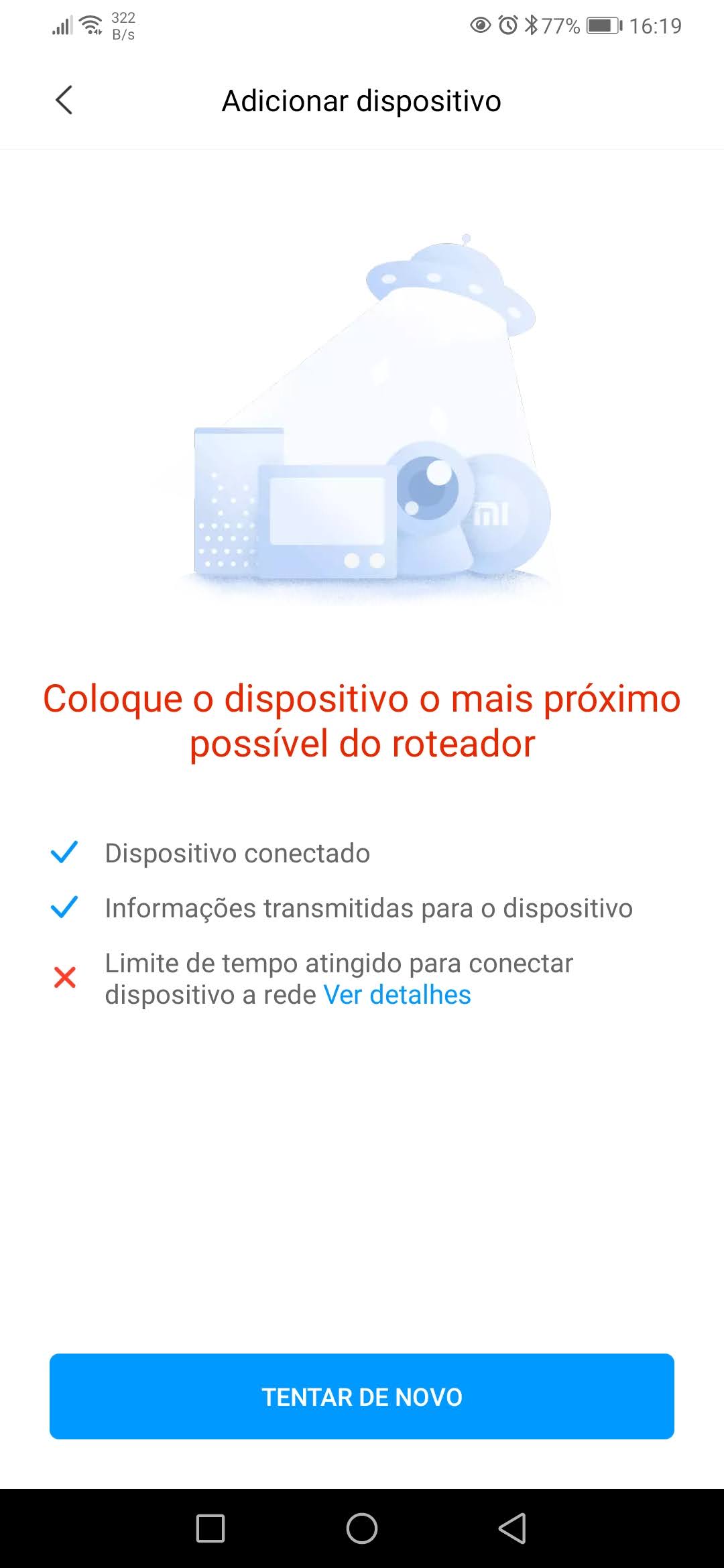

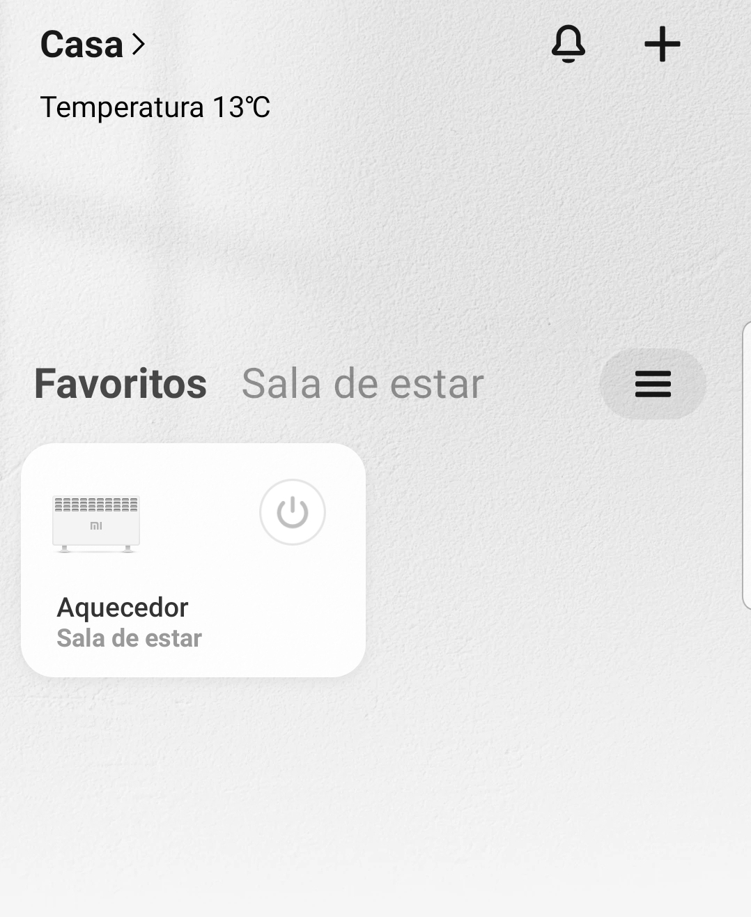

Hey guys, I received it my today, but i can not connect with my wifi. I already tried with several version of MiHome app but without success.
Anyone can help me with this?
Hum... it was fairly easy to connect here. Make sure you have bluetooth and location services activated.
I have all of services activated.
I'm always having this problem as the image describes.
Any idea?
