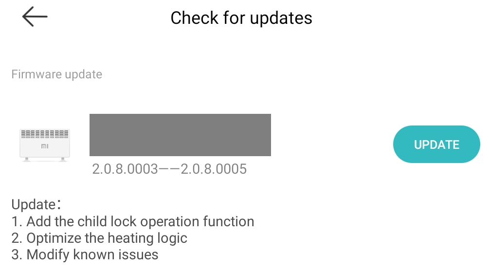

The first time I received an update at Mi Home. When I entered the Mi Home application, I saw that an update for the heater appears. I did that update. It's still not clear if everything works. I'll come up with details in the next few days.

Firmware 2.0.8.0005 indeed makes the heater turn off completely when the required temperature is reached. (Region - Russia)
However, the internal sensor still shows the temperature several degrees lower than it should be. This behavior seems to be an outcome of the bad sensor placement rather than a software issue. Too close to the cold floor! Since the sensor is almost external, you can find it at the bottom, under the area with buttons, its readings can be "corrected" by covering it. For example, a puffy woolen sock placed between a floor and the sensor warms it up enough to show almost the correct temperature.

Hi Guys. I've also update my heater. Didn't have yet time to test and measure temperatures after the update.
Will give feedback once I get to make some troubleshooting again.

I cannot update - the update shown but doens't do anything ! Doesn't start downloading !
Reactions: sxiotis
Region: Spain
Same problem here. The update shows, i push "upgrade now", says "downloading 0%" for one or two seconds, and then does nothing.

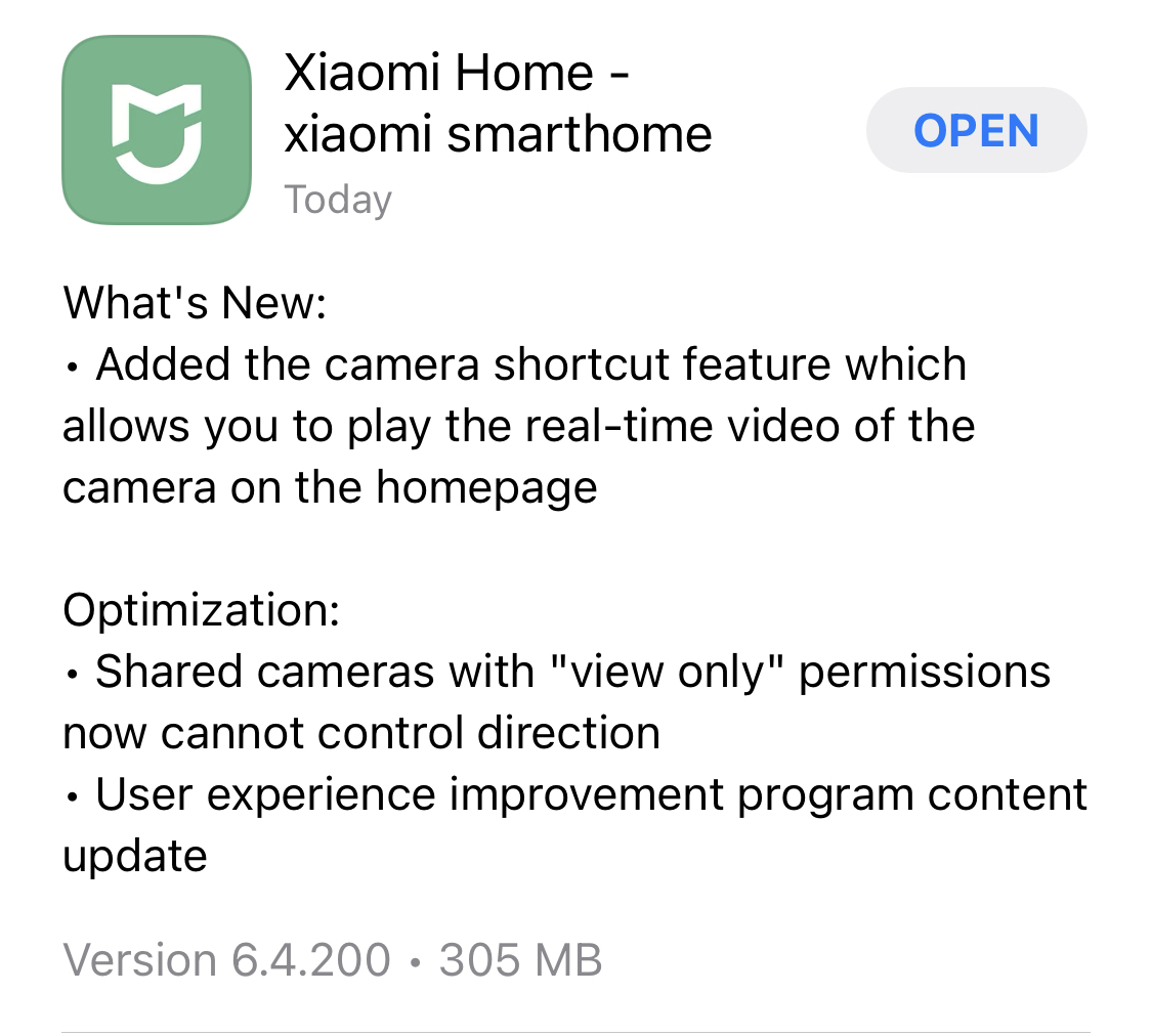

Hi guys, today there was an update to the Mi Home app on App Store (not sure about play store) and I was able to update the heater to the latest firmware (2.0.8.0005).

I've just successfully installed last firmware. I've unplugged the device (by chance), when i've plugged again, and the app has recognized the device, it has shown the message of available update, but this time it has begun the download, then install, and now the device is in the last firmware version.

EDIT: EVERYTHING WORKS WITH NEW FIRMWARE UPDATE! No problem anymore, at least for me.
