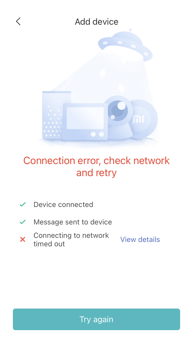

Hello. Did you solve the issue? I bought this heater during this weak and the app recognise it, but it can not connect with my wifi as you can see in the photo attached. What should I do?
I already reset the router, reinstall the app, etc
In Chinese mainland the app do not recognise the device, in Portugal it recognises but do not connect via wi-fi.

I had the same problem, and I temporary solved it by connecting the Heater to a Hotspot - the issue seems to be in the router settings, but I don't know which ones to change.
Hello, I also started connecting the heater to a hotspot, but after many attempts I created a guest network in my router with only WPA2 protection and the heater connected. So, the issue is in the security settings of the router.
I did just that and it solved the problem for me. Thank you.
