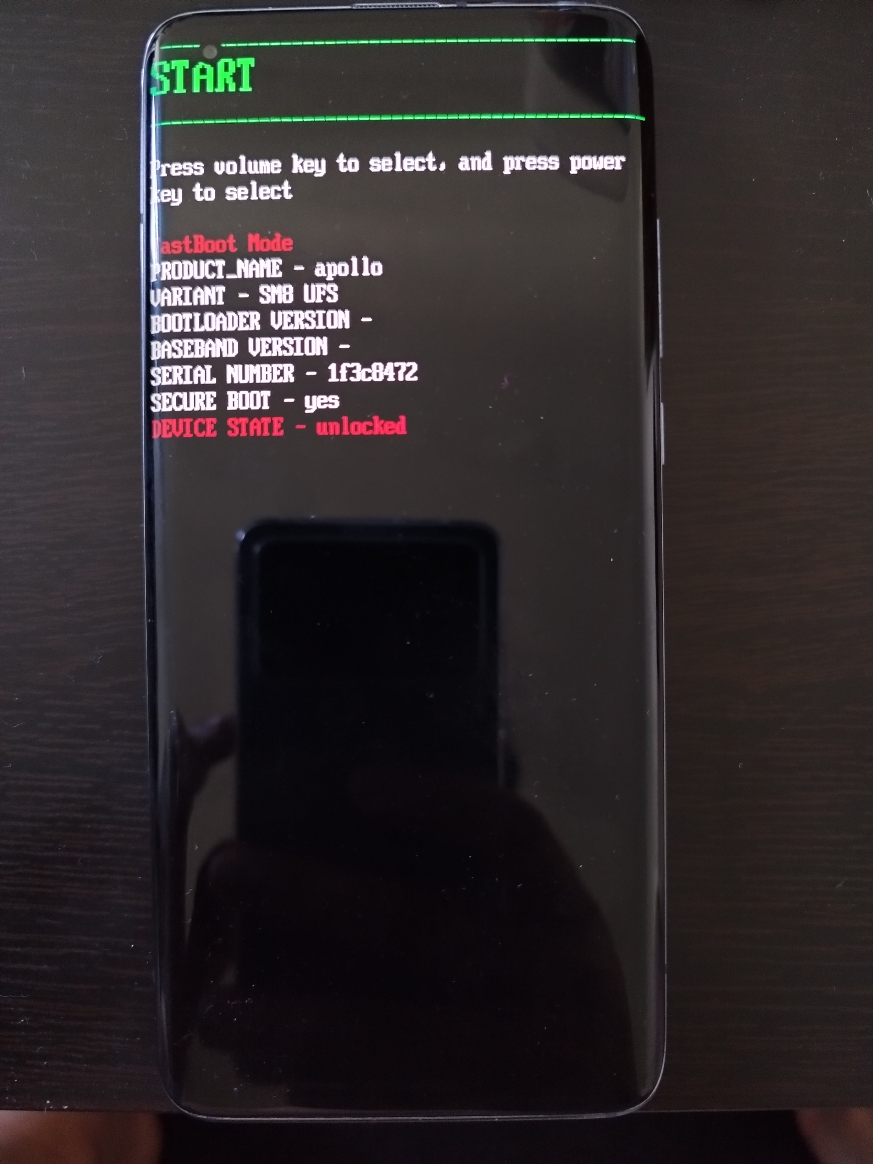

I missclicked and downloaded the ROM for Apollo which I think is the Redmi K30 and installed it on my device (yes I'm stupid and bypassed the missmatching device and ROM error, don't ask that question please)

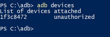

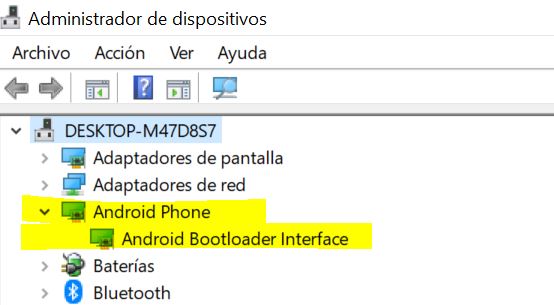

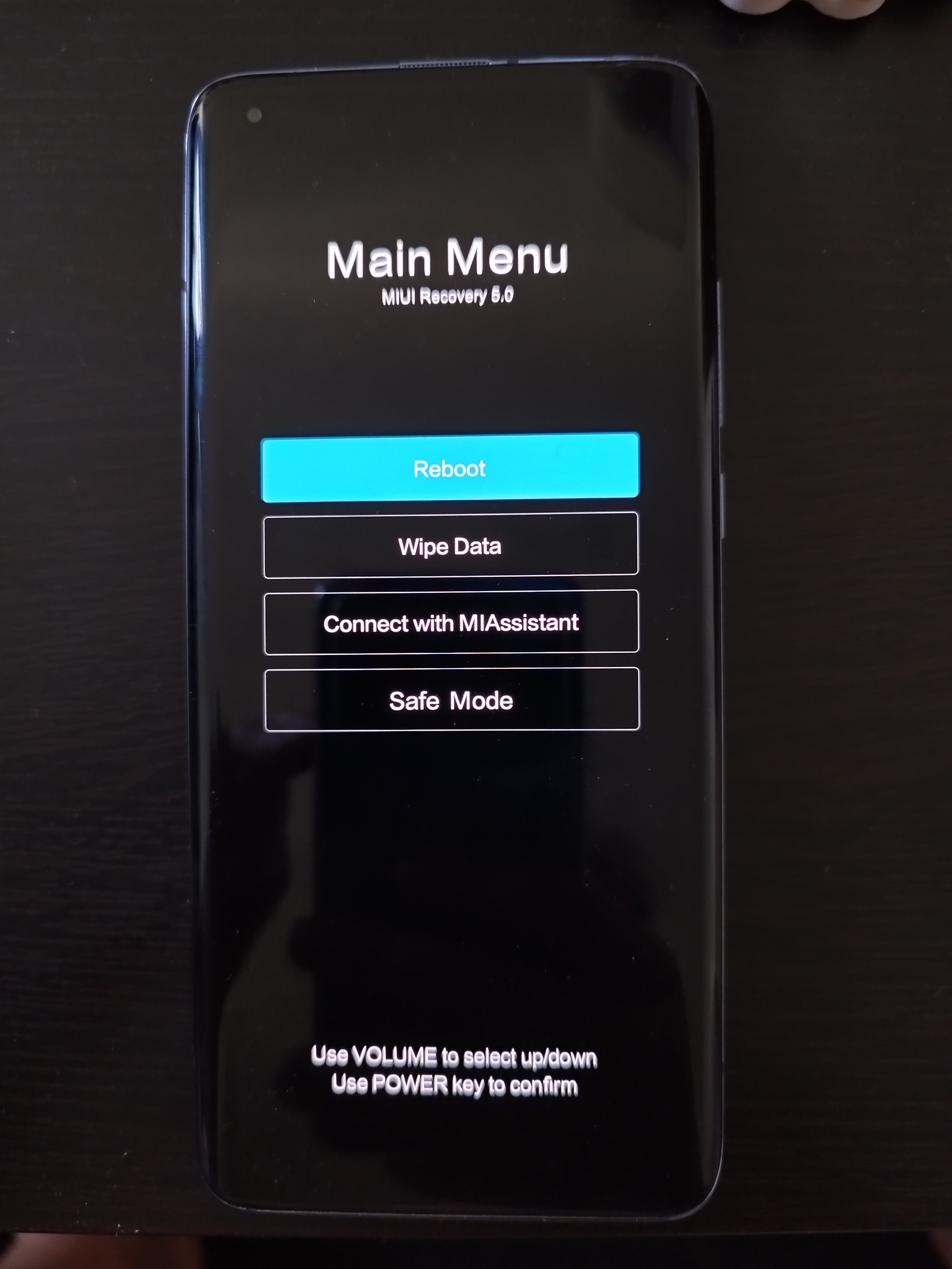

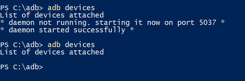

After that the phone start but only to fast boot or Mi Recovery, I can't install TWRP because fastboot doesn't detect the device but weirdly it does when is connected via MI recovery but shows Unauthorized next to the device number.

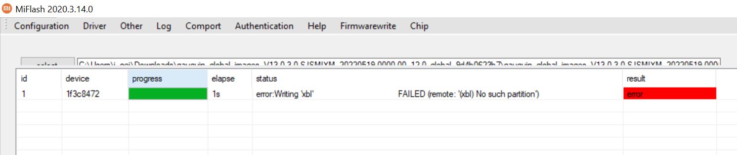

When I try to install the ROM for my phone it shows me the following error (Check the screenshot) I already tried the Global and the EEA. I also tried reinstalling ADB, drivers and all the stuff.

Did you try to install stock ROM with MiFlash Tool? I believe it does the proper partitioning before flashing.
Worth a try
Sent from my M2007J1SC using Tapatalk
Hi,can you enter in fastboot menu?If yes,you need to run "fasboot devices" here you need to see ur device name.If your device nam will appear you can try to install twrp or install latest Xiaomi.eu Stable ROM which it's a fastboot one....

try using the newest mi flash tool
also looking at the first picture, it looks like the folder name is called "gauguin" which is for mi10t lite
if you have a mi10, get the umi rom

Hey Mister you're the man! I was able to flash the Stock ROM and then update it via OTA. Now it's working flawlessly and I'm selling a MI 10 in Germany ;)
Thank you very much for your help!
