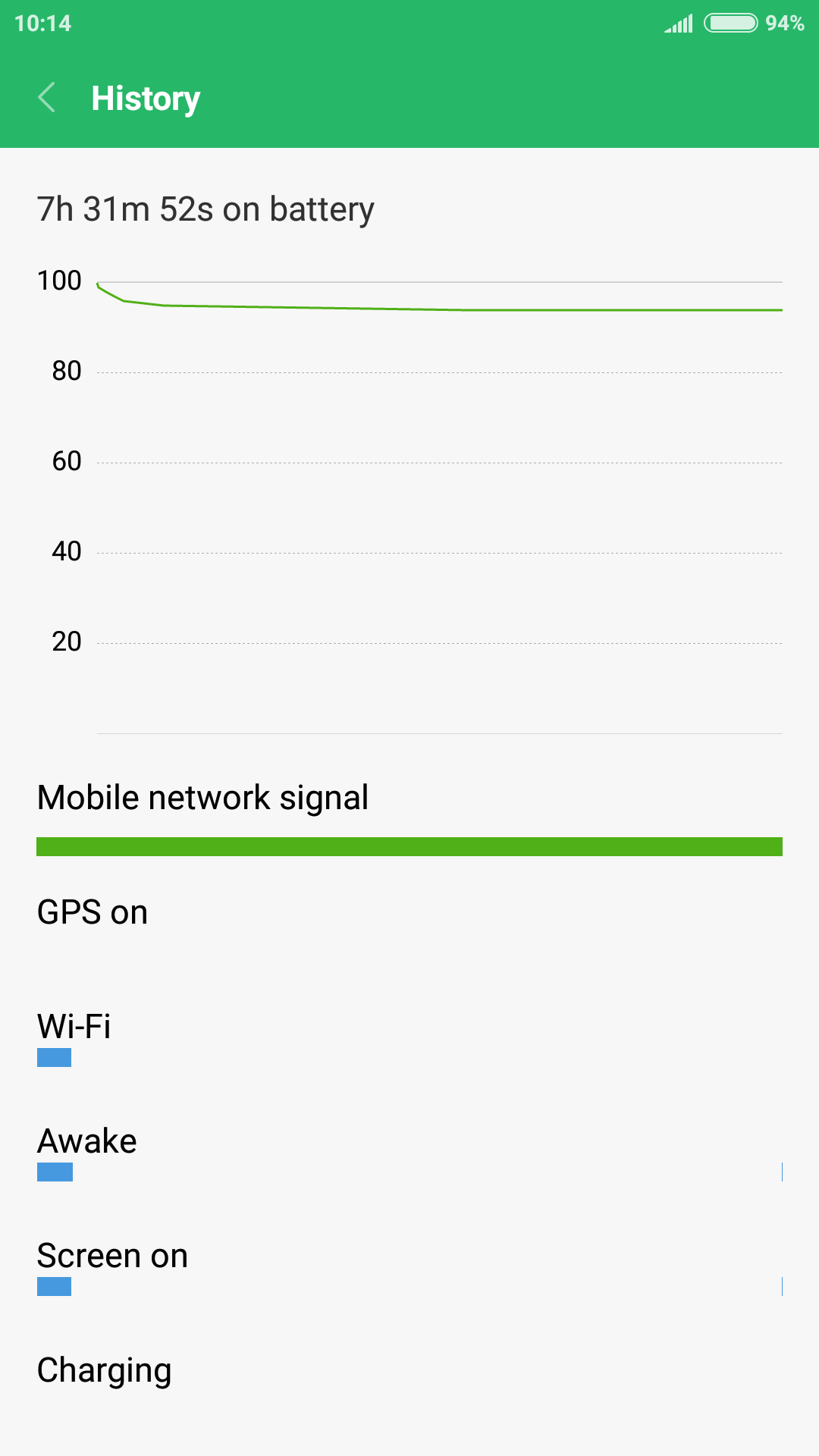

i downloaded Fix-Deep-Sleep.zip and flashed latest Xiaomi.EU rom. after that dont reboot to system, flashed Fix-Deep-Sleep.zip in the same way that i flash rom, and finally make Wipe Dalvik and Cache and reboot to system. No more battery drain.
One note more! Never use restart options when you long press power button. If you restart, deep sleap changes will not persist, and will cause long charging time (4+ hours). Every time use Power Off instead of restart. Finally check my battery stats will all things from before finished. I left my redmi pro on 96% battery. For 6-7 hours i get my phone on 94%. Only 2% lost for 6+ hours. That is not bad.

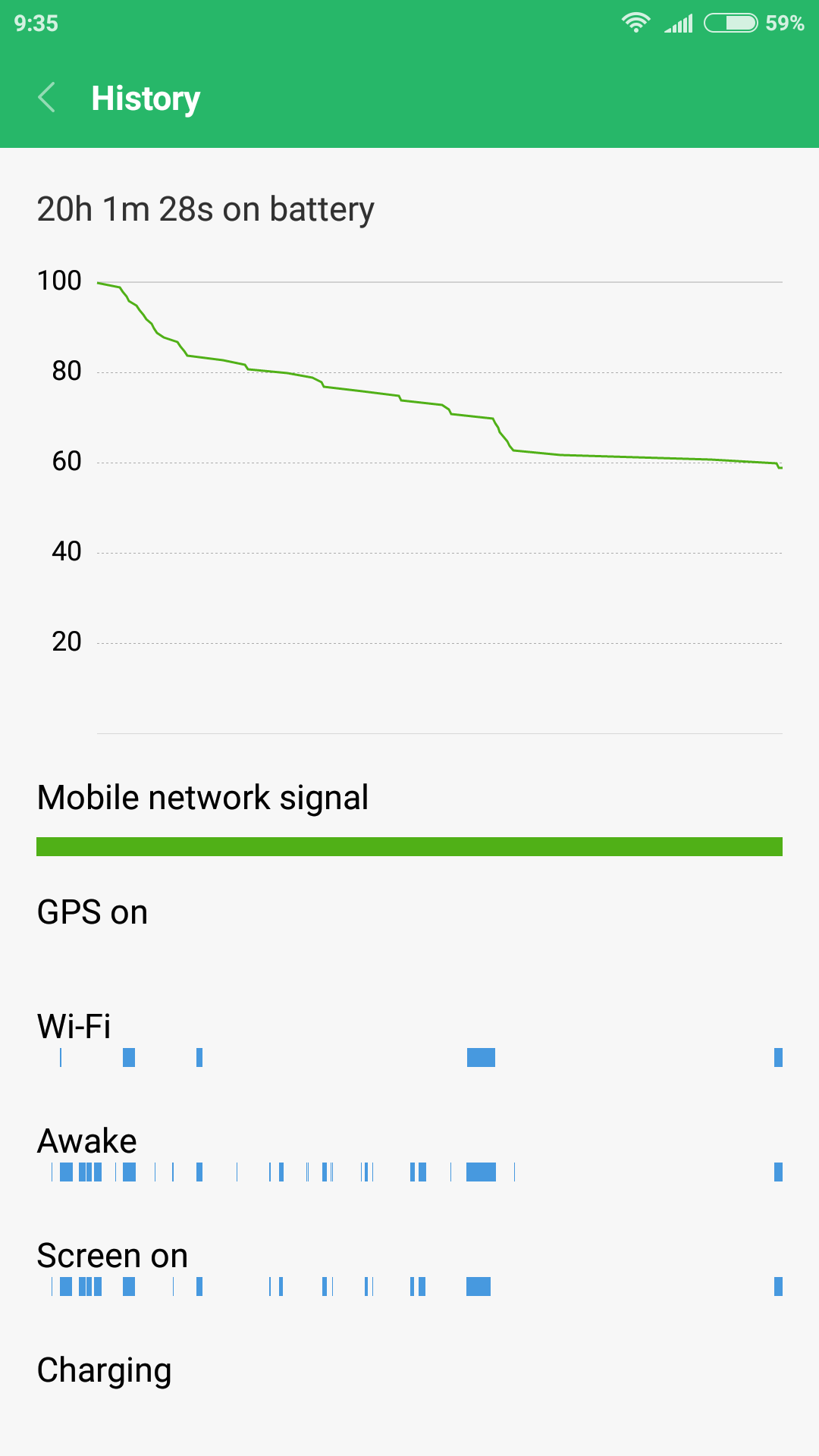

Switch to 2G network if you dont need 3G, and switch to 3G when you have need from them.
Yes you will restart when needed, but finally on end, will make turn off and then turn on the phone to avoid deep sleap problems. Check my battery in stand by. only 1-2% for 6 hours i lost.

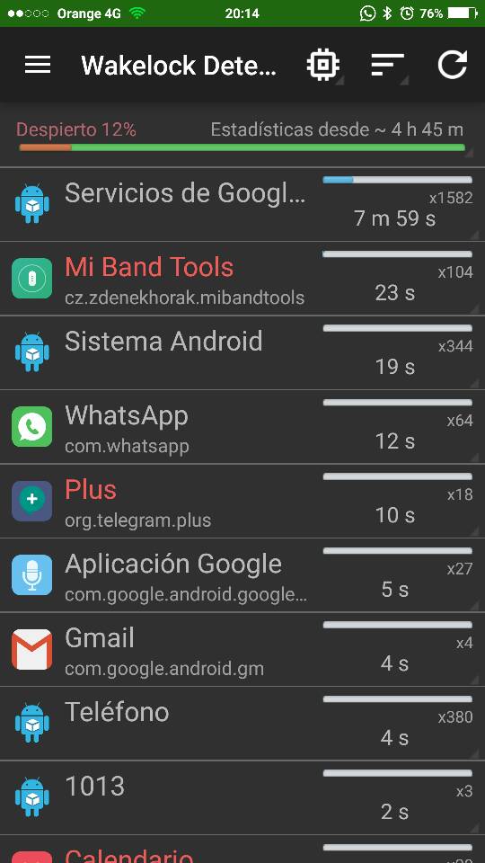

I've flash the fix and I did all the things that you said, but I always have the same problem with Google play services, my pro never goes to sleep because of that. I thought that this fix solved this problem...
How can the problem with Google services wakelock??? Thanks
