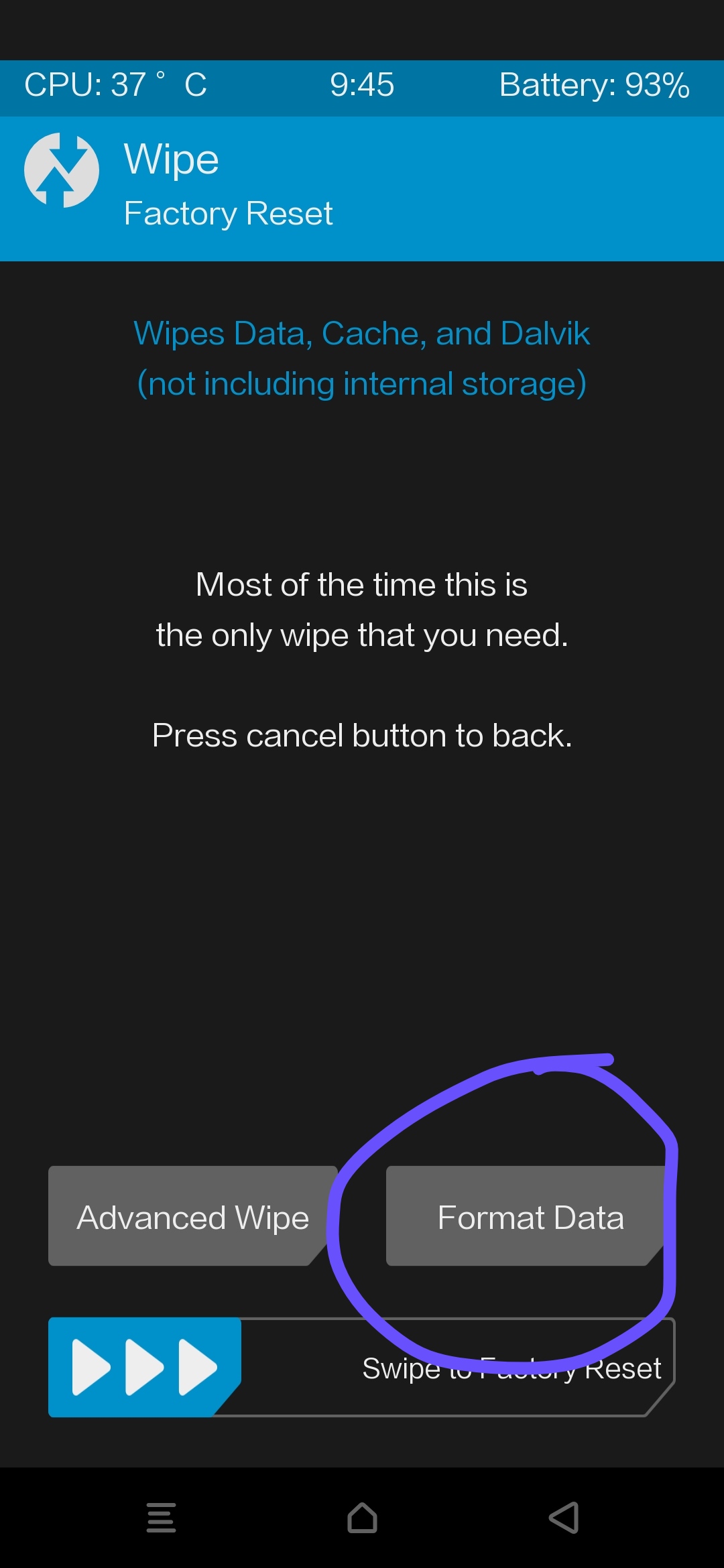

Antirollback error could from using the wrong fastboot rom. Your phone might use the EEA rom. The odd file names you are seeing is from not formatting Data. In twrp, go to wipe and click Format Data. You have to type yes to format.

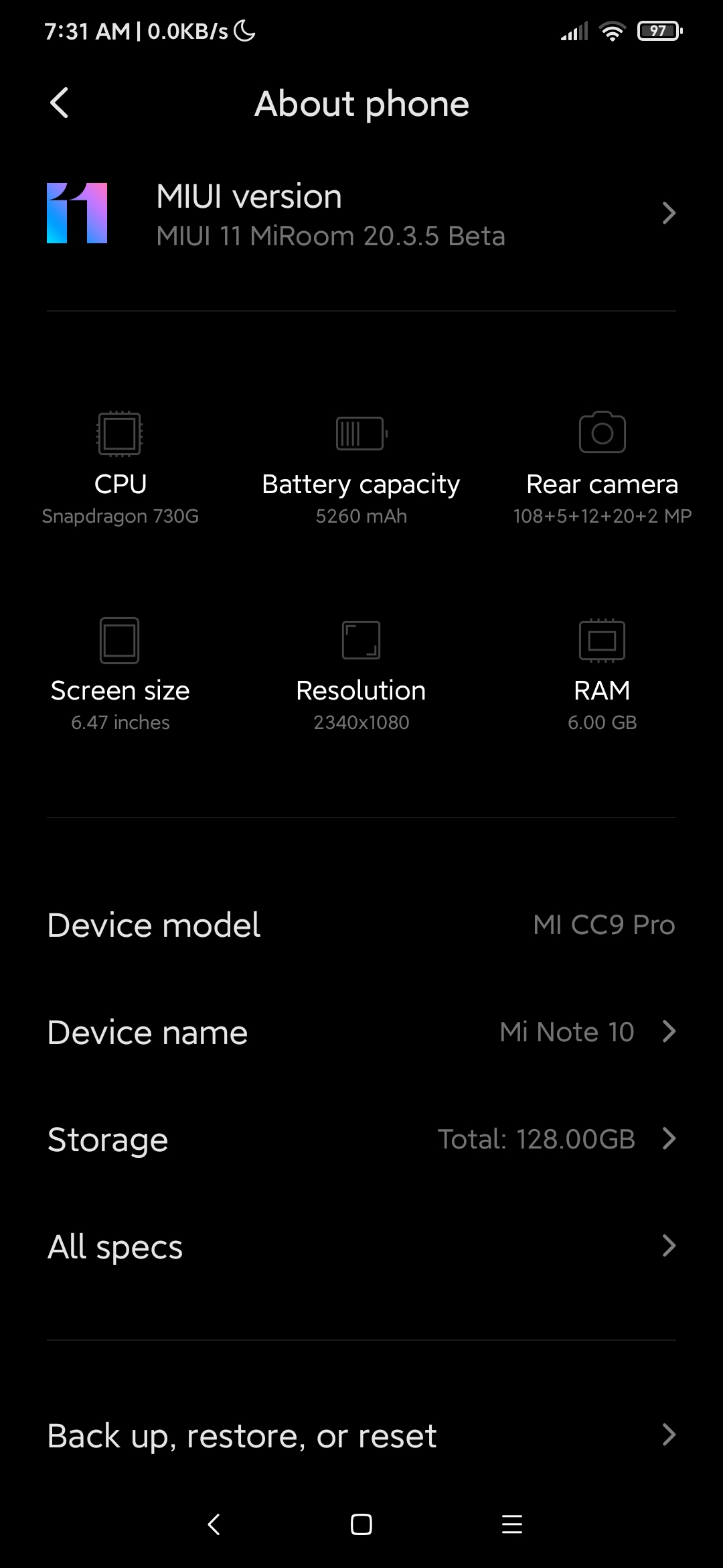

Just cleaned flashed MiRoom from sourceforge. Awesome rom, it's similar to xiaomi eu, but with more features.
