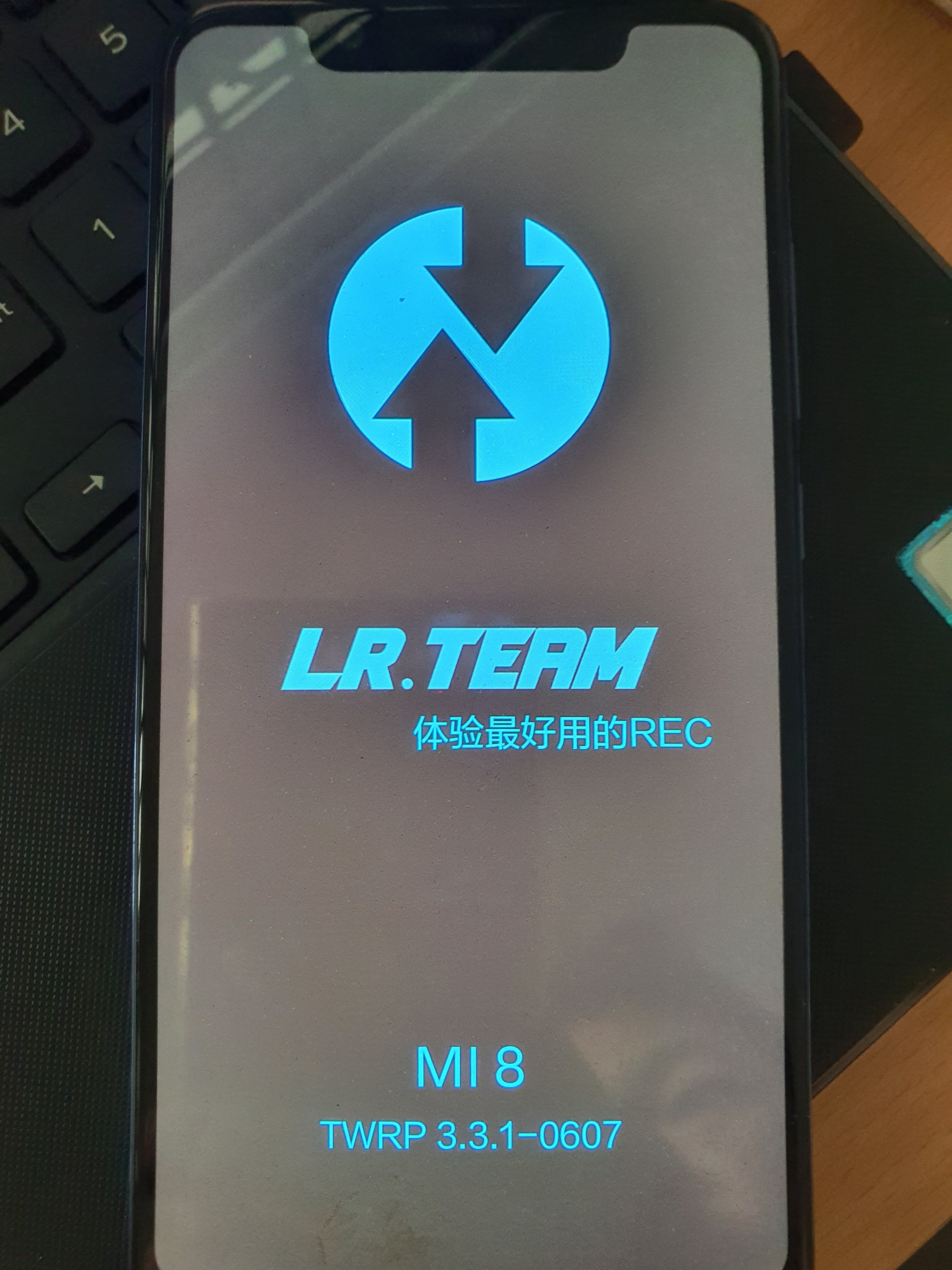

Thanks for the reply and info regarding big attachment.
This is the result I have after flash the lastest global stable ROM from MIUI. After flash and reboot, it stuck and the TWRP screen. My guess is I forgot to update the TWRP to latest version.
Now, I unable to install the latest TWRP for revert back to old ROm due to the phone stuck at TWRP screen, and TWRP not loading.

Not sure, but you have to format data in TWRP.
No TWRP access?
get the latest or one that will allow to install with the rom version you have already.

i had download the latest TWRP from https://eu.dl.twrp.me/dipper/twrp-3.6.1_9-0-dipper.img.html
i also had download the latest MIUI Global ROM from https://c.mi.com//miuidownload/detail?device=1700346
but now phone stuck at TRWP loading page, dont know how to flash the latest TRWP.
can show me the way?
you are in TWRP?
go to wipe/format and format data all with yes as confirmation and reboot to system.
that should work 100%. your data will deleted if any important save them via TWRP explorer.
thongkh
Jun 8, 2017
you are in TWRP?
phone now stuck at TWRP loading screen, not able to go in TWRP
You mean TWRP does not boot/open?
Try to boot it in fastboot.
Else refresh your phone flashing a Fastboot official rom via MIFLASH and restart installing TWRP.
I don`t see what you did, difficult for me to help you in blind mode.
