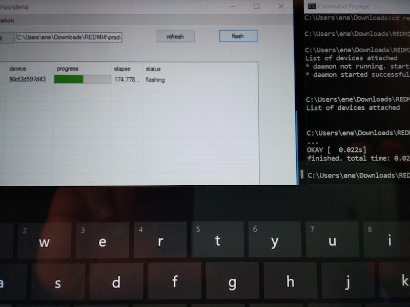

yes thats common. I flash teh latest xiaomi.eu weeklies on a regular base on my mi4c... unfortunately these first steps were faded memories allready! :p
its still flashing...fingers crossed!
well that i am aware but it is still flashing!
Something is totally wrong. Should take more than 300 seconds to flash. You were doing this on a tablet right? Leave it be for 3 or 4 more minutes and if not just try again or get a pc and try it there. Because on my pc it took 190 seconds.

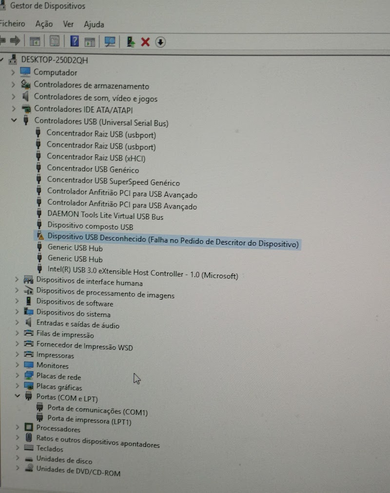

well i left it connected to the charger overnight again, and today i tried to plug it in 2 PCs, both not being recognized as qualcomm port...
Is it dead? can i still do something about it so i can go back to miflash tool?
