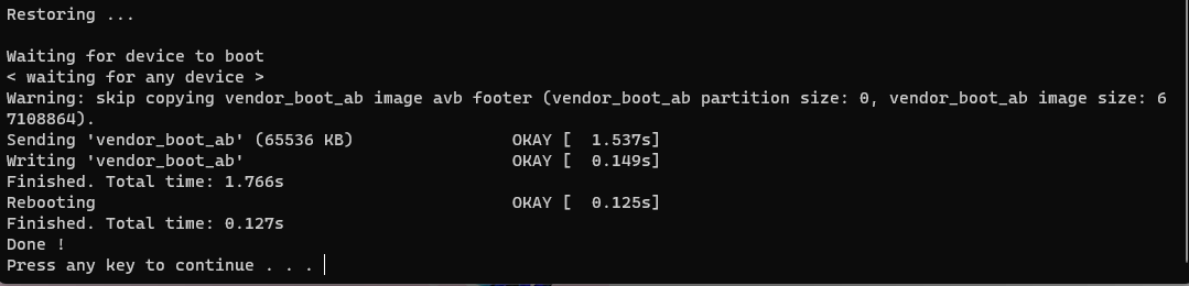

Hi follwoing your method after getting mi logo stuck in bootloop, where can i find these files
fastboot flash vendor_boot_ab hyperos_orig_vendor_boot.imgfastboot flash vbmeta_ab hyperos_orig_vbmeta.img
Is there a way you could send those to me.

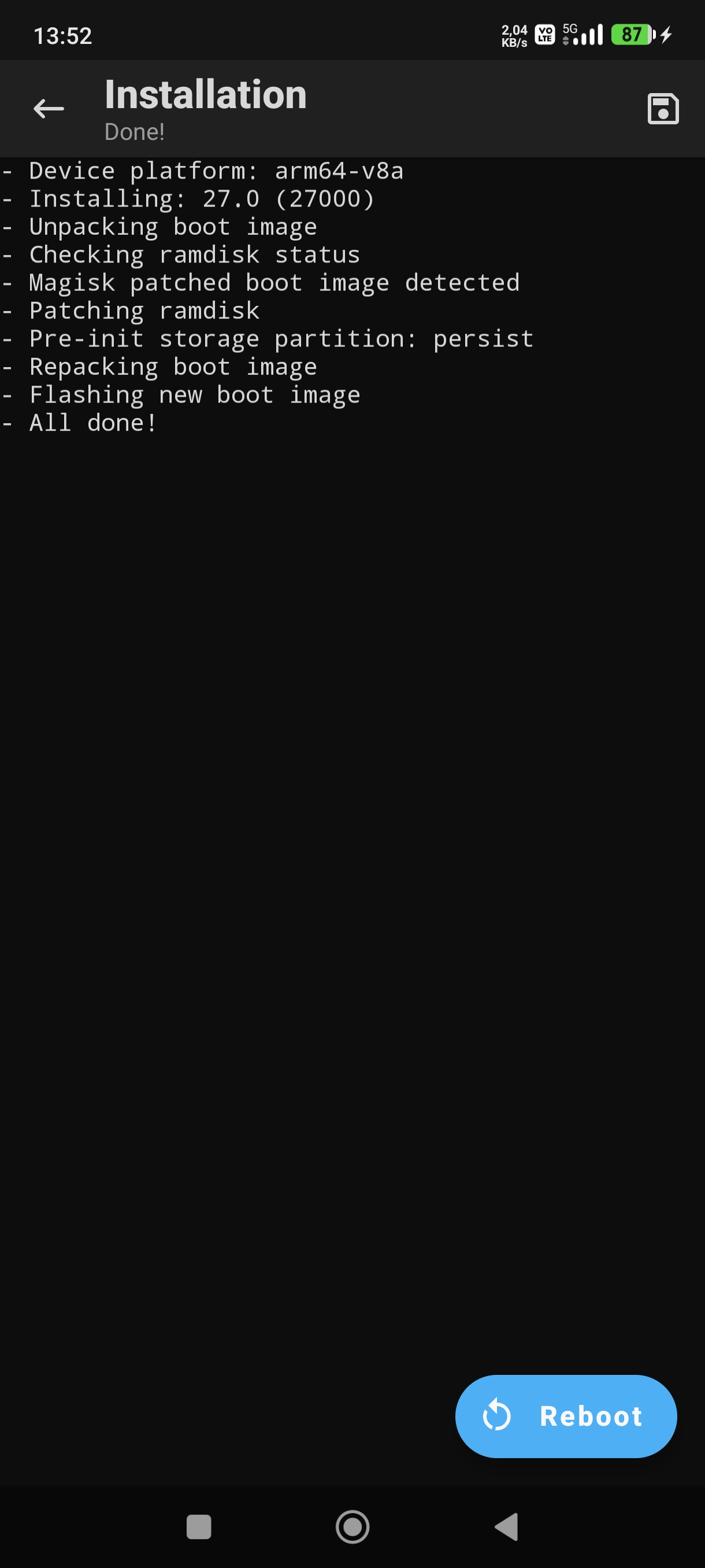

To root hyperOS systems it's necessary to patch init_boot to gain root without flashing new recovery !
Patch a original rom init_boot with magisk and flash it.
Flash original boot and vendor_boot also before reboot !
and use the *_ab to flash both slots !
Step1=Download the hyperos firmware which you are currently using
Step2= Extract it
Step3=Open Extracted Folder / Images Folder
Step4=Find init_boot.img and copy it to the internal storage
Step5=Patch the copied init_boot.img in Magisk
Step6=Move the patched init_boot.img to pc and open Platform tool folder (cmd prompt)
Step7=Enable USB Debugging from Developer Option then switch off the device and put the device into fastboot mode(press power +volume down button)
Step8= After pc detect the device , type this command
fastboot flash init_boot_ab magiskpatch.img
Step9=Reboot the device
Step10=Open Magisk (if the required additional setup promp come , click on ok and reboot the device)

[EDIT] Added od 1.5.2024 only for HyperOS, Root without flashing non usefull recovery !
ROOT For HyperOS :
Step2= Extract the ROM
fastboot flash init_boot_ab patchedmagiskfile
Root Sucessfully installed

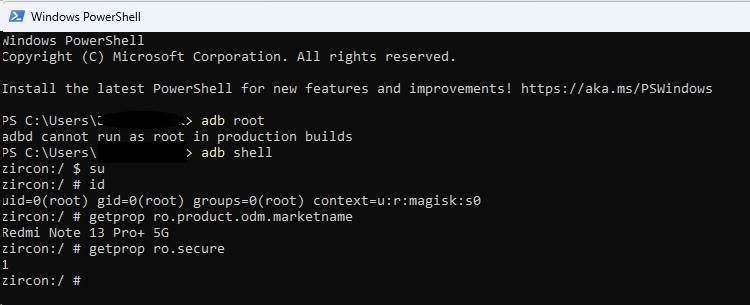

Active magisk "root" is gained by patched init_boot and further on by magisk persist.img ... !
Root can be also obtained by apatch by our device !

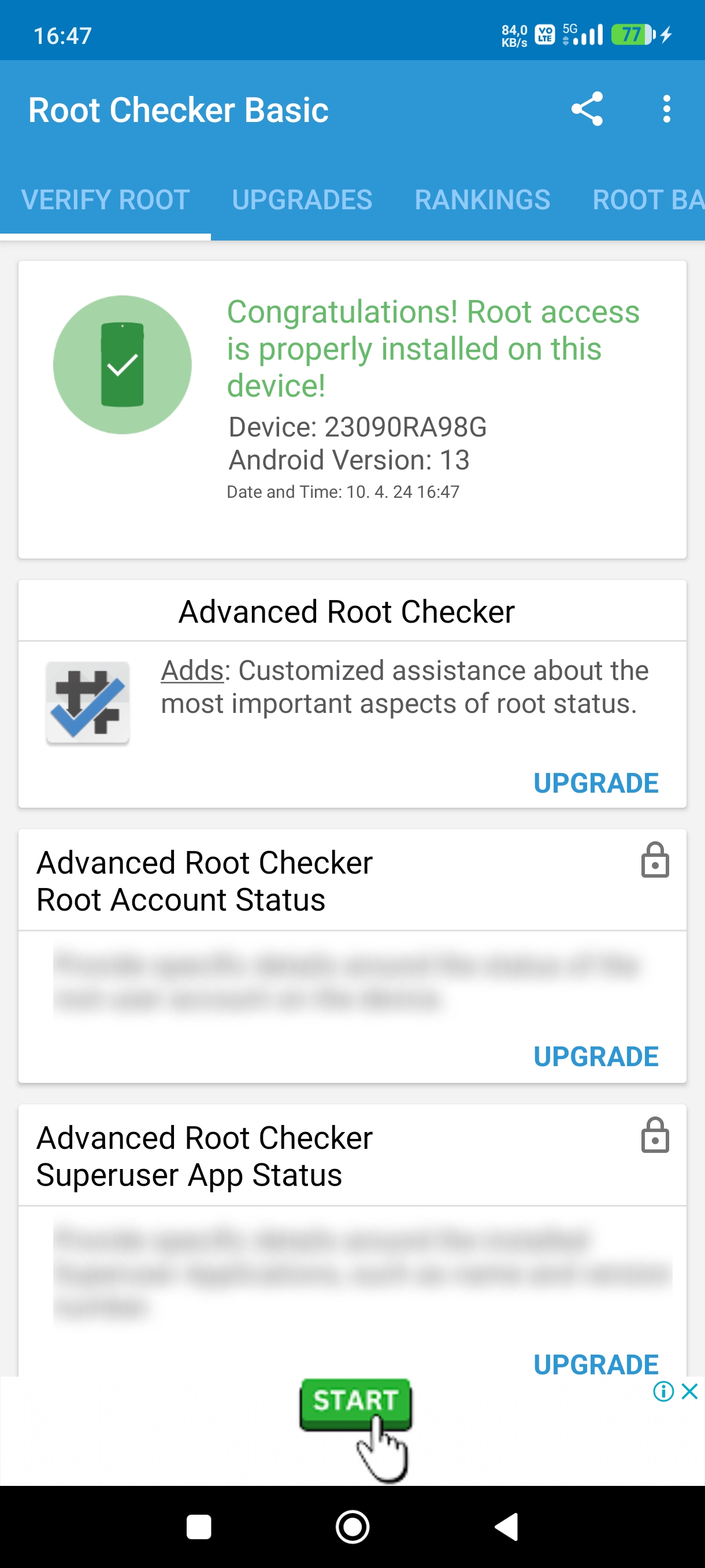

Full tested with 1.0.2.0.UNOMIXM HyperOS version, It remains to be clarified in the steps that you have to unlock the bootloader, with MiUnlockTool python the process is made easier than with the official tool, and it is not paid
