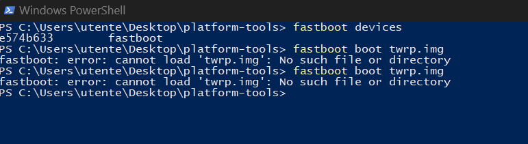

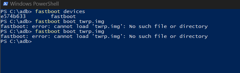

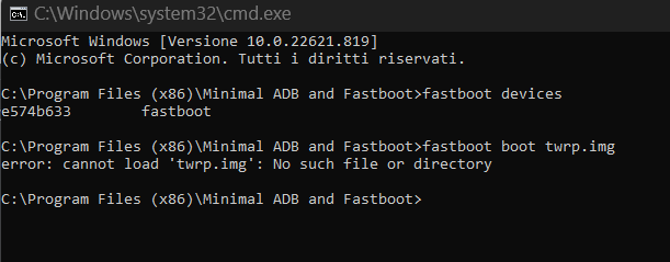

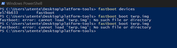

Hi I'm trying to flash the twrp, but when I run the fastboot boot twrp.img command it gives me this error:
Ho usato la 3.6.2!

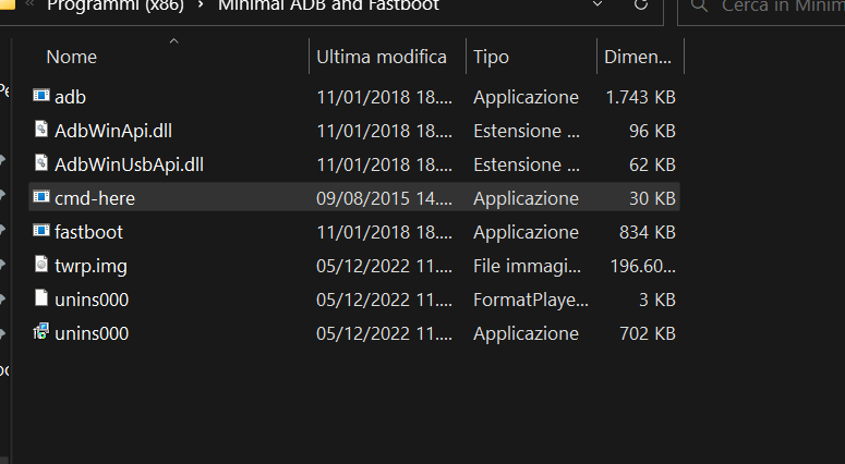

Ho usato la 3.6.2!
Is the twrp.img file in the current directory ?
You show us the message that the file cannot be found, but you don't give elements proving that it is present.

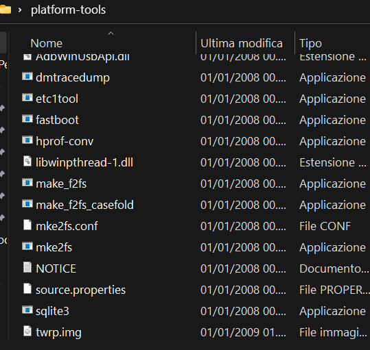

yes I put the twrp.img file in the related folders

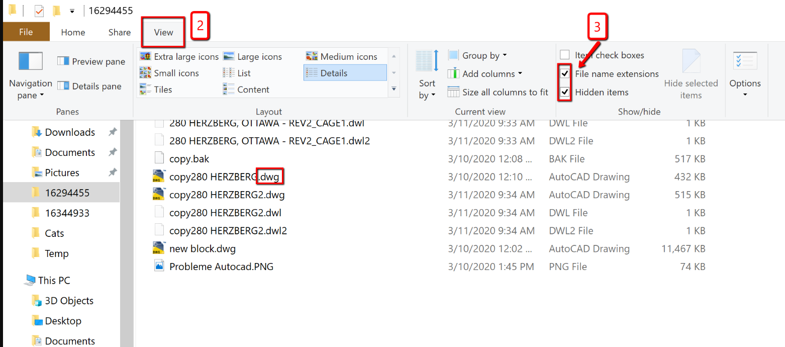

You have a wrongly named file at "twrp.img.img".
Delete ".img"
This is because you don't have file name extensions enabled on your PC
