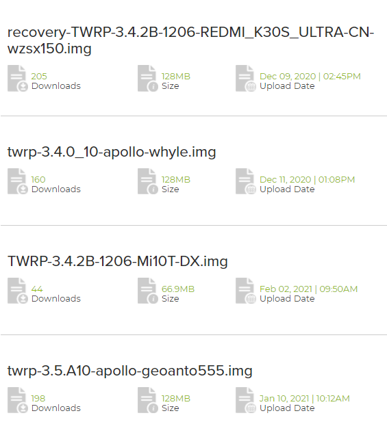

Just found it...
But which version?

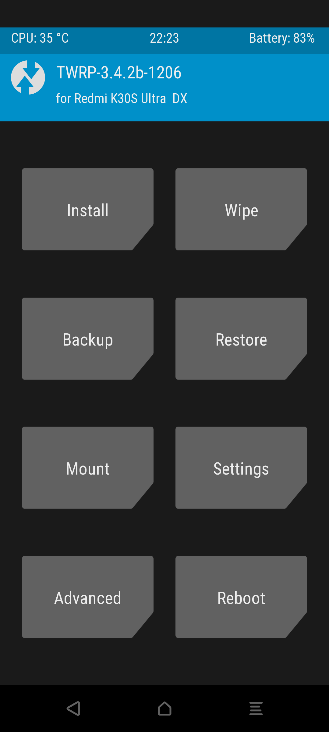

I had errors while formatting data on twrp 3.5.0, read on a Russian forum to use the twrp 3.4.2 beta and format data 5 times. Errors are gone, no longer getting rebooted to recovery. I can update ROM from twrp.

Hello. Has anybody tried this TWRP on your Mi 10T/10T Pro? How does it compare to whyle's?
36776
i used ...is more stable ....but asking password decrypt if restart to the recovery

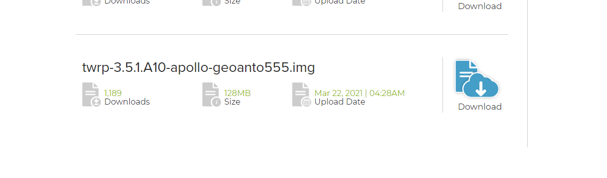

This.
Although it says "A10", it runs perfectly on Android 11.
Running Xiaomi.EU Stable 12.5.1.0 on my Mi 10T Pro and it's even smoother than Global. No bugs. SafetyNet passes. Banking apps work just fine. Google Play certified. Netflix is Widevine L1.
This.
