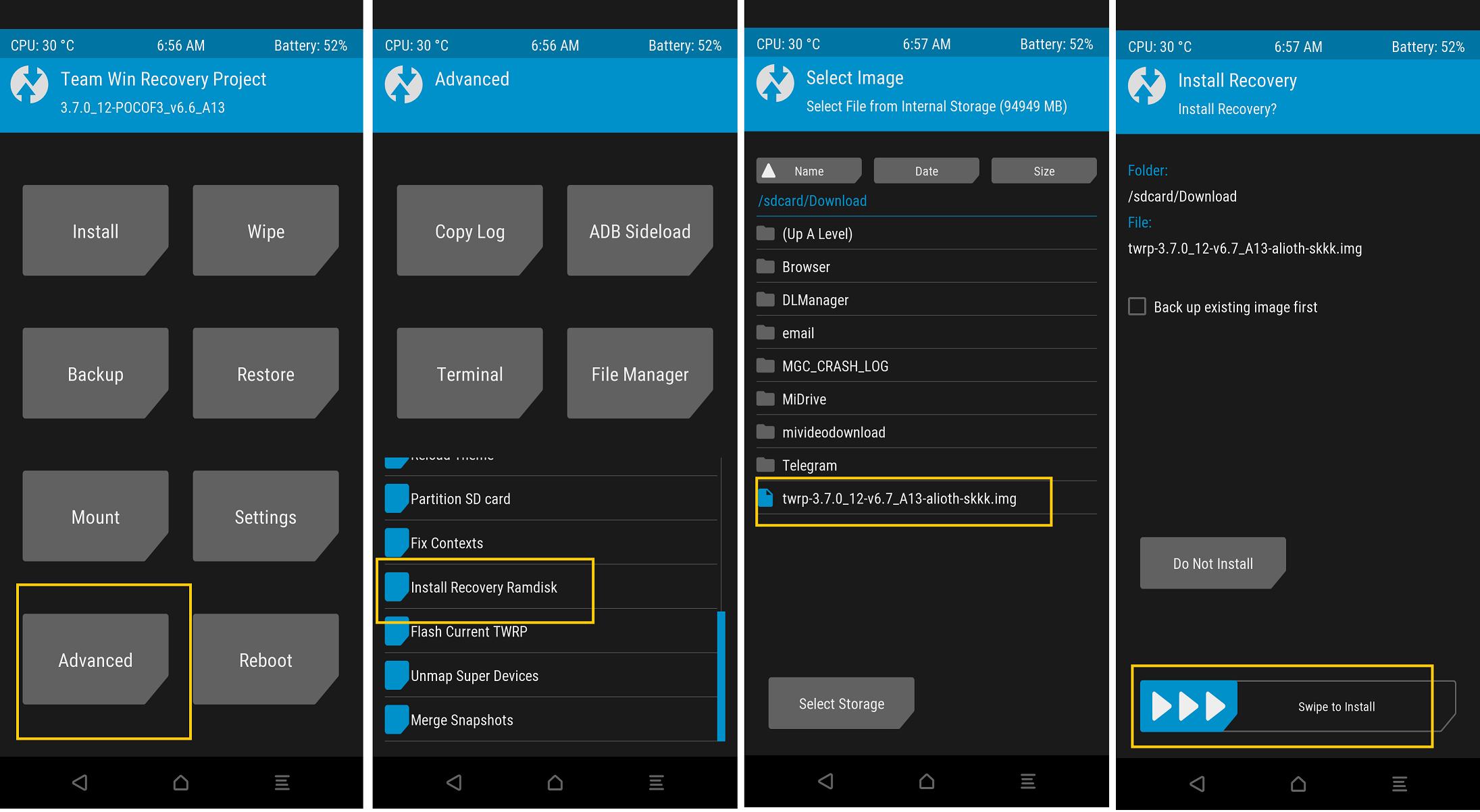

hello, I need help to install twrp on renoir
I just got back from this thread and I don’t know how to permanently install twrp
(A/B devices)
I managed to launch it with the command
fastboot boot twrp.img
but from this step, I can not find the file to select in "advanced settings --> install recovery ramdisk", can I have some explanations?
TWRP must be able to decrypt the storage. TWRP must ask for password/PIN/pattern.
And for renoir, TWRP for android 13 is not available.
Therefore, this procedure will not work for you.
- Put the TWRP file on your phone
- Run TWRP
- Install TWRP to Ramdisk

so i need to dowload the image on my phone ? Or won’t it work on renoir ?
thank you for your answer
Installing TWRP it will work but TWRP won't work on Android 13. It can't decrypt the data partition. You won't see the files in TWRP.

Unofficial but well-tested TWRP for android 12/13 is now available here:
Thanks for the info friend, I'll surely try it
