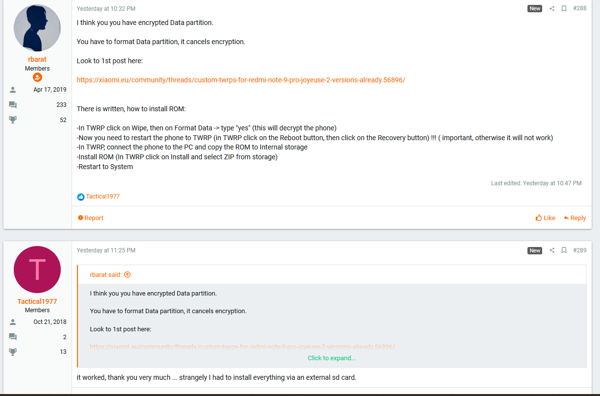

-it's not wipe to be done!
-You must FORMAT DATA in twrp wipe section. and nothing else!

i had the same problem as you (@Tactical1977)
i tried to follow these steps suggested by (@rbarat):
-In TWRP click on Wipe, then on Format Data -> type "yes" (this will decrypt the phone)
-Now you need to restart the phone to TWRP (in TWRP click on the Reboot button, then click on the Recovery button) !!! (important, otherwise it will not work)
-In TWRP, connect the phone to the PC and copy the ROM to Internal storage
-Install ROM (In TWRP click on Install and select ZIP from storage)
-Restart to System

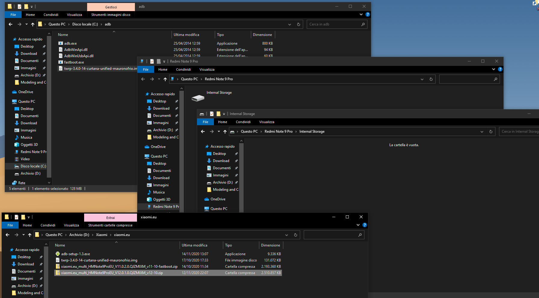

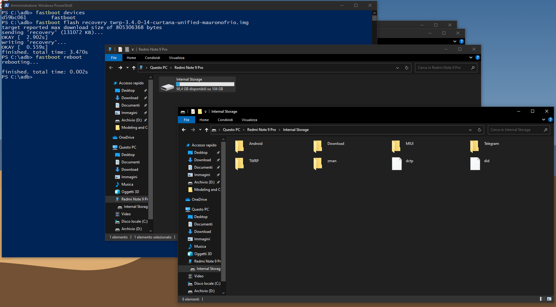

But when I connect the phone after reboot to copy the rom, my pc detects the phone but with unknown memory and therefore does not make me copy into the rom.
how can I do?
32859
the photo refers to the phone just flashed with miflash.
Unknown memory in the sense that I no longer see how many giga are available and also by opening internal storage there are no more folders and I cannot copy any file inside.
i have developer options active, usb debugging, install via usb, usb debugging (security settings) active.
in the pc I have installed adb version 1.3, the 1.4.3 I can't install it

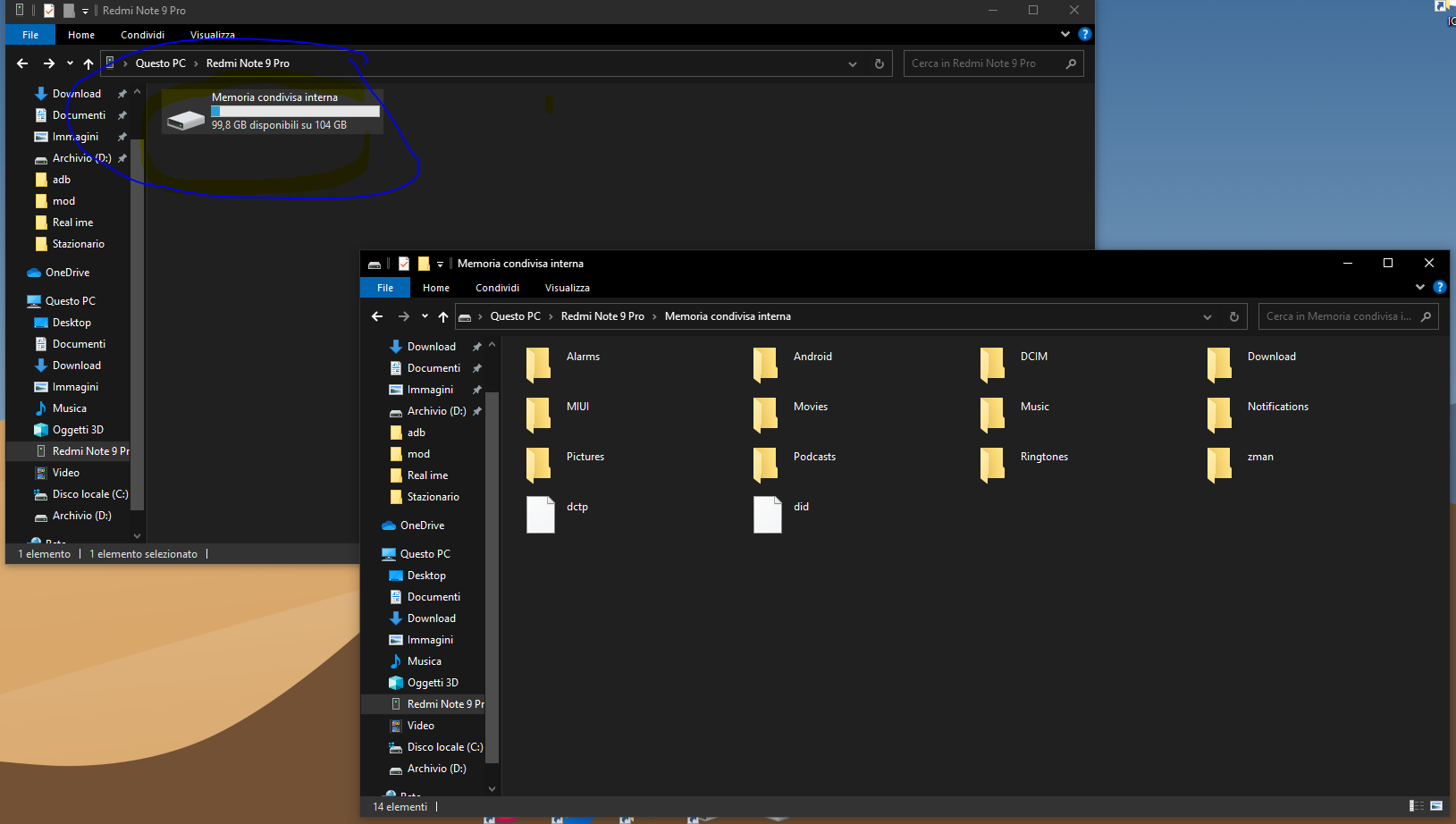

As I can see here on your screenshot, your phone is recognized by the PC. So just copy the ROM-zip on it and install it with TWRP.
the last screen was done after flashing the original rom with miflash as after Format Data -> type "yes" the phone could not find anything inside the install folder.

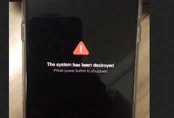

tonight I tried again:
installed twrp -> see internal memory
boot in twrp- -> wipe -> format data (bottom) -> back -> back -> reboot button -> recovery
32866
on reboot I have this situation and I can't copy the rom inside the internal memory:
32867
what do you recommend?
is there an alternative?
I've flashed with miflash like 14 times since yesterday -.-'

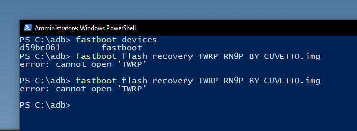

hello @Poney70 , can I always install this recovery with power shell -> adb -> fastboot device -> fastboot flash recovery recovery-TWRP-3.4.1B-0530-REDMI_NOTE9S-CN-wzsx150.img -> fastboot reboot?

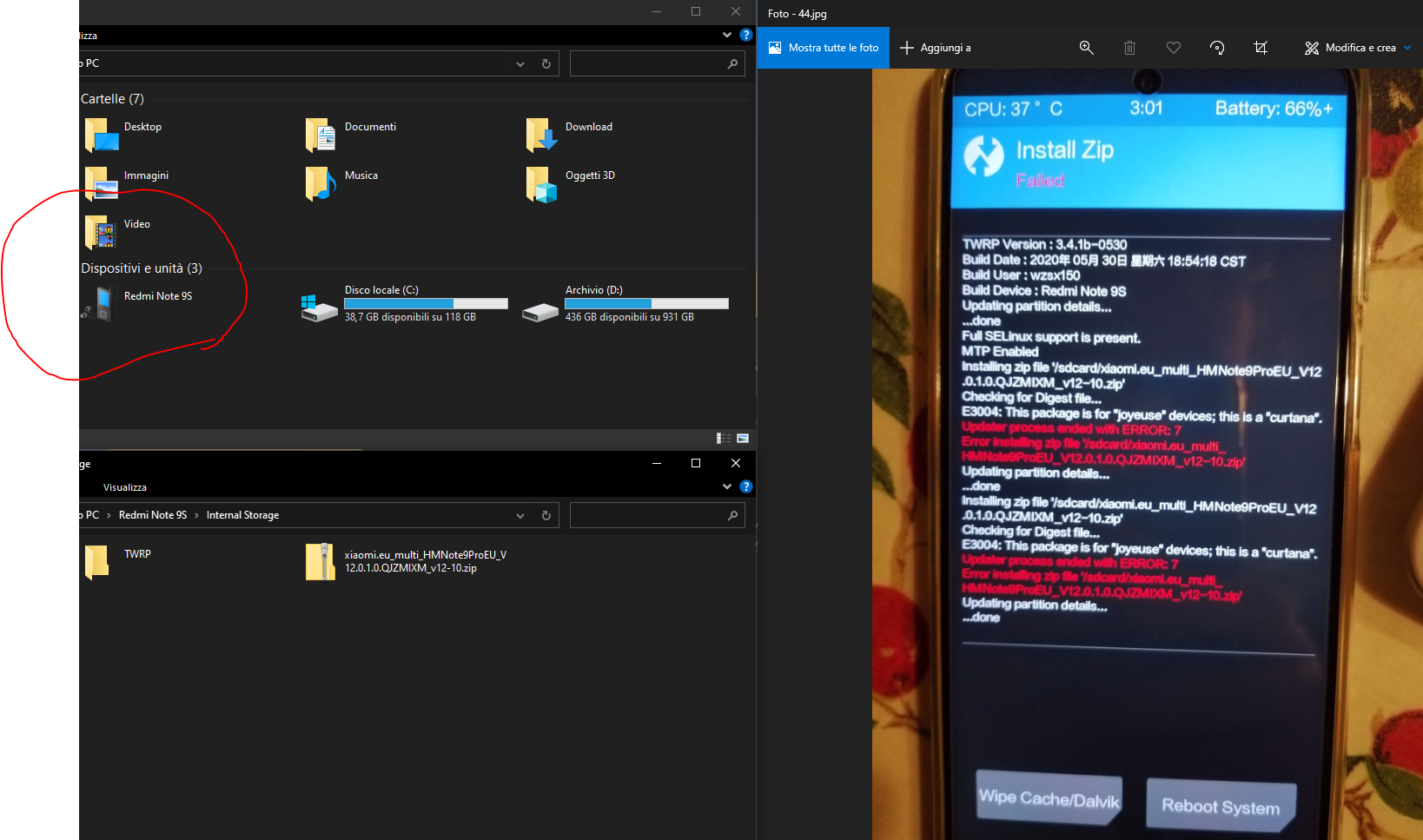

now it reads me the internal memory, but "note 9s" while mine is "note 9 pro" (joyeuse)?
in fact for this name change I get an error "ERROR: 7 ...." as soon as I install.
I have seen that there is a method to correct it, but I wonder if doing so is like retrograde my phone?
