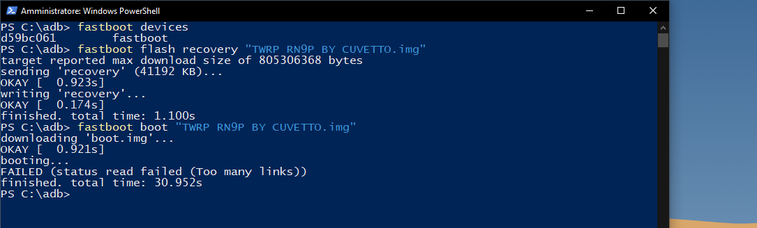

Boot to TWRP... after having successfully installed twrp by cuvetto and doing fastboot reboot
F Fake email! Nov 17, 2020 #26 Poney70 said: Boot to TWRP... Click to expand... after having successfully installed twrp by cuvetto and doing fastboot reboot
Poney70 Donator Oct 3, 2019 5,490 337 Nov 17, 2020 #27 mariorui said: after having successfully installed twrp by cuvetto and doing fastboot reboot Click to expand... fastboot boot "TWRP RN9P BY CUVETTO.img" - It should work.
F Fake email! Nov 17, 2020 #28 ok now i can try. but what about video in #25? ps: I apologize if posting things I don't respect some rules.
Poney70 Donator Oct 3, 2019 5,490 337 Nov 17, 2020 #30 mariorui said: @Poney70 once again: " THE SYSTEM HAS BEEN DESTROYED" Click to expand... Try to plug your USB cable in an another USB port of your computer then retry fastboot boot command. Or hold "Vol+" and "Power" buttons of your phone simultaneously until you see TWRP screen.
Poney70 Donator Oct 3, 2019 5,490 337 Nov 18, 2020 #32 mariorui said: finally with PitchBlack recovery projet i managed to install !!! Click to expand... Wow! Good to know!
