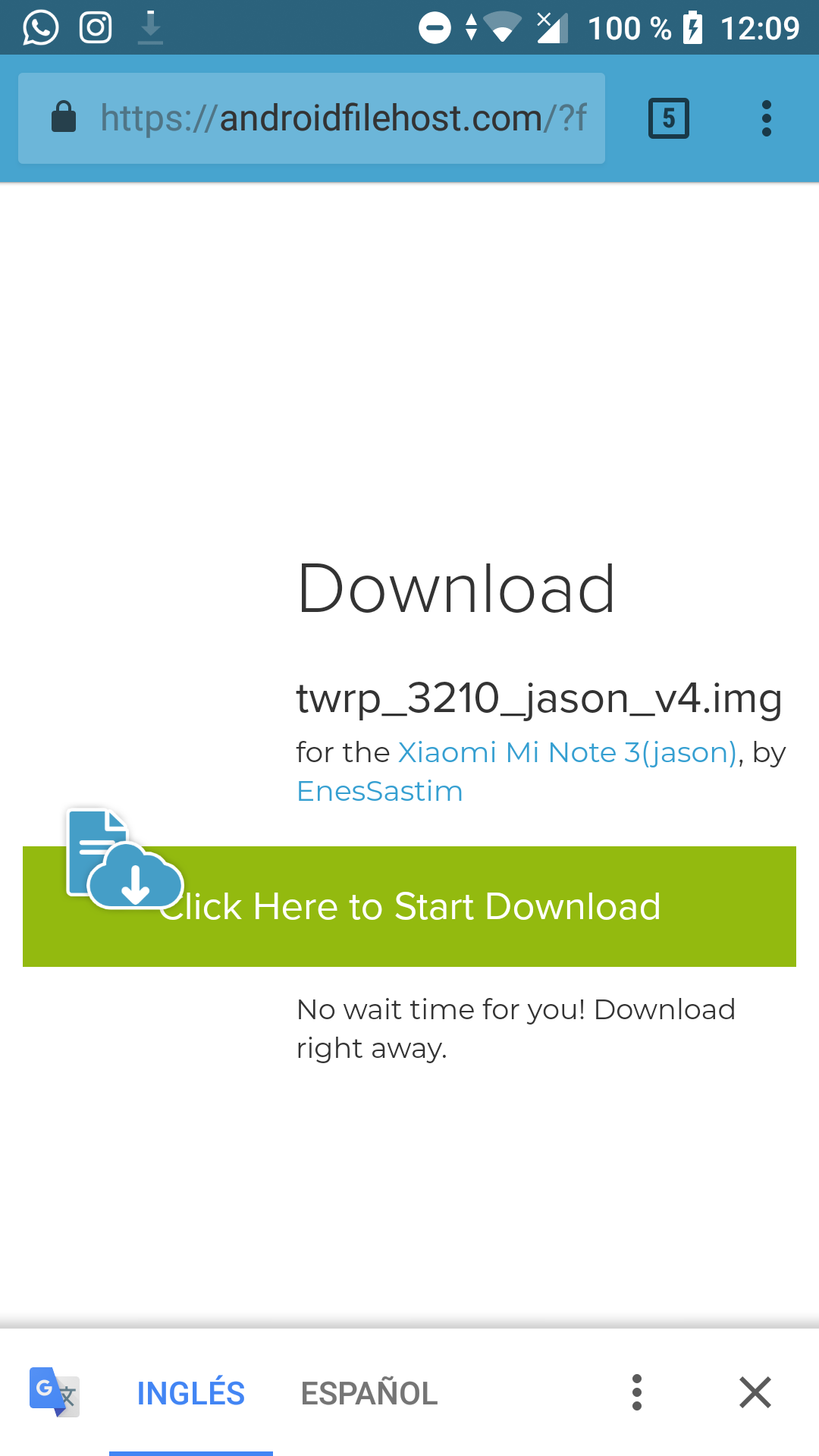

I installed miui 10 xiaomi.eu and all ok but when I went to enter again in twrp I skipped the recovery stock. What I can do?
this one i found in htcmania
I have rebooted miui 10 again with these twrp and they are not saved. The stock recovery is still booting. I'm desperate.
