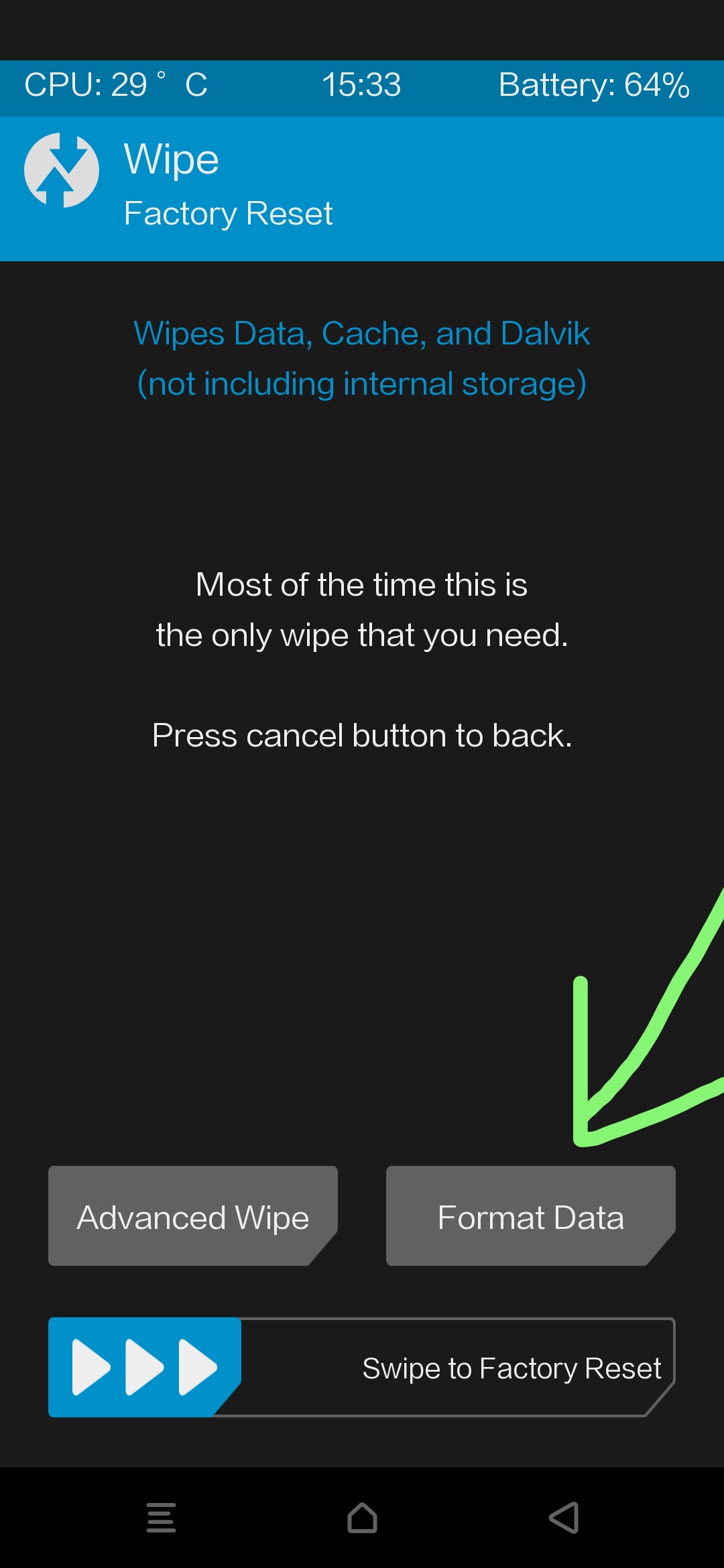

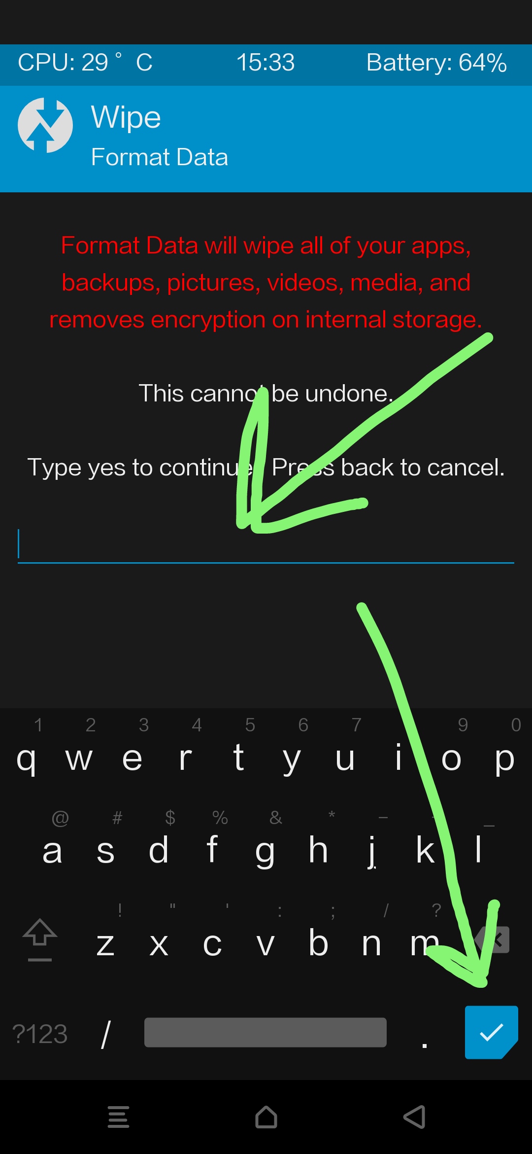

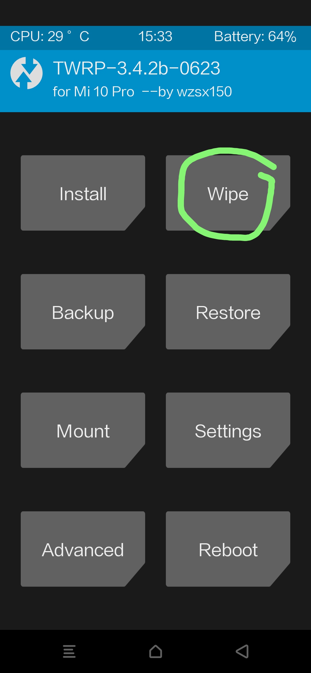

Did you format data after flash? You must when changing branches due to possible partition differences. It's the data format that you have to type yes in agreement. It's in the wipe menu of twrp.
I try to move from stable to weekly but i can not format data using twrp i dont know how to do it
Inside the wipe menu of twrp is a format data option. Use this and type yes when asked to confirm. See attached screenshot
Yes, you need to format your data first. Then reboot to preferably to Recovery, but Fastboot or TWRP. If you reboot to fastboot, you will need to run the <fastboot boot twrp.img> again. Now copy the rom from your PC to your device. Select <INSTALL> locate your rom and flash it. When it is done flashing, reboot to system. The first install may take upwards of 10 minutes, so be patient and wait!
