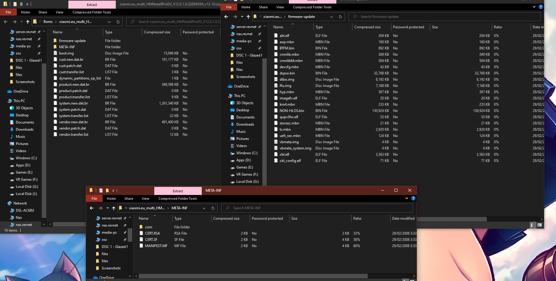

Due to the fact that the authors of the latest local MIUI.EU ROM ( xiaomi.eu_multi_HMNote9ProEU_V12.0.1.0.QJZMIXM_v12-10.zip ) included in ROM installation file TWRP from Mauronofrio , I recommend to continue to use this TWRP.
I downloaded and installed 12.0.1 from that same source, and just looking at the contents of the zip again just now, I cannot see a recovery image within it.
So just curious, do you have a source for this information? I've never seen a flashable zip, (aside from a custom recovery), with an embedded recovery so would like to know why it's not clearly identifiable.

You cant load TWRP 3.4.0-14 by mauronofrio from 'fastboot boot twrp' it just hangs at a corrupted screen still in fastboot.
3: multilanguage version - made by Cuvetto - does boot from 'fastboot boot twrp'
I could install from the multilanguage Cuvetto version.
Code:
Doesn't boot
D:\platform-tools>fastboot boot twrp-3.4.0-14-curtana-unified-mauronofrio.img
Sending 'boot.img' (131072 KB)                     OKAY [  2.777s]
Booting                                            OKAY [  5.085s]
Finished. Total time: 7.939s
Does boot
D:\platform-tools>fastboot boot TWRP-RN9P-BY-CUVETTO.img
Sending 'boot.img' (41192 KB)                      OKAY [  0.875s]
Finished. Total time: 5.993s
The recovery included with Xiaomi 12 "xiaomi.eu_multi_HMNote9ProEU_V12.0.1.0.QJZMIXM_v12-10.zip" is Mi-Recovery 3.0 which I get when I reboot to recovery, so eu v12 includes stock or or doesn't include a recovery in its image (there is no file matching the mauronofrio twrp size in the zip) as it never flashed the twrp rbarat says was included, he needs to fix up misinformation.
If I'm not mistaken, I had a Russian TWRP on my phone. After installing the ROM, I suddenly had mauronofrio TWRP there.
But I can be wrong, so I deleted my previous post.
