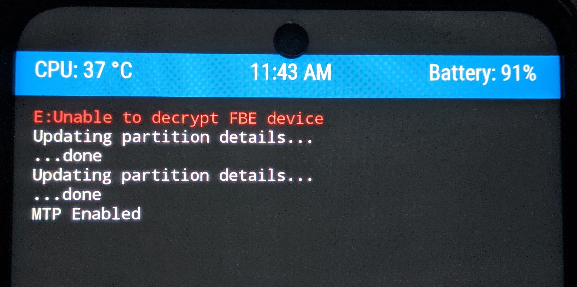

I recently installed TWRP-3.4.1B-0530-joyeuse-fix.
Then I installed twrp-3.4.0-14-curtana-unified-mauronofrio.img.
After rebooting from twrp to twrp, the red line is displayed in twrp.
See the photo under the spoiler.
Is this a bug or can I ignore it?

Just use orange fox twrp, its beta, but its very stable, everythingh works just fine.

It doesn't happen to me. Did you install it correctly? Did you format the Data?
