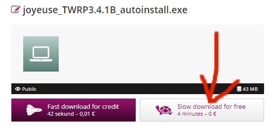

Now I've tried it, download works.
To download you have to click on the button as shown in the picture.

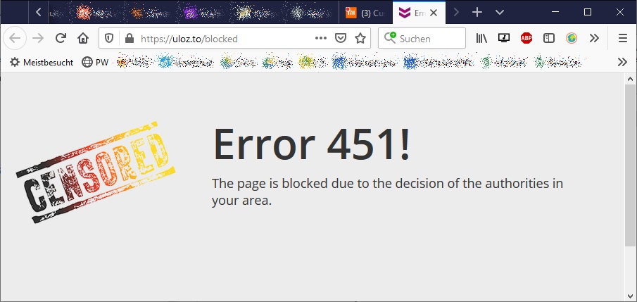

I get only an error 451.
What can I do to download the file?
Edit: Perhaps it's blocked only in Germany? Can anyone upload the file at another place and give me the link?

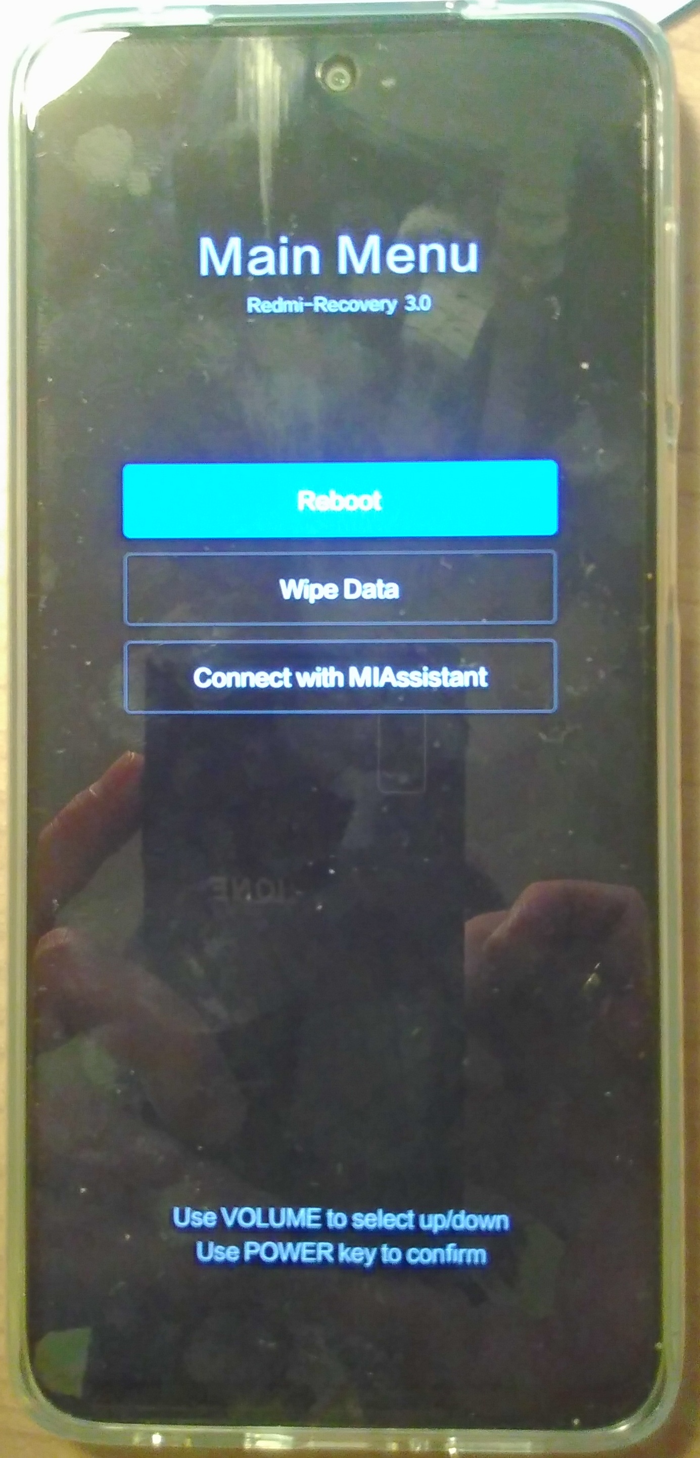

Edit: I have now tried three times to perform all steps of the first post exactly (with autoinstall.exe). Once I was also in TWRP, but after the reboot it did not work anymore. After the second and third attempts I can't even get into TWRP anymore. I always get the "Main Menu" (from XIAOMI?) when I start the phone with Power and Vol+.

What I see on your picture is not TWRP, it's original recovery.
Twrp looks like this picture..
Yes but after installing with autoinstall I got this... no TWRP!
I think my mistake was that I booted to the system once in a while.

you must not boot to system! At every boot you have to press power and Vol+ buttons to start to twrp.
