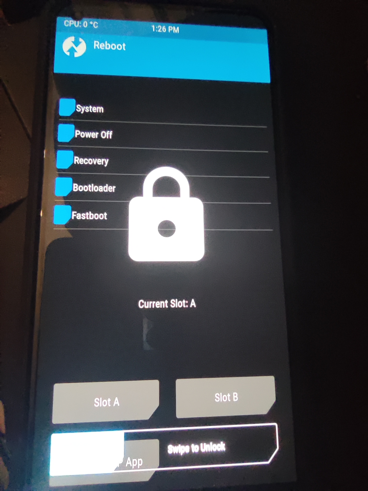

The weird thing after flashing latest recovery rom is that warning that No OS installed ( although after reboot phone turned on ) and the slot A and slot B as you can see at screenshot ..

I think that's the new way of partitioning the android system. Haven't searched much tho.
This and this may help.
Once upon a time with mi 3 ( cancro ) , there is also a kind of partitioning system and device can boot with two different systems , anyway i never try it ..
I didn't try to change slot also now but still we need explanation from nebrassy about this and if it works ..
