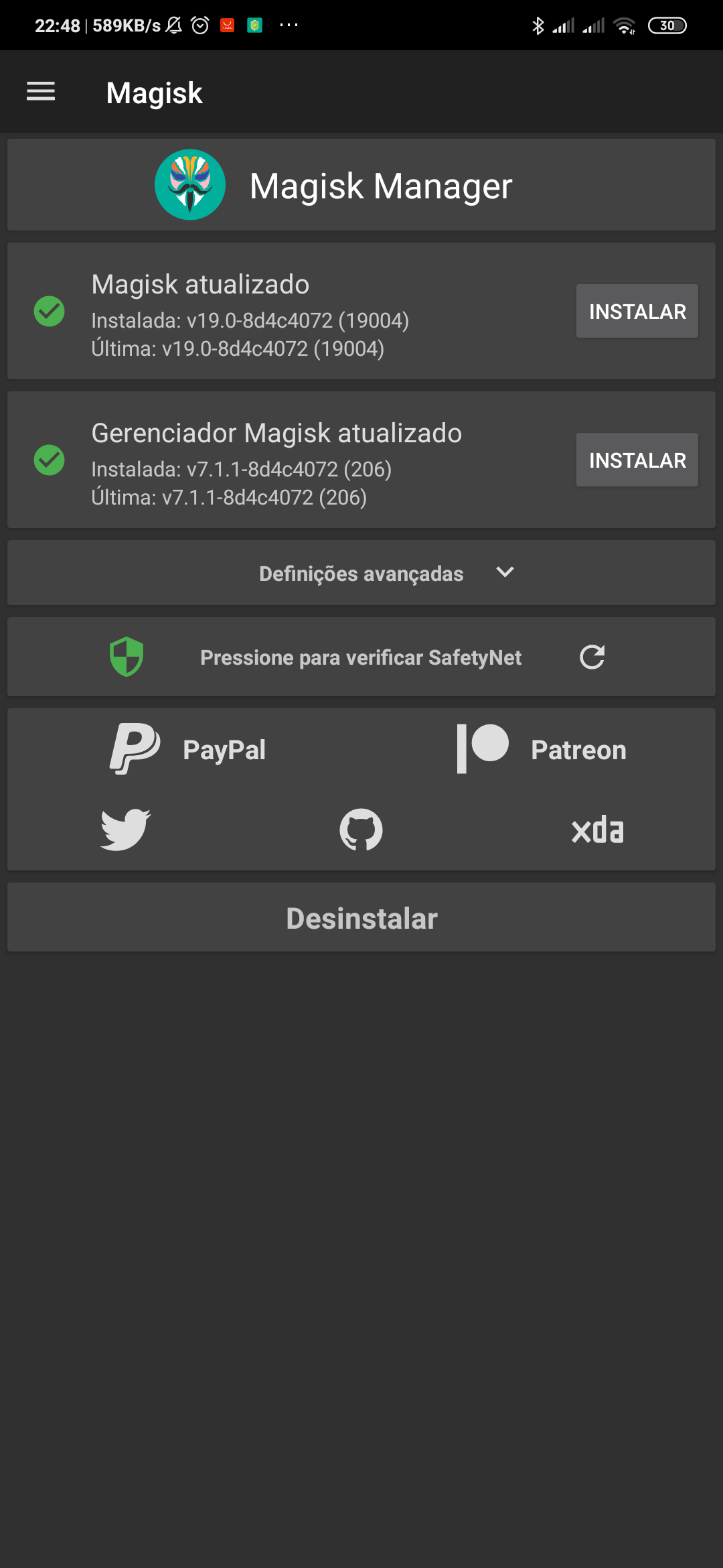

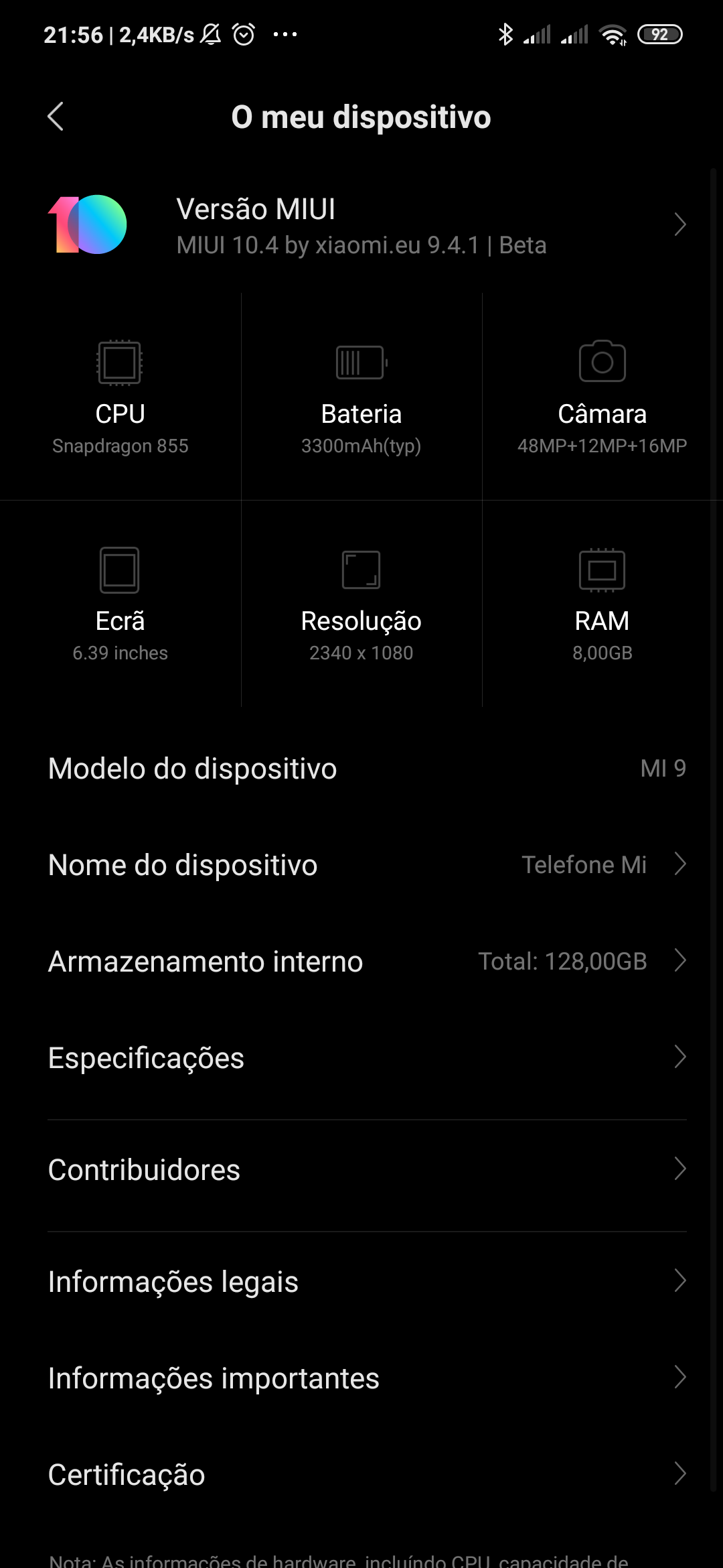

Its easy.
Unlock bootloader
Install twrp via adb
Boot twrp
Flash data(you need this step because you will got encrypted internal memory)
Reboot twrp
Past to internal memory xiaomi.eu rom (with mi9 in twrp and usb pluged)
Twrp > install > rom
Clear cache and dalvik
Reboot system
Configurate everything
Install magisk manager apk and download last zip
Reboot to twrp
Install magisk zip file
Reboot system
And its done custom rom and rooted.
*very importante notes*
If you feel battery draining install rom again
Everytime you update rom, install rom >Clear cache and dalvik >Reboot system and then Reboot to twrp and root again...
You may got bootloop if you install rom and root at the sametime without Reboot between installations.
For me works.

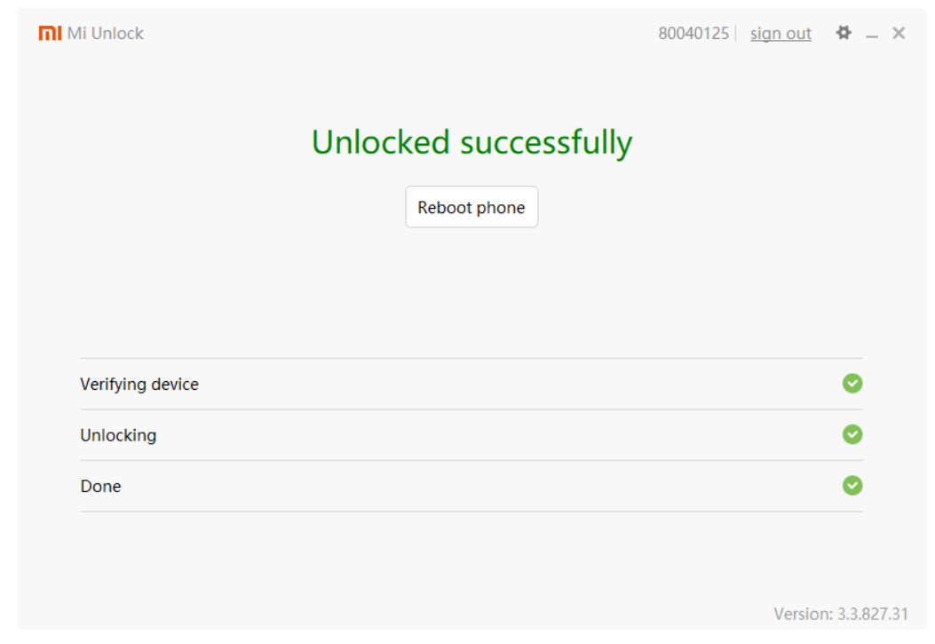

I just ask for the unlock for the boatlooder, Mi unlock gives me 360 hours to wait !!!
Piouuuu....just wait !!
