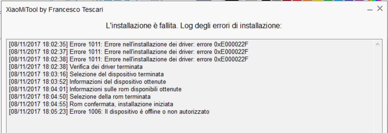

Hi all, I unlocked the bootloader on this device and I installed the global dev with xiaoMI tool without problem, but now I want put the xiaomi.eu dev I try to install TWRP with the tool but the installation give me this error:View attachment 17328![]()
what's wrong?
what's wrong?
Thank you guys, sorry @AleBerlo but I hasn't the TWRP on the devices and so I use the manual process like the hint of @NeoMod.Use official latest TWRP (works perfectly) and use the classic ADB/Fastboot command sequence to push recovery to the phone and then install it.
Takes no more than 5 minutes, I believe no more than 4 steps are required. And everything is described clearly on TWRP page.
I see it works on Android 6.0. With Android 7.0 the same?
Caution! The TWRP you have reported is for Mi Mix 2 (Chiron), not for Mi Note 2 (Scorpio)! Here's the one right for Scorpio: https://www.needrom.com/download/twrp-3-1-1-scorpio/I didn't login here but is this the file you are looking for:
