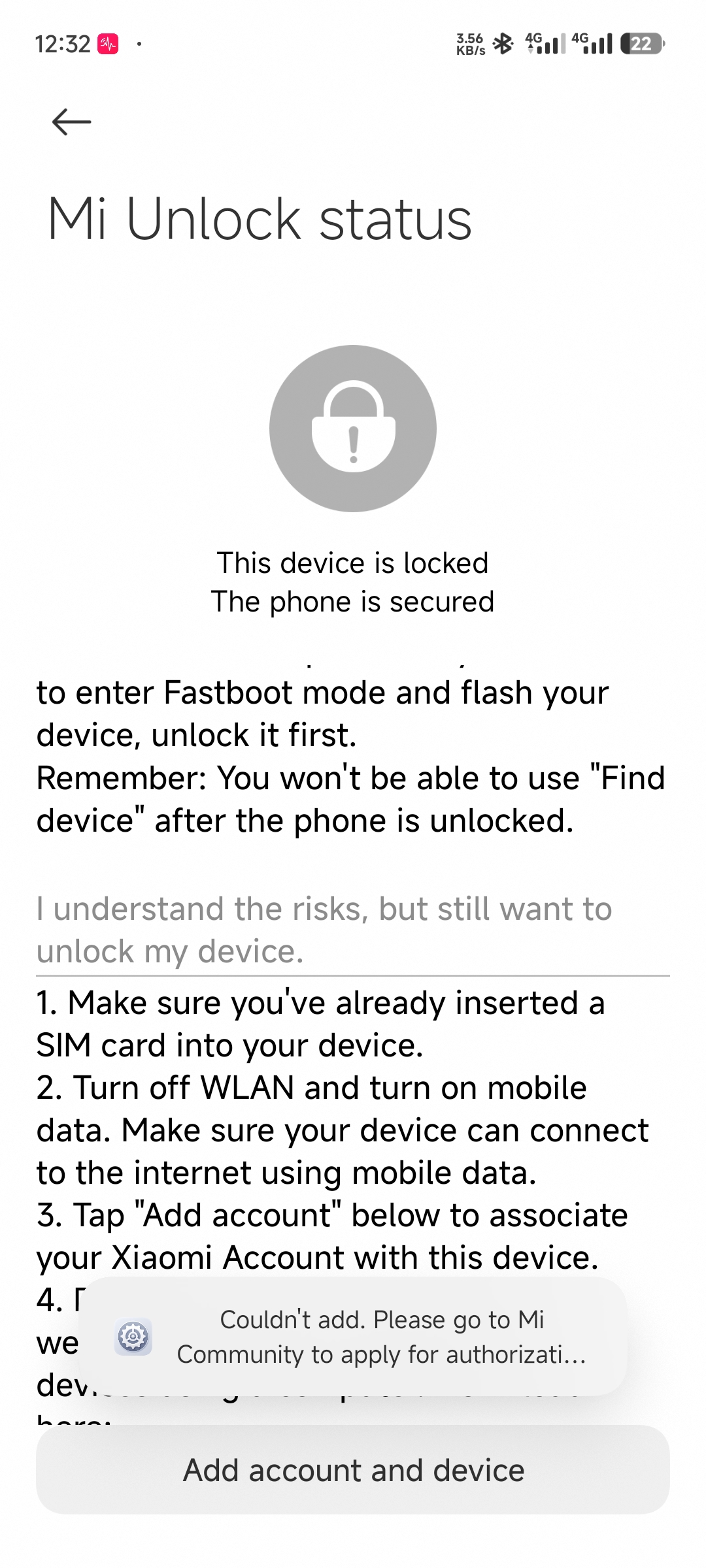

But I still cannot "Add account and device" in Developer Options / Mi Unlock status - they tell me I should try via Community app, but the latter now says I have been granted the unlock until 2025.
I'll try the unlock tool directly, but the Community app told me I should wait 72h before that.
Same here with 14 pro. At 6pm GMT+1 I set up a reminder and I got instantly access granted until 2025. Can't bind the phone in the BL menue at developer settings.

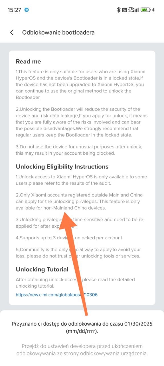

I think this procedure only works under the following conditions:
> Mi Account established outside of China
> Global device only !
It is also stated in the application.
Reactions: newgolfer and Panas

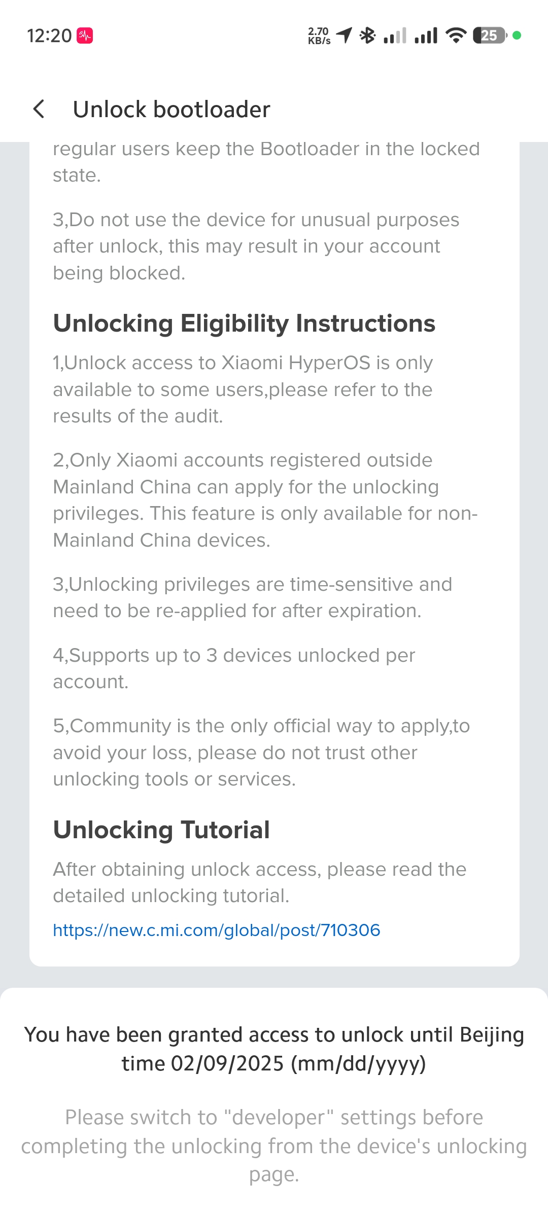

There aren't global 14 Pro devices. Translated in other languages it might say that only devices outside of China can be unlocked, not global devices. Otherwise it would already say the device isn't eligible.
You can't unlock Chinese devices versions with Global Xiaomi Community permissions. Already tried to do it with one Xiaomi 14, we had 72h of waiting, and then next day prompt "Couldn't unlock. Please go to Mi Community to apply for authorization and try again".
China devices = China Xiaomi Community, Global devices = Global Xiaomi Community.
Only Xiaomi accounts registered outside Mainland China can apply for the unlocking privileges. This feature is only available for non-Mainland China devices.
So, if i buy a device in mainland China (so it's Chinese version, not Global), but bring it and use it in Europe - can i unlock it or not?
No. A Chinese device is still a Chinese device no matter where it is located. A Chinese device with HyperOS cannot be unlocked with a global account.

So why did the Community App pretend to unlock it?

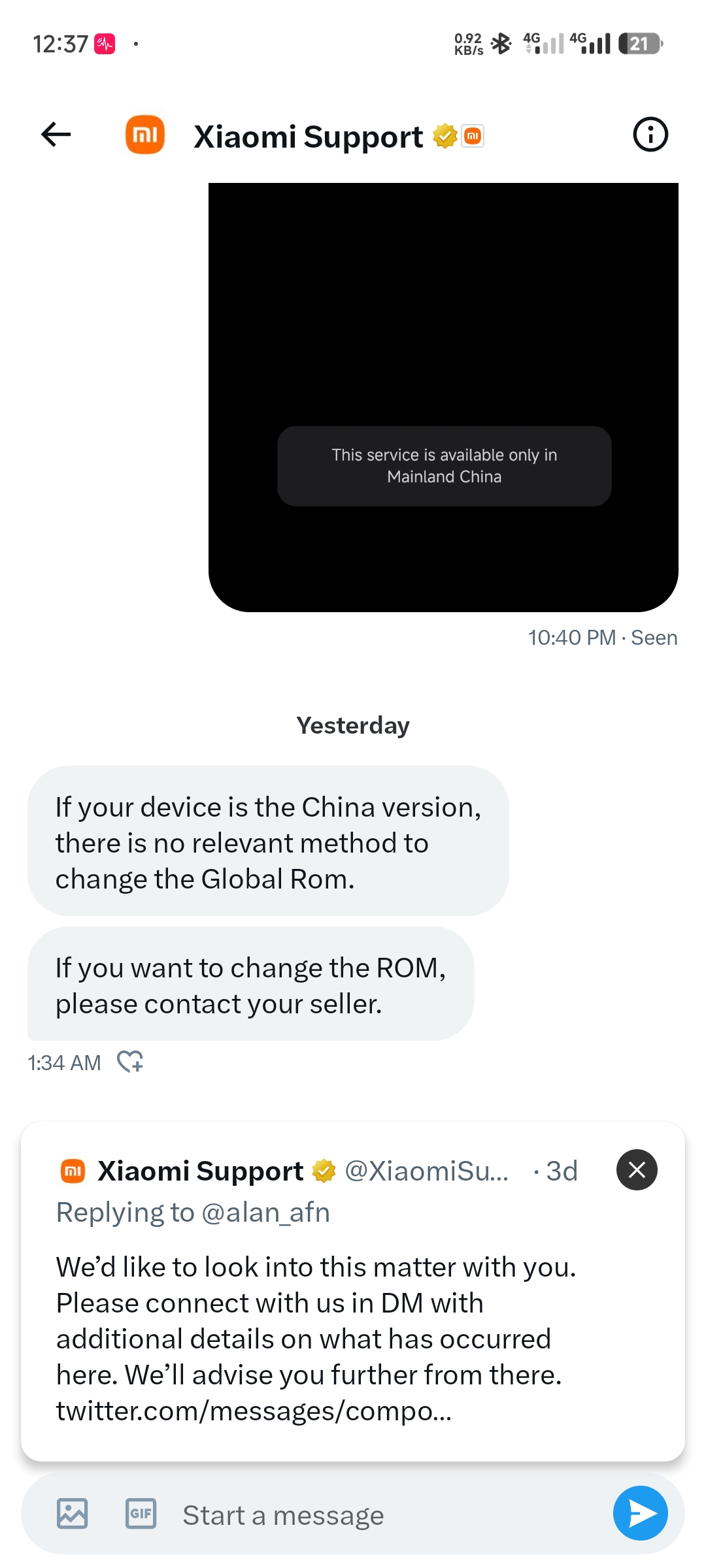

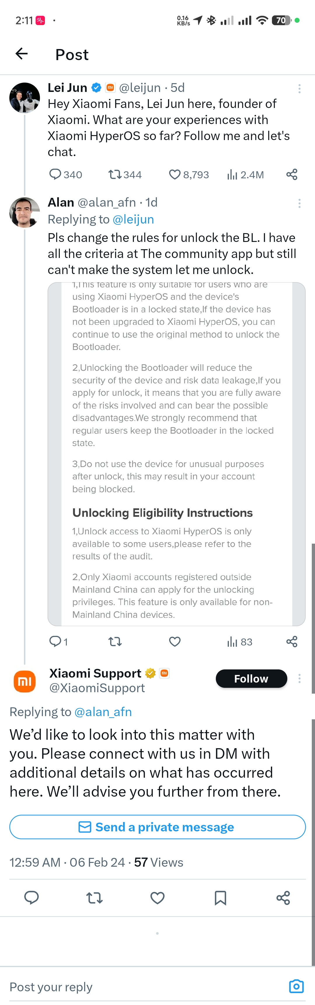

I already got permission granted at micommunity app but unfortunately won't let me unlock the phone. I asked at Xiaomi directly in X and they told me ask to your vendor not our problem.

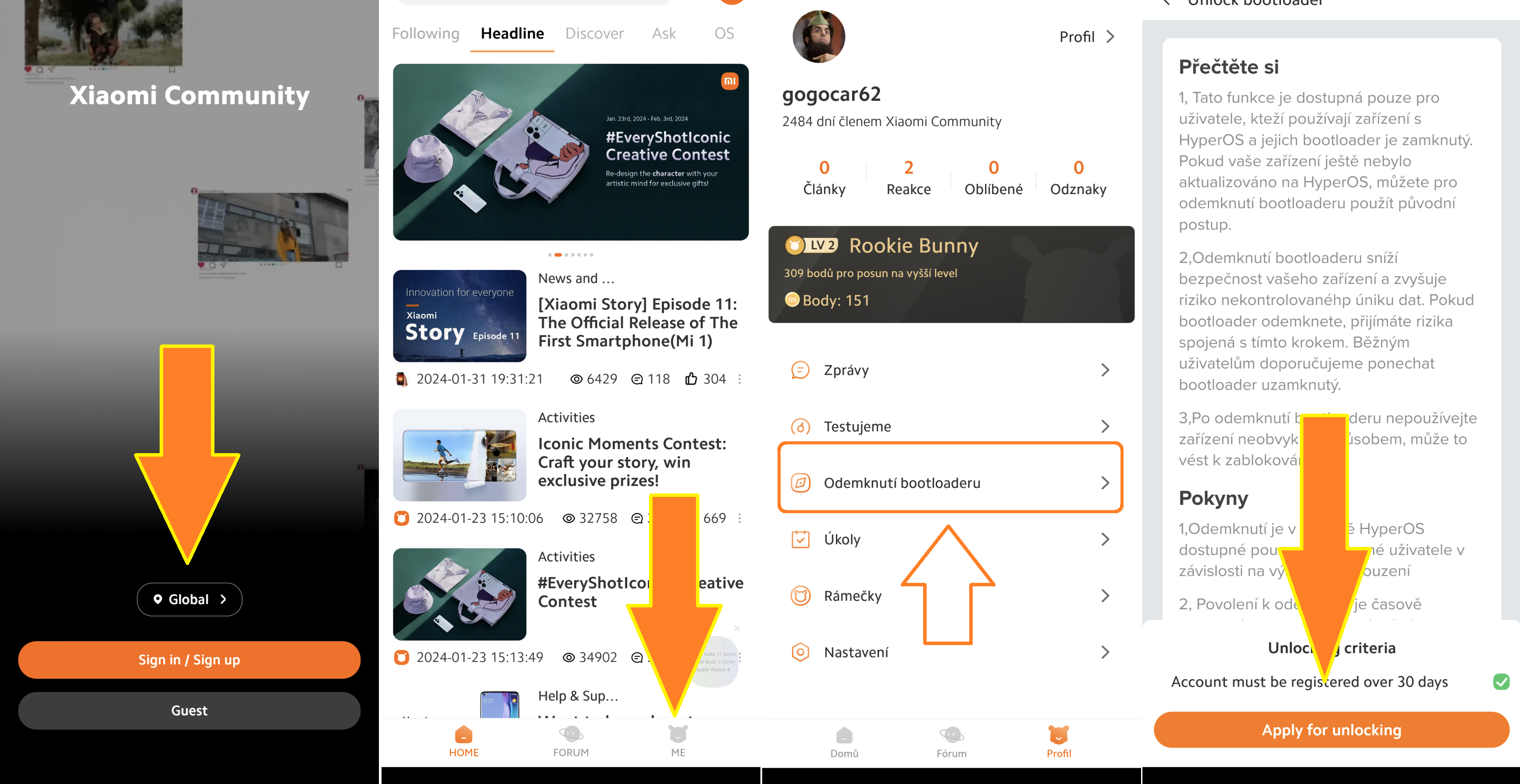

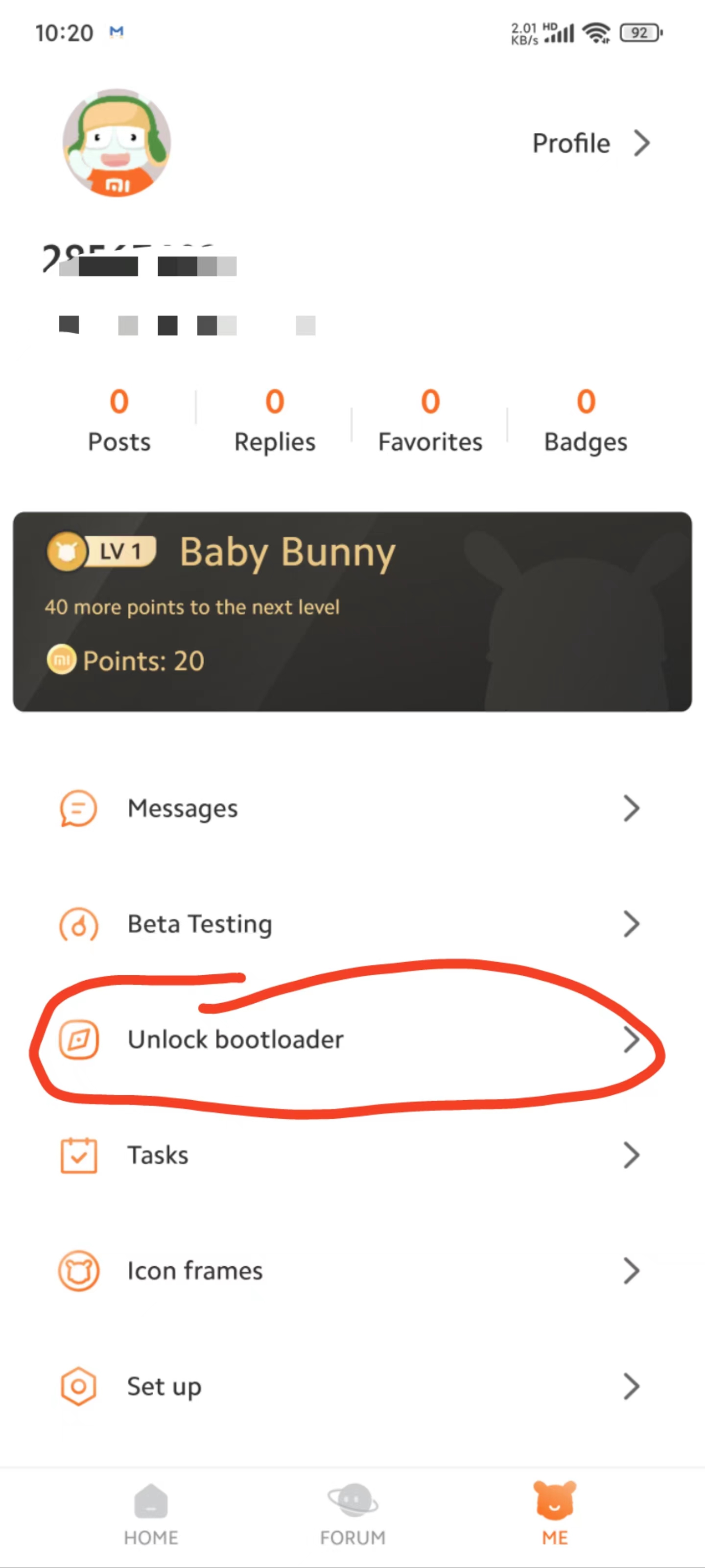

HI,
what to do if the unlock bootloader option is not visible in the app?
It's a European phone with a European account.
You are probably using an old version of the Mi community app from GPlay.
You also need to set the region to "Global" in the app.
Xiaomi Community 5.3.31
