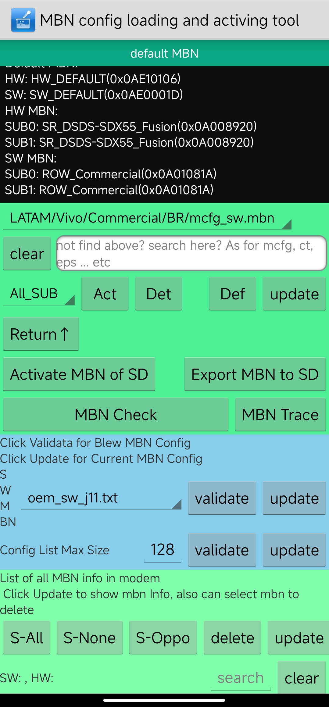

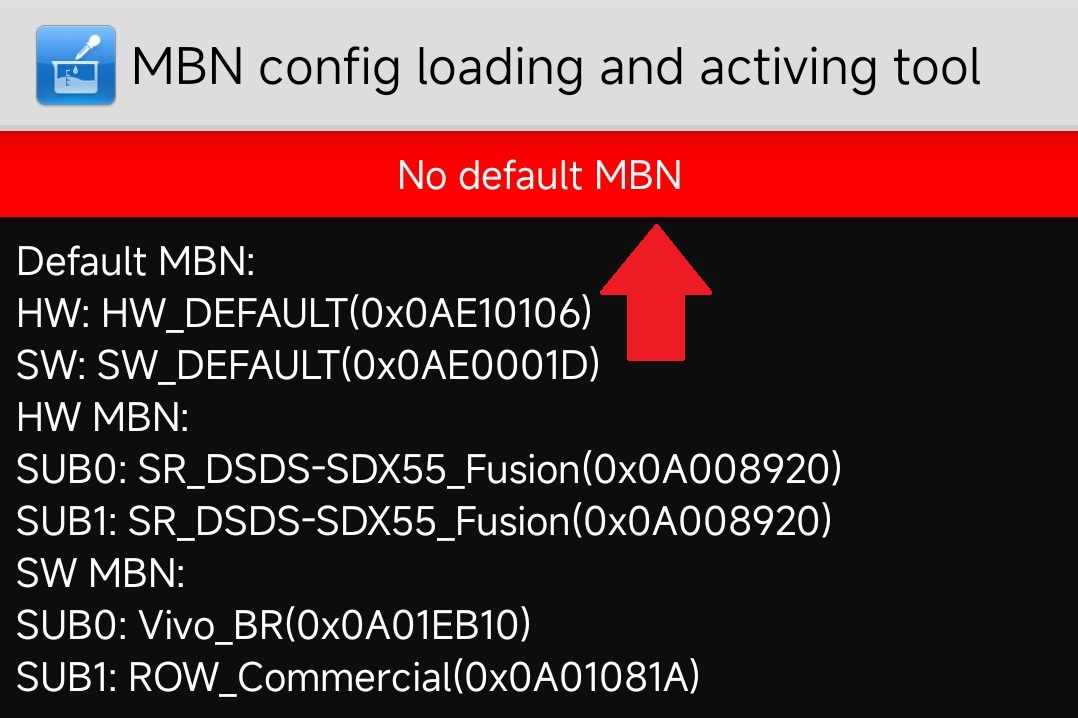

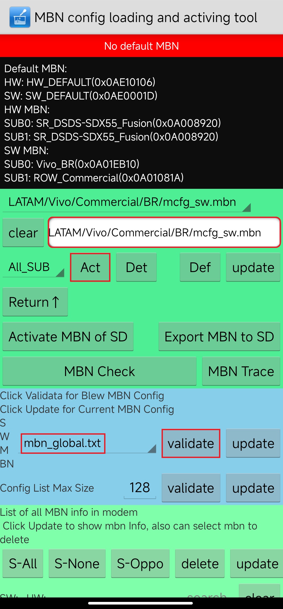

I running Beta Weekly on Poco F3 with Carrier (Vivo - Brazil - LATAM) that already support VoLTE and VoWiFi (both enabled my device Settings).
1) My default MBN settings before any change was:
2) Then I select mbn_global.txt from SW MBN list (validade), LATAM/Vivo/Commercial/BR/mcfg_sw.mbn (Act) and reboot my device.
But VoLTE and VoWiFi still doesn't work and MBN config loading and activing tool has the red NO DEFAULT MBN on top screen.
I double checked with my carrier and both services are provisioned in my number even doesn't work with Poco F3.
How can we handle it? Thanks in advance for your inputs.
Let me know if you need more information.
Regards,

It's a "Commercial" MBN for Vivo BR, not a VoLTE-supported one most likely. If there isn't a VoLTE MBN for Vivo BR specifically, try a generic one.
The red "NO DEFAULT MBN" text on top screen is normal, it says that you manually selected a SW MBN, instead of letting it being set automatically.
