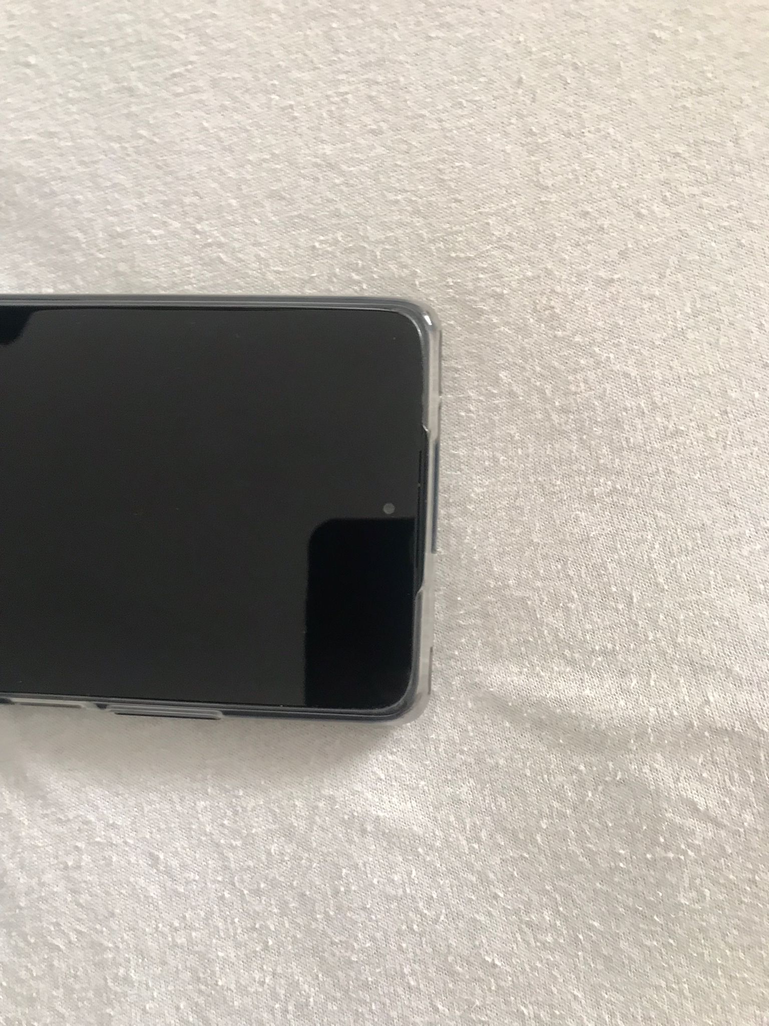

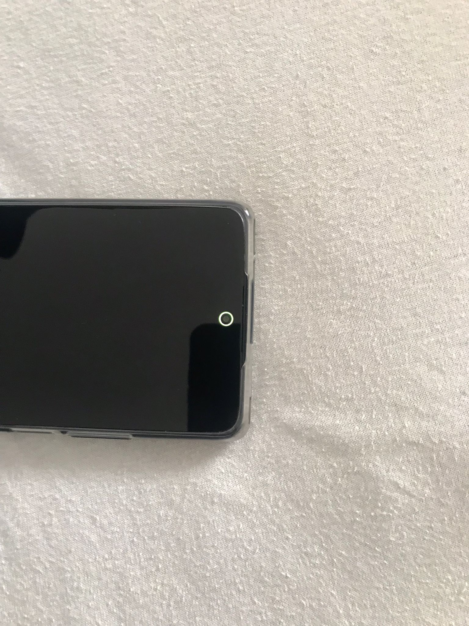

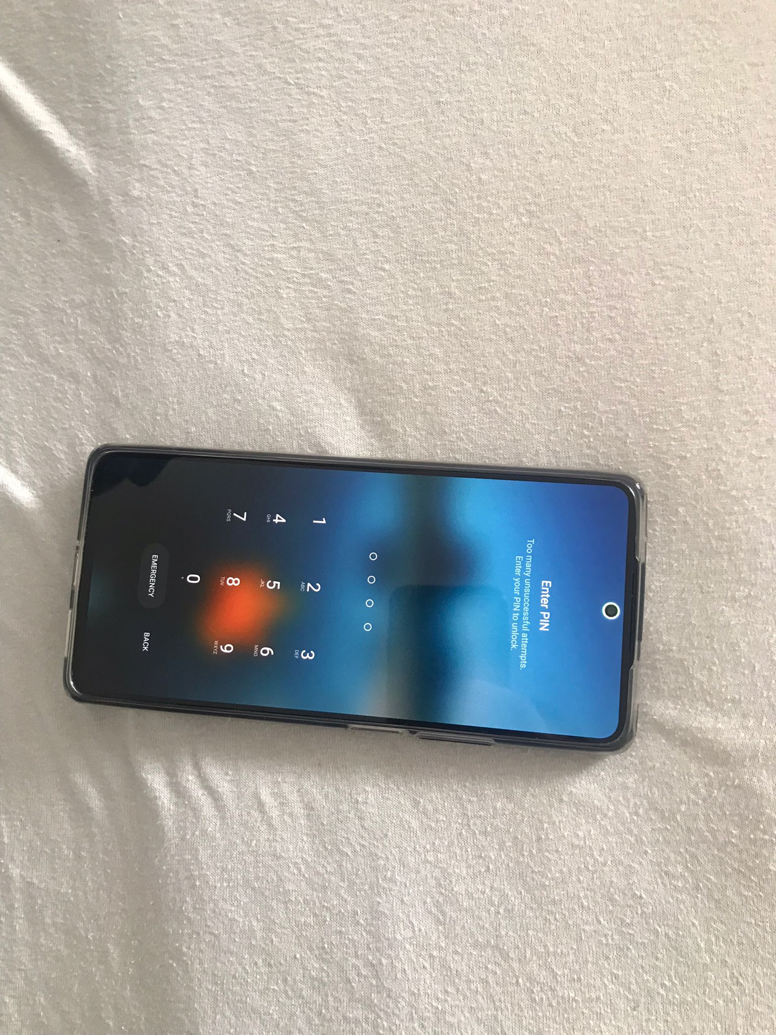

I have the 11T for a few month's everything was fine in the beginning, but now all of a sudden when the phone active there is a annoying green light ring around the selfie camera which is always on.
I cannot find any setting that controls this?
Is this a know issue, are there more people that have the same thing?

Not sure, i did a factory reset, didn't help, face recognition is not enabled, dark/light theme switch doesn't in fix it.. it almost looks like a broken screen of damaged oleds, strange because I happend after and update, it went really fast.. one second in it was good the next this ring showed up and stayed forever.

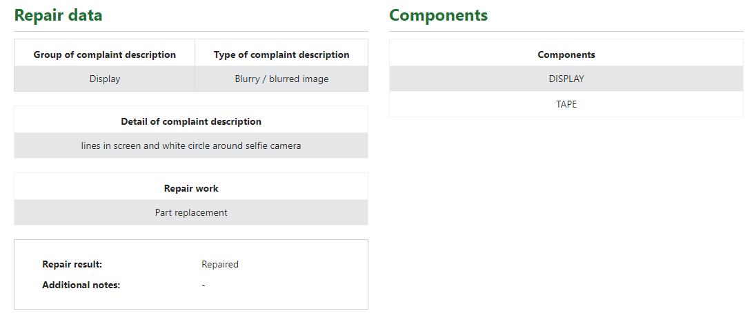

Have it picked up for repair by Xiaomi so let see and find out what the outcome will be, seems to be a hardware issue that's for sure.

I tried almost everything, and the repair-shop also confirmed to me today it was a faulty display and was replaced under warranty.

Maybe share some pictures of your issue?, most people I spoke about it said it looked like some kind of way to show you the selfie cam was on, but that wasn't it.
Also I tried those notification app's, but they just drew a circle around the white ring, so clearly something wasn't right with the screen itself.
if I increased the brightness to 100% I could see a blurred straight line starting from the middle top selfie cam of the screen, towards the bottom.
For me the fix was to have it repaired (changed display) check if you still have warranty and send it back.
