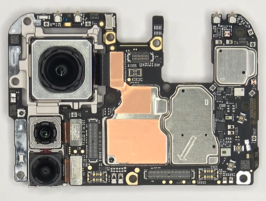

Update: just made a DIY EDL cable and tried it. No reaction at all...
Either I'm too stupid, or too blind.
Searched 9 pages. As long I understand, I have to shorten 2 testpoints at the Mainboard, right?
Now the 12 pro has a different Mainboard than the 12. For 12 pro I know the testpoints (your photo at XDA)
. For the 12 I didn't find them...

Oh, I thought you have 12 pro. At xiaomiui.net they have gathered of all xiaomi the test points, but still not from 12. Haven't found elsewhere other info. At me, I found them myself. So you must search and test, as I did.

A photo of the board I have. I think it shouild be the 2 points between the connectors on the left...
You must find someone who can open your mobile, a technician, and try test points. If you check previous models, you will see that the points are close one to other.
I can open it by myself. But how to try testpoints? Simply shortcut them? Is there a signal? Got Multimeter and even a Keysight MSOX2014A with digital analyzer. Real overkill for home workshop. But normally I don´t work with phones but with oldstyle electronics and 3D Printers.
I'm doctor, no technician. A technician just pointed me the possible places and I told him what to test, with my responsibility if something happens
