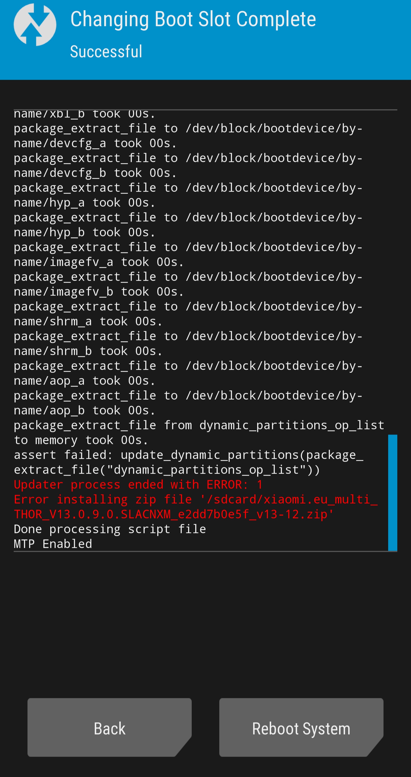

Trying to update euROM to the latest one but I have an issue installing the package. I downloaded the package and chose slot A for reboot but the same error occurs as shown in the attached. Please let me know if anyone know how to fix. the device has been rooted with magisk btw.
try this ....

try this ....
Within TWRP:
# Wipe - Advanced Wipe - Data - Repair File system
# reboot
# flash again
or try this:

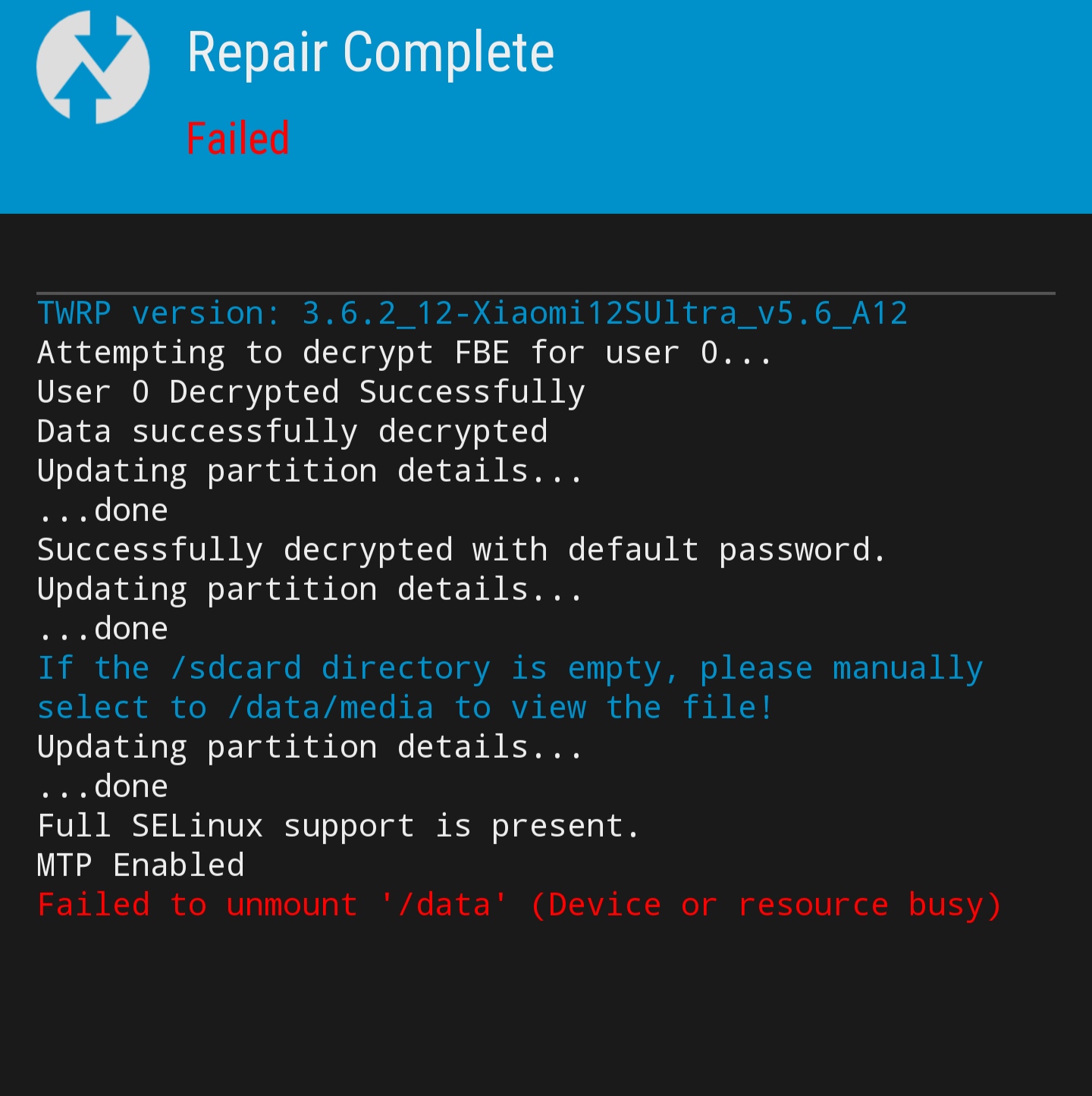

Thanks for the tip! I've just tried both but didn't work.. the attached is the error I got when I tried to wipe for repair file system. I'll re-download the package via Updater on Setting and see how it goes.
Also Updater app works really slow, like it needs 5 secs to proceed to next step everytime I tap the button (e.g. download / install) for update and it crushed multiple times during downloading. I don't know if it's related to the issue I'm having rn tho.
try to use another twrp there are newer ones for "thor" MI12S Ultra
I've just fixed the issue.
[TWRP]
1. Reboot - Recovery
2. Install - Select zip and flash
3. Reboot
For Magisk, I re-installed via TWRP after the update and all the settings/modules were restored without problem.
[TWRP]
3. Reboot

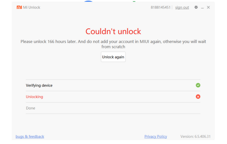

HEY! a have another problem try to unlock the phone and got this message what should i do? what it mean " do not add your account in MIUI again,"
Do not do anything with the MI account on the phone (do not log in or log out). After 166 hours, unlock the bootloader.
