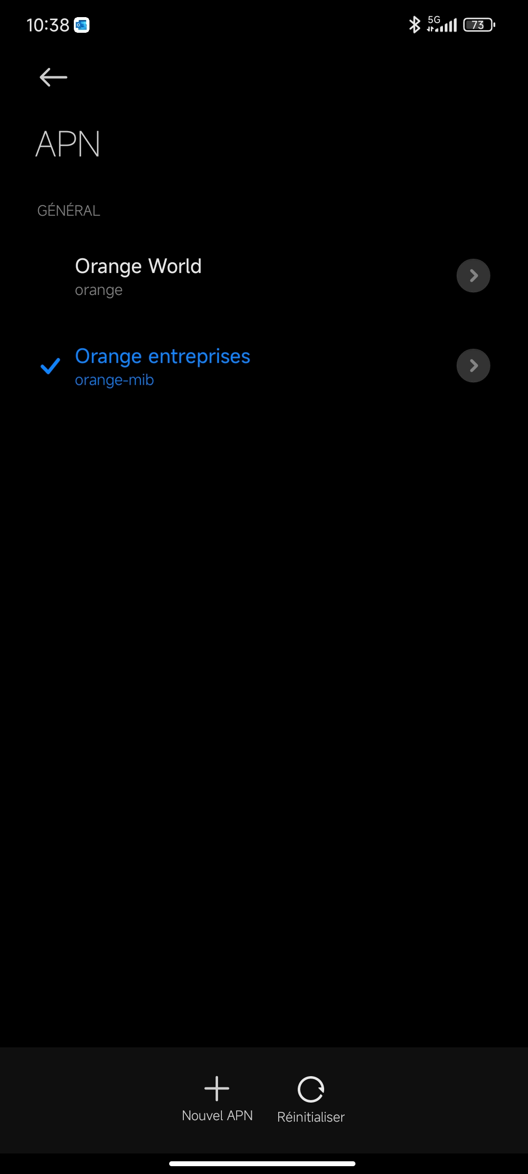

but internet, whether brave or chrome tonight with all the bars in 5g it does not open anything. Unable to view anything. and all of a sudden I can do the consultation.
I have the same issue with the Deliveroo app.
I tried to force 4g, it's a little better, but not great either.
Edit
PLAYSTORE & voice dictation in 5g or 4g is ko
it works on wifi
i change "apn" and actualy it's ok

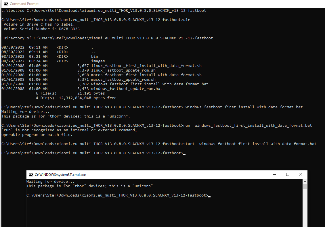

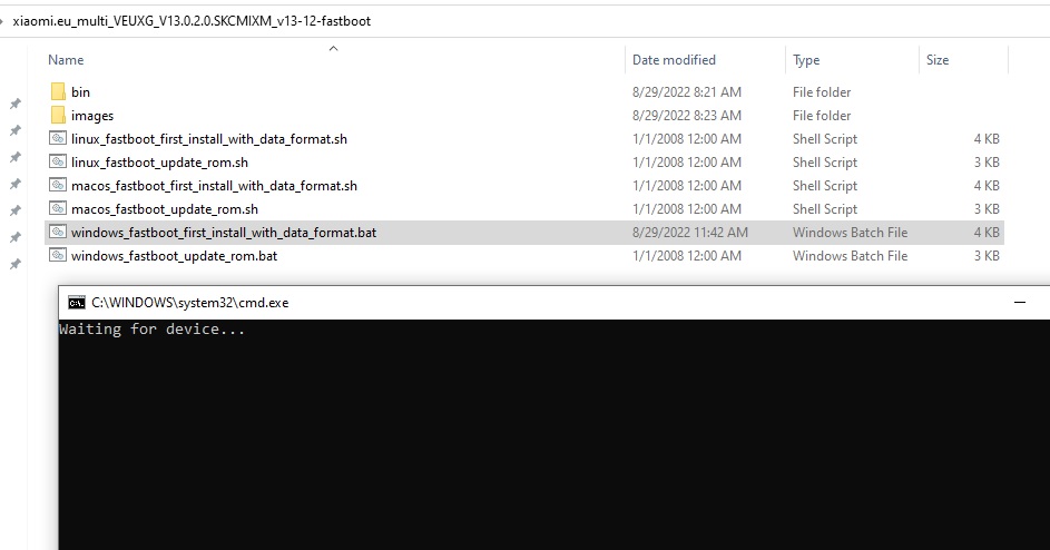

Hi everyone,
I am facing a very weird issue. When I double click on the "windows_fastboot_first_install_with_data_format.bat" I am receiving the normal message Waiting for device... Now the problem is when I set my device to FASTBOOT and connect via the original Xiaomi USB cable the.bat immediately disappeared.
Has anyone faced a similar issue?

Hi everyone,
look here…
dont double click and post the logoutput here
