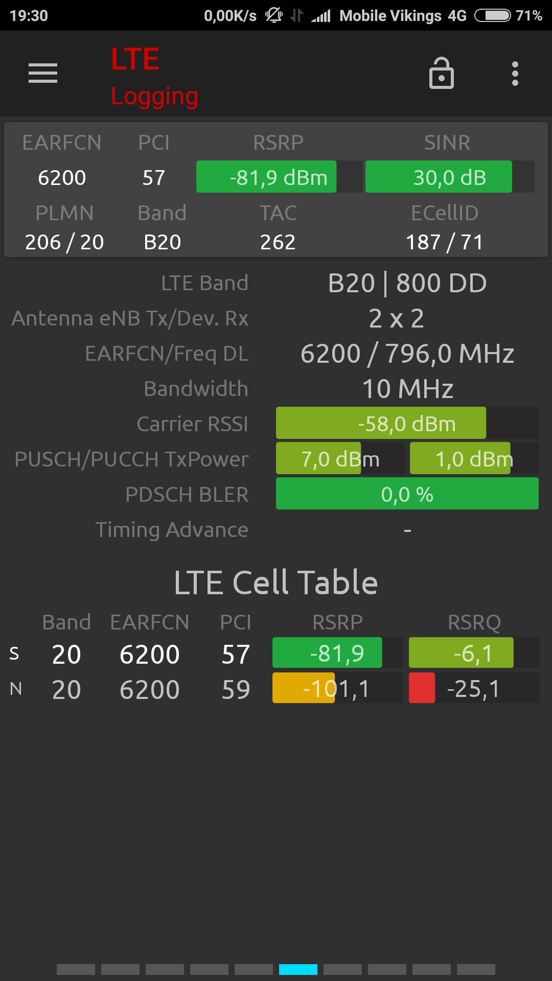

I will test it as soon as possible, root it and check the B20 is correct
No problem.
will wait patiently ;)
Unfortunately you have to wait untill tomorrow when I go to work.
I live in B3 area and when I go to the highway my Kate device connected to B20 so I am going to test it tomorrow morning when I leave to work and when I get to home.
Sorry for the extra wait. :(
Excellent, thank u for testing dogiex.
What app do you use for confirming band 20?
Also i'm going to order a Redmi 4a and will test band20 after i flashed the eu rom.

App is Network Signal Guru. Need root access of course.

@dogiex: I have received my new phone, unlocked and installed Xiaomi weekly ROM. When I launch Network Signal Guru, I can go into it's options menu, select Band Locking, then LTE. This screen shows a number of LTE bands, all checkboxes ticked, including one that says "B20: 800 DD". Now I don't fully understand the Network Signal Guru app just yet. Can you tell me, does this confirm my phone now supports Band 20?
If it shows that your phone is using B20 band, then it supports it. Take a look at the picture above on my previous post. I had to go to a highway to get out of B3 band so that it will connect to B20 band.

Finally, time to update!
Redmi 4a 2gb/32gb global, band 20 confirmed.
Xiaomi.eu 7.4.20 ROM
