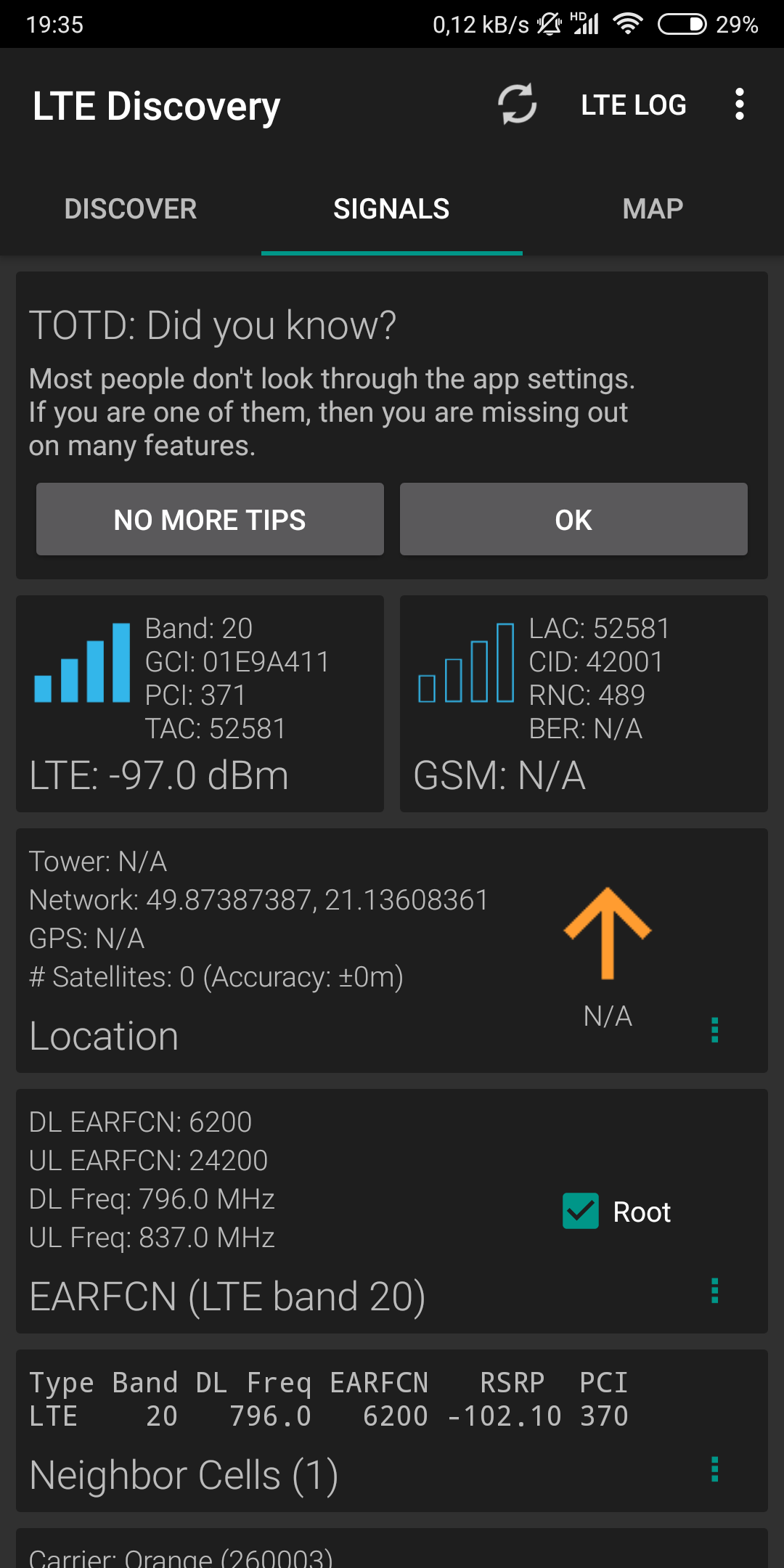

Mi MIX 2S, both Chinese and Global models support B20, I'm attaching a screenshot from my Chinese model.
Reactions: wamy007 and dogiex
