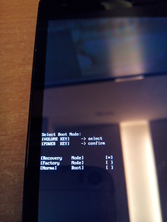

Hi Guys!
I have a Xiaomi Red Rice with me. I think it's a fake/copy as I wasn't able to flash CWM Recovery using MobileUncle tool.
I was actually trying to make Google Play work. I tried many solutions present here as well as on my own but, no success. And I finally ended up in semi-bricking the device when I tried to copy paste Original Xiaomi Hongmi ROM files in my device's system folder using Root Explorer. Now, my phone is stuck at MI boot logo.
So, is there any chance to bring back my device? Any help is appreciated.

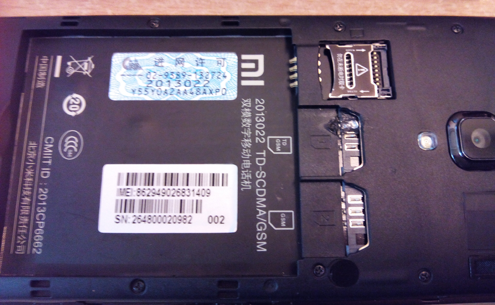

The Serial & IMEI numbers do not match with the box. I just want to install any stable ROM with Google Play Store.

Hello... anybody there? We need Stock Firmware that can be flashed either via Stock Recovery or other update tool
Hi ,
I have brought the hongmi just a day back. The phone has the same problem. when i update from sd card it shows error : partition not match.
I used mobile uncle tools and found that my processor is 6587 instead of 6589. Just wandering is it an older hardware of hongmi?
I cant use it for update to 4.2.2 .

Its not an older firmware - its just a fake, thats all.

Hi!
I also have fake Hongmi... and good news for you:
Here uploaded system image:
https://mega.co.nz/#!8BZS3CpZ!BopHxwdxfVVLbNuvMUrVQU6gMn8G_w1sQUfxnH1jiyw
How to flash it:
- Turn off the phone. Press the power button and volume up.
- You can see 4 options:
[Recovery Boot]
[Fastboot Boot]
[Normal Boot]
[Normal Boot +ftrace]
- Choose fastboot
- Download "fastboot" tool to your computer
http://forum.xda-developers.com/showthread.php?t=2277112
- In command mode type:
fastboot flash recovery system.img
- On the phone screen will see instalation progress
- At the end reboot phone
So many people with fake Red Rices how is it possible???
It would be extremely important to inform where you bought them from so that other won't fall for it to. Can you do that guys?
Reactions: matze
I bought in www.aliexpress.com
Seller claimed that sells original Xiaomi. And at first glance it really looks like that. In Android "About phone" menu is the correct model and parameters. The system is original MIUI, copied from Chinese TD-CDMA version with added English language.
But when you install any software to check the hardware (eg CPU-Z) you find out that many of the parameters does not match, eg CPU, GPU, resolution ...
