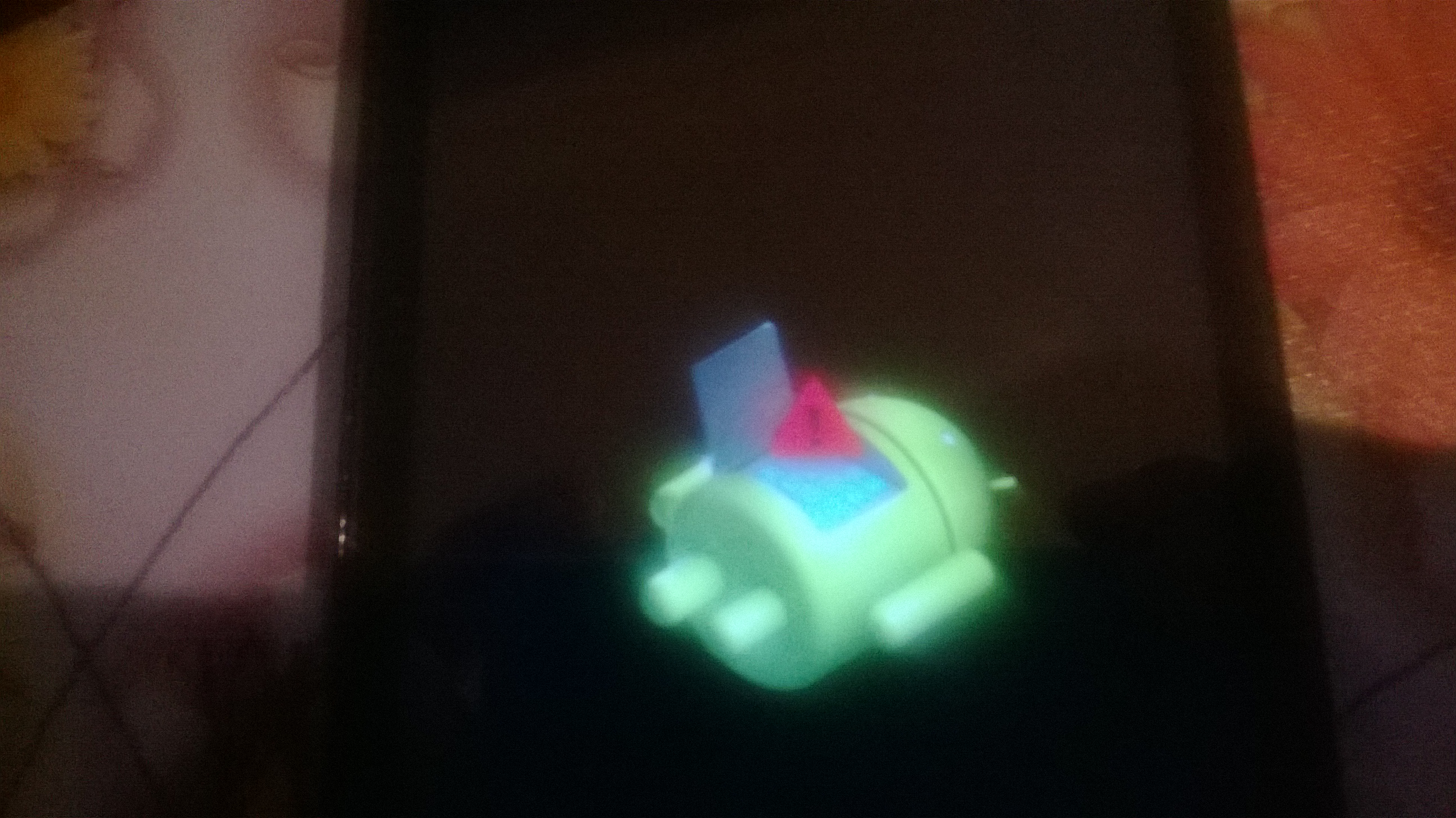

I followed instructions to root in and update ROM v5.0 and failed.
i see a dead andriod as attached on picture. PLEASE HELP!!!!
