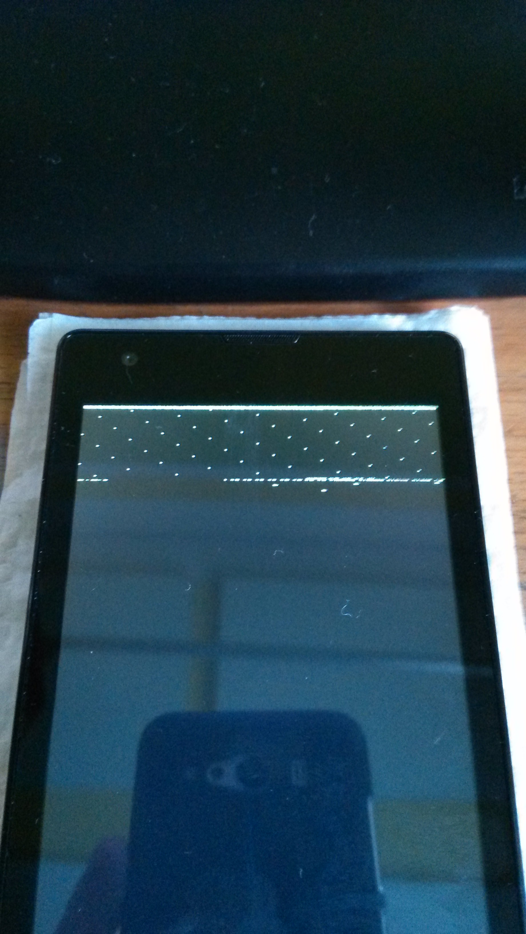

everytime if i try this way or if i try to push the cwm recovery with SP Flash Tool on the Device it ends with pixel failures and an automatic reboot back to the ROM.
once you have tried to install CWM via MobileUncle and vroot its also impossible to flash back the stock recovery.
if you start the recovery it will look like this :
Solution : take TWRP Recovery ..that works.

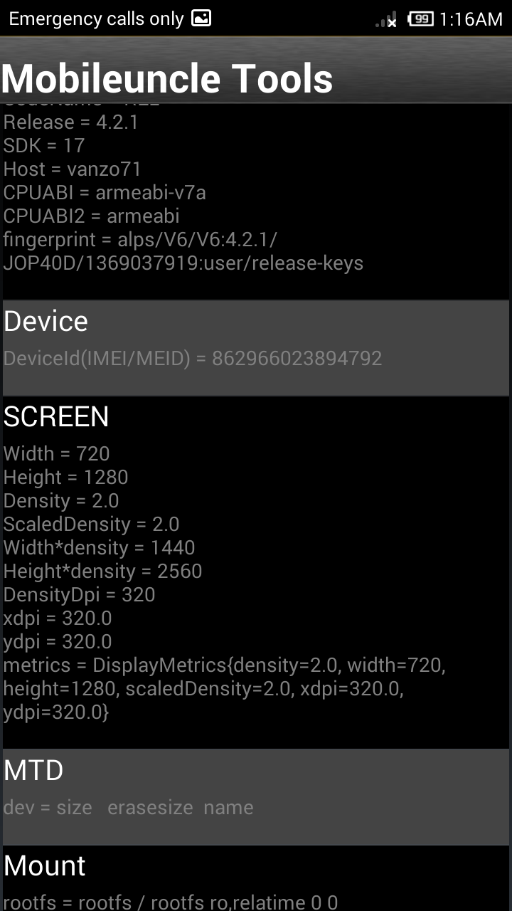

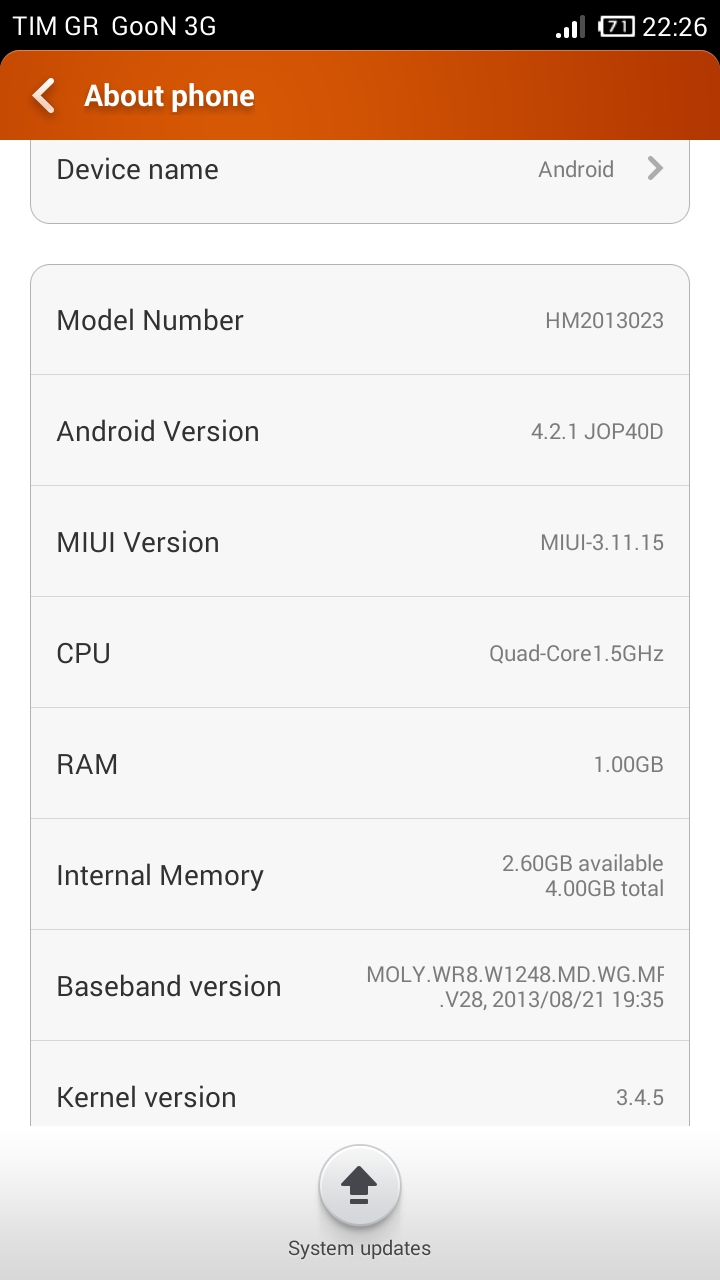

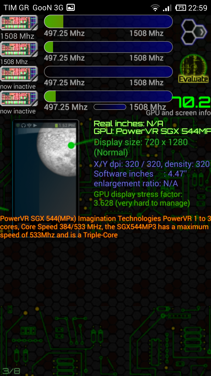

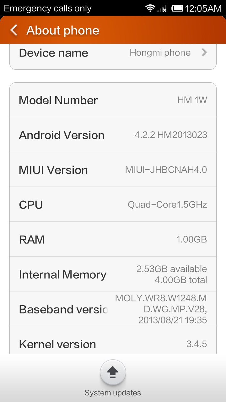

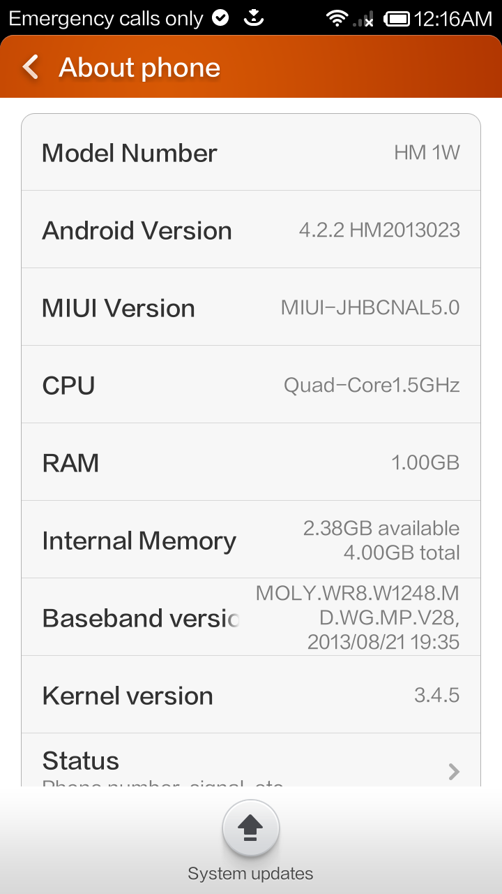

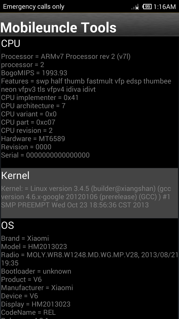

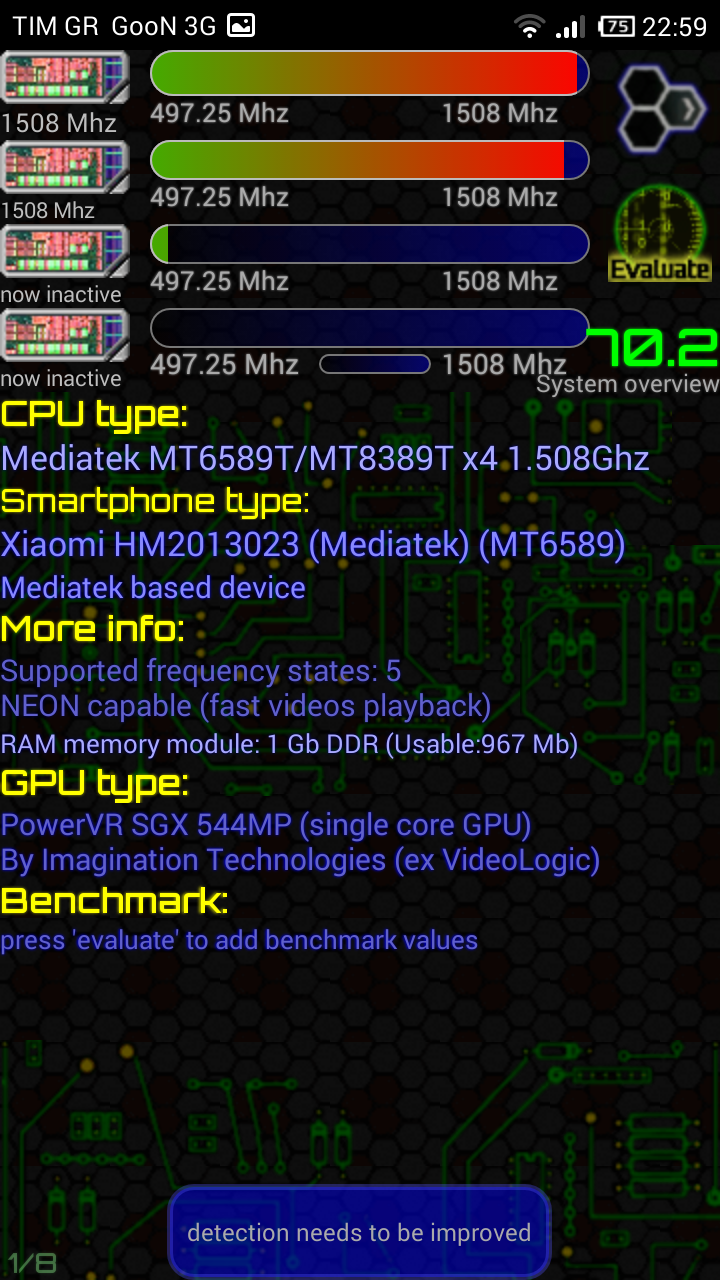

Please post some screenshots from MobileUncle tools -> Device Info

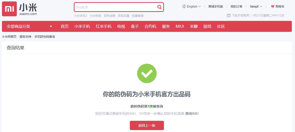

IMEI and S/N on phone on screen and box is the same
Also the scratch sticker verified as original on http://chaxun.xiaomi.com (photo no5)

Ok, no fake. But your Android version is strange: 4.2.1, HongMi is on 4.2.2.
Looks like you have a ported Developer ROM from another device installed.
Did you install this or was it installed when you bought it?
Check this thread carefully
http://xiaomi.eu/community/index.php?posts/192412

Success !!!! With the SP flash tool. First to ver 4 and after this OTA to ver 5.
