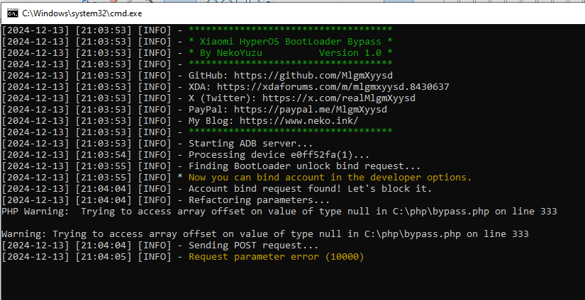

Hello, I have podo f6 pro and it won't let me, Now you can bind account in the developer options.
[2024-09-25] [16:55:31] [INFO] - Account bind request found! Let's block it.
[2024-09-25] [16:55:31] [INFO] - Refactoring parameters... PHP Warning: Trying to access array offset on value of type null in C:\php\bypass.php on line 333 Warning: Trying to access array offset on value of type null in C:\php\bypass.php on line 333 [2024-09-25] [16:55:31] [INFO] - Sending POST request... [2024-09 -25] [16:55:32] [INFO] - Request parameter error (10000) I have hyperos 1.0.6.0 andrid 14 anyone with the same problem??

  • Update: override install Settings if error 10000 (from marble V816.0.5.0.UMRINXM, you can uninstall override after binding)"
i dont know if its still possible to directly install the apk though, either try to install the settings.apk on phone or via adb install settings.apk on a PC

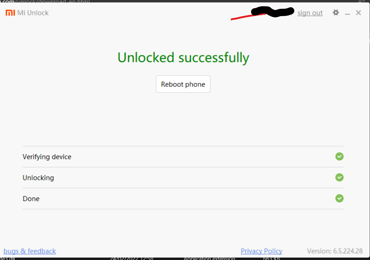

thank you guys. finally I can install Custom roms on my F3. Was tired with ads on stock hyperOS and yet I had problem with unlocking via community app. worked like charm one time.

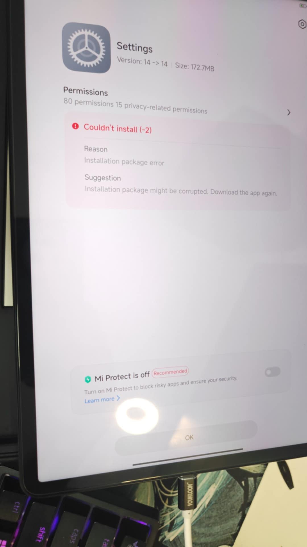

i can't install settings.apk.
pad 5 pro 12.4
help me, thanks
try this one, this was from the pad 6 and pad6 pro if i remember correct, i tried to extract it directly from the ROM but didnt really work.
Then i looked for pad 5 pro 12.4 specific settings.apk in the 123pan archive but seems like it redirects to the Pad 6/6 Pro.
the settings apk you need
Reactions: theanh235
it's not working with 5pro 12.4 Hyper Os 1.0.7.0.ULZCCNXM
Reactions: Mark F
平板6pro等.apk still not working :(

Hello, I'm trying to unlock it, but the error "request parameter error (10000)" always appears and on the cell phone it appears to wait a few minutes, do you know how to solve it?
I got the same constantly but I read that it no longer works on 14 series. I have been trying to unlock again as my long standing account was Chinese but since September, it's approval was only for Chinese models, not my EEA global. So I had to create a new non Chinese account and have been trying everyday to unlock I had several bans of 5 or 10 days but managed to unlock midnight sun/Mon china time. Still have to wait a further 72hours but I will flash EU ROM later this week.
My advice, keep trying, no way round it for 14 series by the looks of it.
