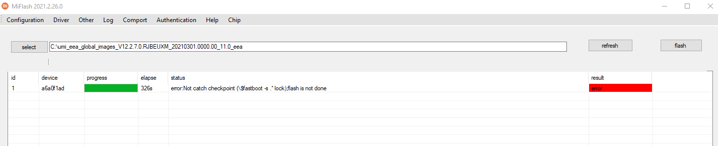

Perfect!!!!! SUCCESS. Using a different PC worked. I have ABSOLUTELY no idea how or why.. used exact same cable, exact same roms(transferred over from other pc) and exact same steps. It even errored out and worked anyway? Thank you SO much both of you for your help.
Here's the weird error but it worked anyway:View attachment 35963
Oh by the way, the error is normal! It does that for me too since the lock part is missing which would lock the bootloader again but since we don't want that, flash all is only needed.
If you at one point, plan to sell the phone, remove your Xiaomi account in your phone, and then do the flash all and lock process
